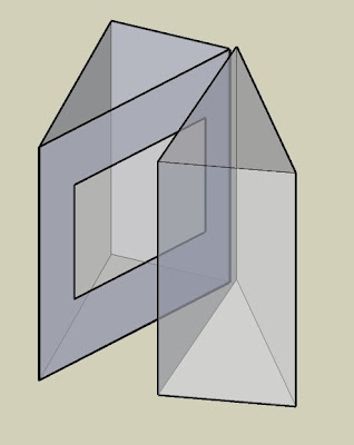

Yea, I still have some refelction in the image ( if there is a darker scene with some light patches in it, that gets reflected on the Left quarter of the image.
I haven't actually cleaned the lenses nor moved them since I put them up for testing :-/ (over 8 months ago now) hahaha, they are filthy with fingerprints & sawdust... I should get them down and do some adjustments, but I'm happy atm with the 2 prisms, and I'm sure I can adjust them better for less reflection (maybe a splitter/mask in between the 2 prisms?... )
ie like this, you can see the rectangular masking in front of the prism.
<-- projected image <-- Projector
or:
