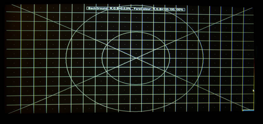

crosshatch for my setup
Here is a cross hatch that shows geometric distortion and CA I am getting with my setup. Not bad.
BTW, the screen I am using is made from the Wilsonart Designer White laminates, and is 110 inches wide (2.35 AR of course!). The Z4 is just about enough in a dark room.
dvarma, I don't know if it is too late to do this with your enclosure or not, but it looks like the prism closest to the screen needs to be adjusted to the right (as you are looking at the screen). I think that might be the cause of your severe color problem on the right edge of the screen.
Remember that the light beam coming from the first prism is like a rainbow. The first prism splits the beam into colors. This spreads the beam horizontally and makes it wider. (see How Rainbows work)
When this rainbow beam hits the second prism, the colors are re-integrated (because the second prism has the same geometry as the first).
The red colors are bent the least, and the blue colors are bent the most. Using Mark's prism geometry, and looking into the first prism from the projector towards the screen, the beam enters the first prism, and is bent towards the right, with the blue colors bent the most.
If your second prism is too far to the left, then the blue colors are not hitting the second prism on the right-most edge of your picture, resulting is a loss of blue (makes the image redder).
When aligning the prisms, it's important to put a piece of paper against the inner-face of the second prism to see the incoming beam to make sure you are catching all of it.
For this reason, I have the hypotenuse of the second prism facing inward because this is the surface that really needs to be the largest to catch as much refracted blue light as possible.
More physics in action! 😎

I will try this. Thanks very much!
