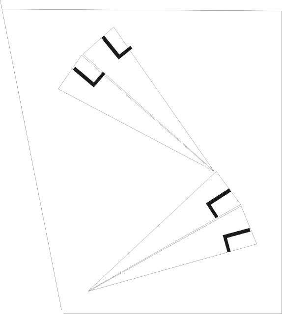

So you found that you had to increase the width (non-sysmmetrcal) on the case as well. Interesting...
My first cases looked very similar to your drawing, but in the end I found it neater to cut away the side which is why I now have a huge opening on the left.
Your angles ares still quite steep, and for me to do that would require a very much deeper case...
Mark

By CRUDE I meant not to scale(this is just a diagram of the placement of the wedges)...the angles aren't right here. It's just to show how the prisms are put together in pairs. Since I presently have the smaller prisms as the first, I have a tapered case. Thinking of doing what you did & cutting off the one side shorter...several housing tests yet to go...But, yes, the angle IS steep. Have to try to take a pic or a GOOD illustration...
I have to take the housing down to work on it so i'll TRY to take a couple of GOOD pics (and hopefully I can ask ROAR to post them for me) Actually, I have the picture SO good right now i'm afraid to touch anything.
Bud
Bud
The diagram on the BLOG is about as close as I could draw to being correct for my lens...

So is the drawing on page 72--is that the "best" way to setup for a two prism configuration?

mpotoka said:So is the drawing on page 72--is that the "best" way to setup for a two prism configuration?
Pretty much. You can compare that to THIS ONE.

Yep! And the angle affects the bowing.
So--what is the verdict on where to place the hyps. of the two prisms? On the blog it shows one hyp facing the PJ and the other facing the screen. Other spots it shows the hyps facing the same way.
I'm just wondering what difference it makes--or if one way has been found by many to work the best

OK, just went downstairs & took my lens housing down to answer this question...I have 2 dual prism sets, EACH set has the HYP facing out(ie, both right angles face the SAME way). In my housing I have BOTH lenses(1 prism set=1 lens) with the hyp facing the PJ. The right angles of each lens face the projector. I did taks some pix but since they are taped up, it's difficult to see from a picture which side is the right angle, but I checked them out. Now, this is MY result, mileage may vary, see dealer for details...yada, yada, yada! Also, as I said before, currently, i'm using 2 different sized sets, the small & the medium.
OK, my last post is a bit confusing...in or out? The hyps are facing in. I meant out as in the 2 prisms together have the hyp's one in front of the other, both facing the SAME way. 1st prism with right angle facing out...place 2nd prism the same way, butt up against the first. Does this make sense?
Now in the housing, each set has the hyps facing towards the pj.

On my BLOG? The HYPs both face out with the Aussiemorphic, so right angles in. I've done this so that the largest face of the prism is in the light path front and back...mpotoka said:So--what is the verdict on where to place the hyps. of the two prisms? On the blog it shows one hyp facing the PJ and the other facing the screen. Other spots it shows the hyps facing the same way.
