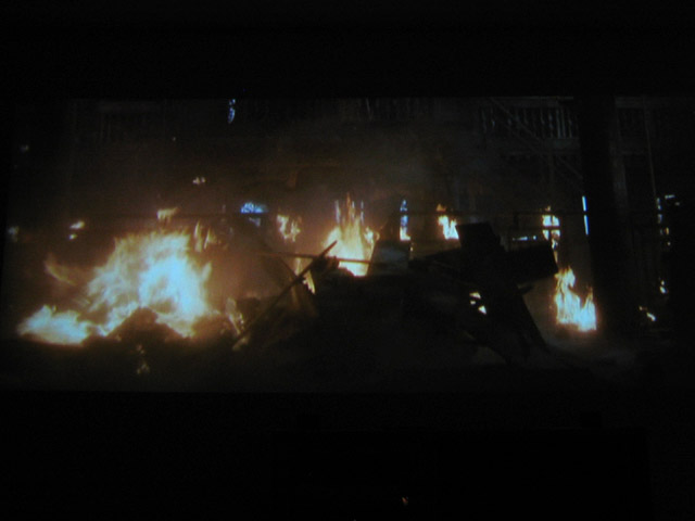

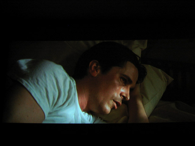

These images do absolutely no justice to what I was seeing. The images were very very clear. There was no need to refocus when moving between 2.35 and 16x9 with prisms still in front of lens. This is good as I may use a scaler and keep the prisms in front all the time.
Shot #3:
Shot #3:
Ok. That wraps it up for tonight. I'm so jazzed about how good these worked, I don't know how I'm going to get any sleep! 😀

Bud Bray said:Help! Mark & Steve! I'm still having a bit of a barrelling problem on the bottom. Still setting up on a board & tilted it downwards, like the pj beam, thinking it would correct it but not completely. It seems to be the same with a 2 or 4 prism set. Is curving the screen upwards the ONLY solution? If so, i'll just use masking on the very bottom...
Bud
Bud, I noticed that barrel affects the bottom (when the projector is inverted) more then the top. I did bow my screen to fix this, but the bottom has more curve than the top which is almost straight...
Andy,
Your set is looking real good 🙂 I am liking those screen shots. No CA, well done 🙂
Mark

Thanks, Mark. I just realized how crappy the screenshots look. I'll take some more and see if I can get better ones.
It's hard to notice on my images but there is a bit of barrel distortion but I think it's because the prisms aren't parallel to the pj lens. The pj is tilted lens up while the prisms are level on top of the DVD player. I can't remember who but someone speculated this as a cause earlier. Things are looking good. The long throw really helps a lot too.

I think the barrel is mainly from the fact the HT projectors shoot from one side, not the centre of the lens. This is why when you zoom, one end of the image only moves, and as a result, the anamorphic lens magnifies this resulting in barrel...
Even some commercial lenses do this, and the only way I know to fix it is to bend the screen...
Mark

Hm, since the AE900 has lens shift I wonder if changing this so the projector is using the area closest to the center of its own lens would help.

It can't hurt to try. From memory the last Panny 700 or 900 I played with the zoom on, and the image enlargened as I described...
Mark
That's a good point. I did have set the lens-shift up pretty high to shoot over our entertainment center. Once I reduce that to actual installation specs and align the prisms properly, I'm sure the barrel distortion will be all but eliminated. 🙂
