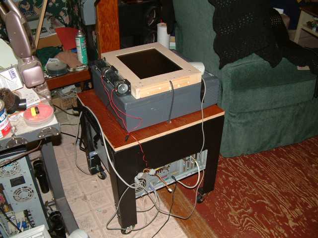

here is mine;
http://www.home.no/scipio-ger/randy
the last picture doesn't show the real picture quality; i will post better pics next week; as soon as i get the digi cam again and finished my second anamorph lense.
slize
