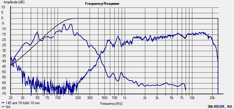

Heres a measurement from one of the paper amts
10 deep pleat (since the fold is triangle only 8 mm effective or something)
gap is 40mm open frame so just 2 metal bars like a normal ribbon except the magnets direction is different ofcourse.
the thing is 140 mm high, i used 6 x 40x20x5 magnets the cheap ones :)
its a little harder to get the res down, since the paper is kind of stiff. but i recon increasing the length helps. and also helps to increase impedance. i am aprtically fond of the high end it performs as good as the rubbanoide in distortion wise but extends more and is far more flat.
no smoothing used
hmmm i notice here the high does not extend to 20khz it does in another measurement .. aaah well maybe post another later :) just playing around :) some more

Getting accurate measurements up this high is not easy. There very well may be content up that high. BUt microphone placement makes it hard to pick it up.
Very nice response from both the diaphragms.

i think he meant you can eq the harshness away. could also be with damping clots of any sort, i always find that a nicer solution becaus it damps the membrane to and ussually you get rid of other abnormal peaks and dips to. try stuffing some felt into the backside an you wil know. usualy stuff changes in the distortion department.
although with this design stuffing might cripple since stuffing tends to first attack the very high frequency in output something you dont want to lose, but you want to lose it a bit lower :)
i keep being amazed how low you can go!
