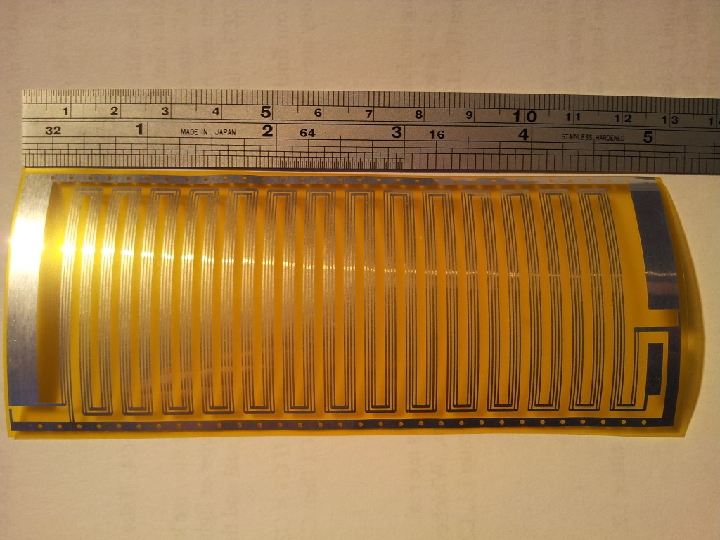

It is very difficult to fit the to layers over each other within 0,5mm.
Got my 10 and 15 my. mylar by airmail from England.
Makes 32x88x5mm double coil diaphragm , one from 10my and one from 15 my.mylar ,to fit in my new aluminium frames.
Likes to see pro layouts. One with three "coils".

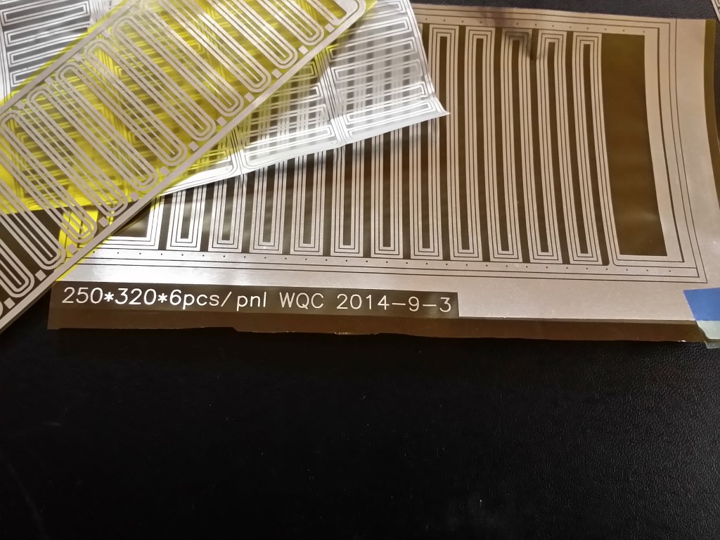

I'll say one thing about the "Pro" layouts. You are getting very good results with your own work. In fact your low end is better than anything else available until I release my latest version. So truly your work is better than what is currently available.
Your motor is strong and this pushes the balance in your favor to achieve a smooth response and low fs.
The tradeoff is complex assembly and difficult impedance loads.

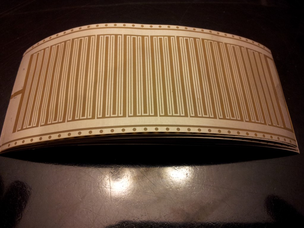

Fuuuuuuuuuuuck!!!!!!!
Just folded and baked two membranes,. good.
Seamed to be different than my other double coil models.
[/url][/IMG]
Folded wrong way. trace is turning on pleat , not on top.
Going to make a new.
This time 32x88x7mm.Easyer to compare with my latest models.10 my mylar.

Measurements..
First res freq. All diaphragms are 90x32mm and with 40my double coil.
[/url][/IMG]
390 Hz 5mm deep and 15my mylar.
[/url][/IMG]
265 Hz. 5mm. 10my.
[/url][/IMG]
260 Hz. 7mm 15my.
[/url][/IMG]
183 Hz. 7mm 10my.
Next is freq. responce.
Bernt
265 Hz. 5mm. 10my.
260 Hz. 7mm 15my.
183 Hz. 7mm 10my.
Bernt
Measured at 30cm distance.
[/url][/IMG]
5mm deep 15my mylar. on axis
[/url][/IMG]
5mm. 10my on axis
[/url][/IMG]
7mm. 15my off axis
[/url][/IMG]
7mm. 10 my. off axis.
Bernt
5mm. 10my on axis
7mm. 15my off axis
Bernt
Do I understand this correctly that the 7mm deep pleated diaphragm has a rising off axis high frequency response?
