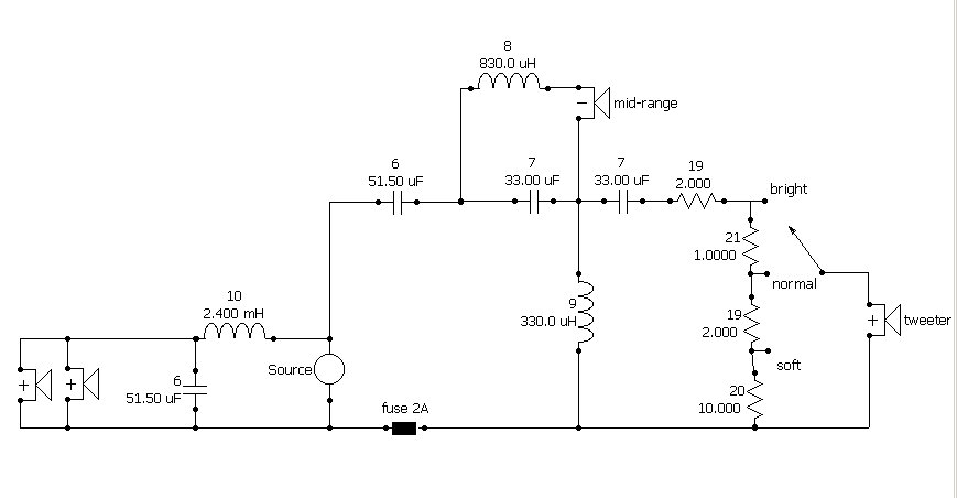

Where the transition driver crosses over to the Heil is more critical IMHO.
With a 12db/octave crossover there is some driver overlap, so matching the drivers is fairly critical. Smooth response curves, and impedance peaks out of the passband, along with high output are beneficial.
The stock AMT3 crossover is a bit strange when you break it down-a hybrid between a series and parallel. The woofer along with the midrange high pass is in parallel arrangement, but the midrange low pass, and tweeter high pass are series, with the midrange being out of phase.
There is some debate, with the stock AMT3 setup on how the speaker sounds with the mid in phase, or reversed. I prefer it reversed, along with blocking the sides of the Heil with foam.
The first schematic is a breakdown that makes it a bit easier to make up a hard wire version.
The second view is the stock O.E. schematic-which can be a bit confusing if you don't look very carefully, especially regarding the inductor values, as the print is poor.
The values can be tweaked depending on your particular drivers, but IMHO this network gives you a very easy and successful way of fully implementing the Great Heil in a DIY design, without having to deal with active crossover/amps.
Using low inductance/ESR air coils and caps, and large gauge wiring you further reduce the resistance and distortion in the network, and add a db or 2 in efficiency.
All good things IMHO.
