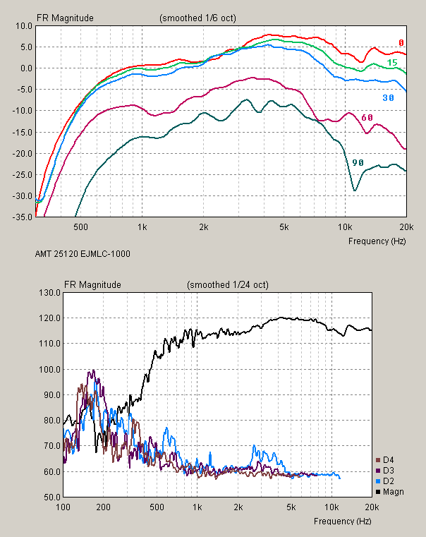

I use REW.
I think it is relative.
Bernt
Ok. Then you could use the RTA and the sound generator.
It is very good at spot distinct distortion frequencies.
I think it is relative too. So the 8 kHz peak in distortion level is about - 30 dB then.

This is from my latest magnet system with 7,5mm thick membrane. Measured at 15cm distance.
Resonance freQ. 350 Hz.

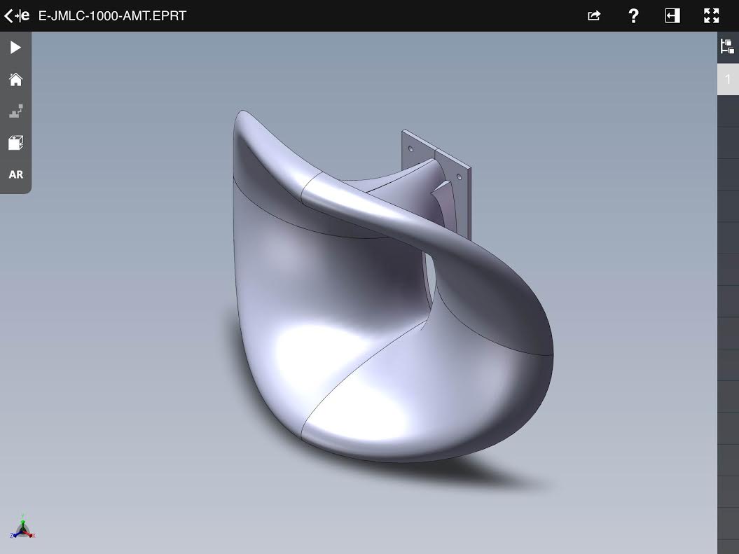

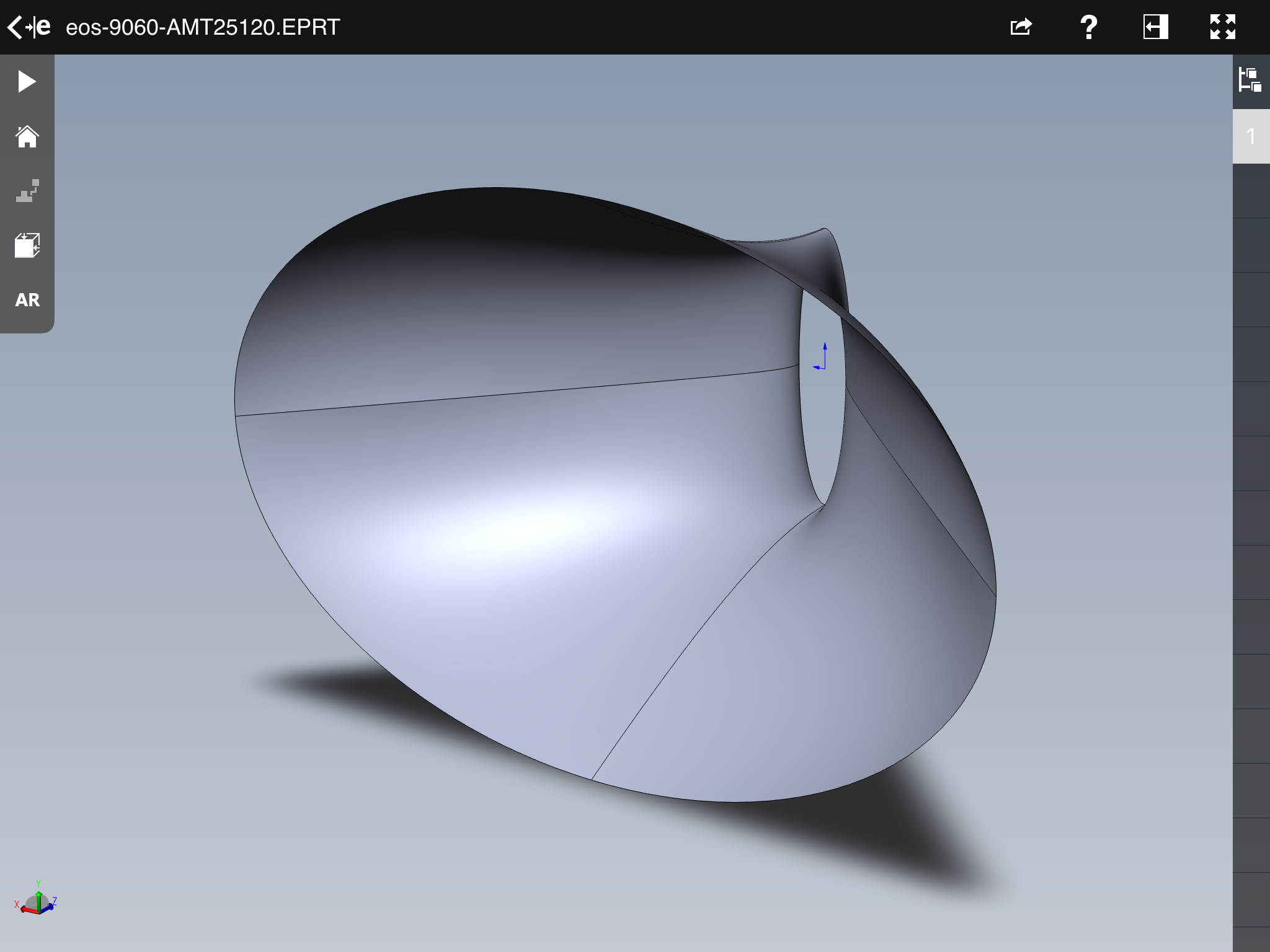

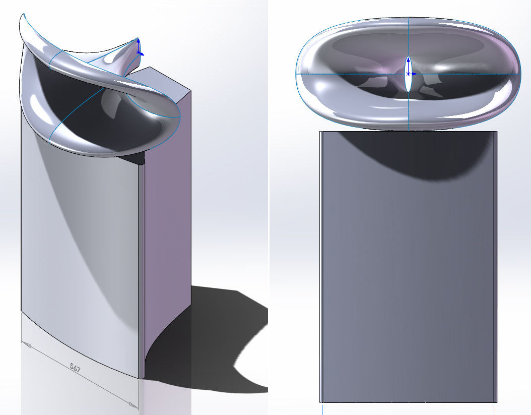

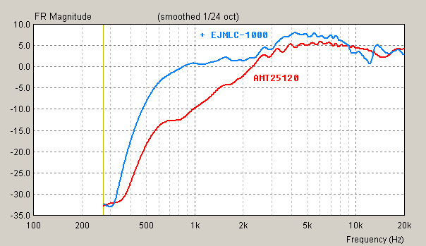

Bernt I have been working with horns since 1994.
I like the concept.
Did you do any calculation?
Or just go and make seemed to be the best idea for a horn shape?
Do you have a frequency response measurement?
Just looking at the picture and having worked with planars and horns I have a guess as to what may be happening. You might have a notch or dip in the response due to the dimensions of your horn. Specifically the width. The notch may be present in the region starting around 7 kilohertz if i remember the dimensions of your horn correctly.
I like the concept.
That is my experience as well. While it might do wonders (gaining 5-6 dB due to the mouth's dimensions) in the low frequency region, it really screws up the response in the high frequency region, that is corresponding to the throat's dimension and curve. A carefully simulated throat is a must along of course with a really smooth design and making.
