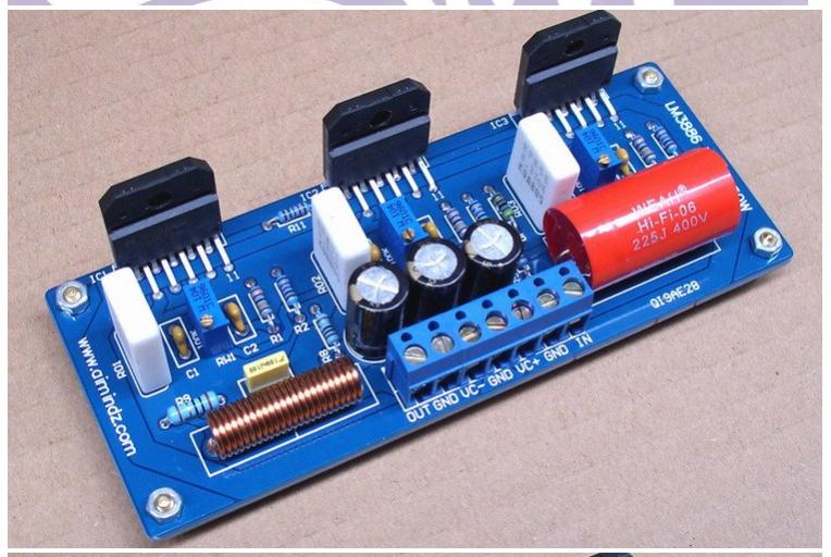

Please help me:
I am researching to buy AliExpress - Buy directly from China, two plates 3XLM3886 amplifier and 150W power supply with speaker protection:
-->> Wholesale DIY AMP Three parallel LM3886 power amplifier board 150W Current fever #868

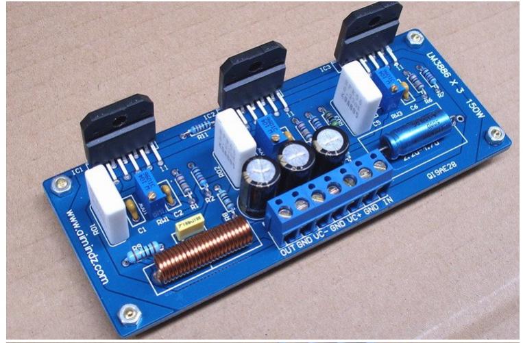

1 - 3XLM3886 on the board, has optional capacitor blue and red. Is there a difference in quality of these capacitors?

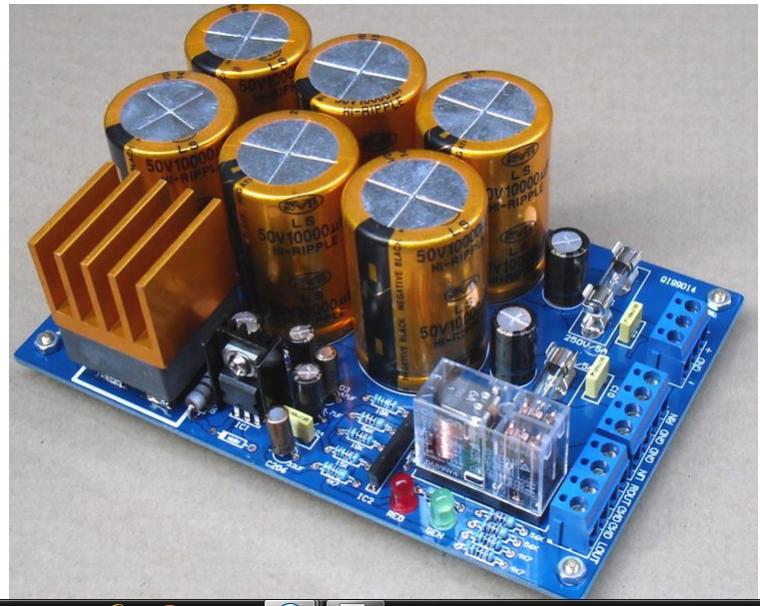

2 - As the source, this speaker protection, capacitors have 10.000uf of 50v. Can be used only one source to supply the two plates of the amplifier?
-->> Wholesale F6 universal power supply board integrated speaker protection circuit power amplifier boards #878
3 - The transformer, Transformer required: Two 20-28V 200W power more than enough power. Say that use 28V-0-28V, but how many amps?

1 - The red one is supposed to be of better quality. With products from China you never know however. There are just too many suppliers to maintain an overview which one is good and which one is bad and what is really inside of a component.
2 - You can use one supply for several amps.
3 - Depends on the application.
You should calculate how much output power can be expected and buy a transformer accordingly. Reasonable transformer sizes are 70-300 % of the expected output power, where the region from 100-200 % does probably make most sense. For home audio you can go to the low side, for PA you should choose the high side. If the case in which the transformer resides is small, badly ventilated or cramped with many other heat sources you should also rather choose a bigger power rating.
Expect 120-130 W into 4 Ohm or 70-80 W into 8 Ohm from a 28 V transformer. With a 20 V transformer you will probably get 70-80 W into 4 Ohm and 35-40 W into 8 Ohm.
With 50 V capacitors in the power supply, I would limit myself to 25-0-25 V. That should give 110-120 W into 4 Ohm and ~60 W into 8 Ohm. In that case a 200 VA transformer would be the low limit for two 4 Ohm speakers, but absolutely OK for a single 4 Ohm or two 8 Ohm speakers.
For 8 Ohm speakers that means you can achieve the same performance with a single LM3886. Three in parallel only make sense, if the transformer has more than 25-0-25 V or if the load is less than 8 Ohm.
