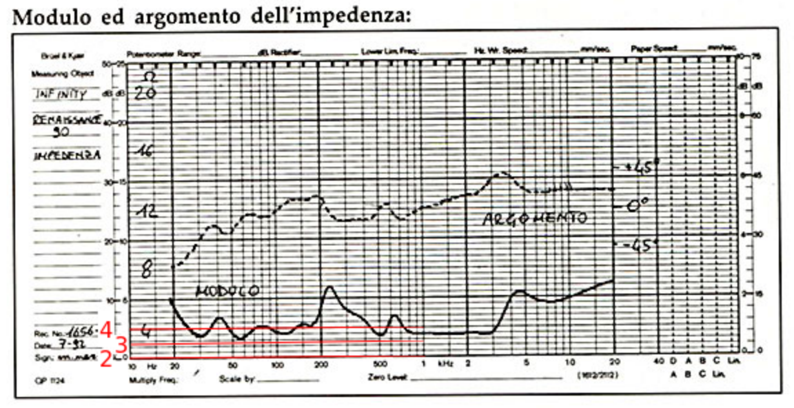

Yep, thanks, I have this aswell since relased but the scale is quite odd. Depending on how you read the graph min seems to be anywhere between 2.4 and 3 Ohm
Anyway, more interested in the driver's modelisation (complex impedance of each driver) to see how I could improve the Xover components, especialy eletrolytics as these will age. In particular, changing electrolytic caps for polypropylene caps may require (or not depending where) an additional resistor to compensate for the ESR variation... this is where I need to understand how the Xover works, Xsim might be the solution... when I find some time.

Your reading confirms then my best case reading... I was afraid to be too optimistic with that odd scale starting at 2R.
So the Ren 90 would be quite friendly speakers, with 3R worst case... and quite little module variation across the range. That's also my interpretation, although it seems too nice to be true, but well 🙂
On the other side, the phase variations look also quite OK for such drivers and filters, with no horror story such as low Rtogether with lot of phase shift...
Thanks for your help and analysis effort Allen, reconforting indeed !

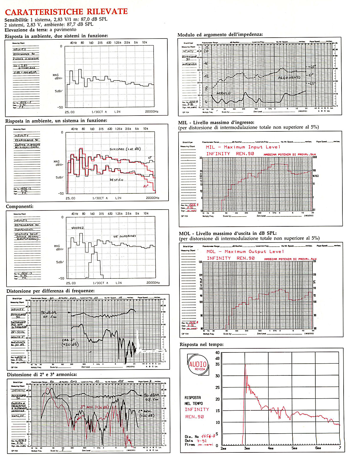

I have the same problem as you and I'm not satisfied with their measurements either, plus theirs give only a very rough idea of what mine will look like, since their x-over is not the standard one, that's described in the technical sheet /the one in my Ren90's, so I'll have to measure my own speakers.

The Ren90's look way to friendly in those measurements...but I guess they really must be.
I'll know for sure when I have the results from my own measurements, but I guess theirs can't be too far from the truth.
