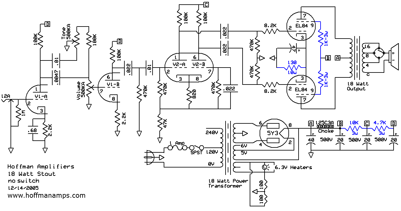

12AX7 is a great pre-amp tube and 12BH7 is good for powering something with a high grid capacitance. They're both double triodes, so you've got four triodes to play with at the moment. The most expensive parts are probably going to be transformers (Power and Output).
I used the Hoffman 18W as a basis for an el84 stereo system I built recently. Cheap transformers are out there on eBay, mostly from places like Indonesia. But there are lots of other more expensive and reputable options as well.
Subject is DIY Guitar amp help, right?
re: schematic post # 5:
If you want the phase invertor to be more balanced, then move the bottom of the right hand invertor grid capacitor to ground.
Keeping the right hand grid from moving will balance the amplitudes of the invertor outputs.
But . . . that will remove some of the 2nd harmonic, and you may not want that sound.
This is a guitar amp.
Or put a switch to select the cap connection, but do not change the switch setting while the amp is powered.

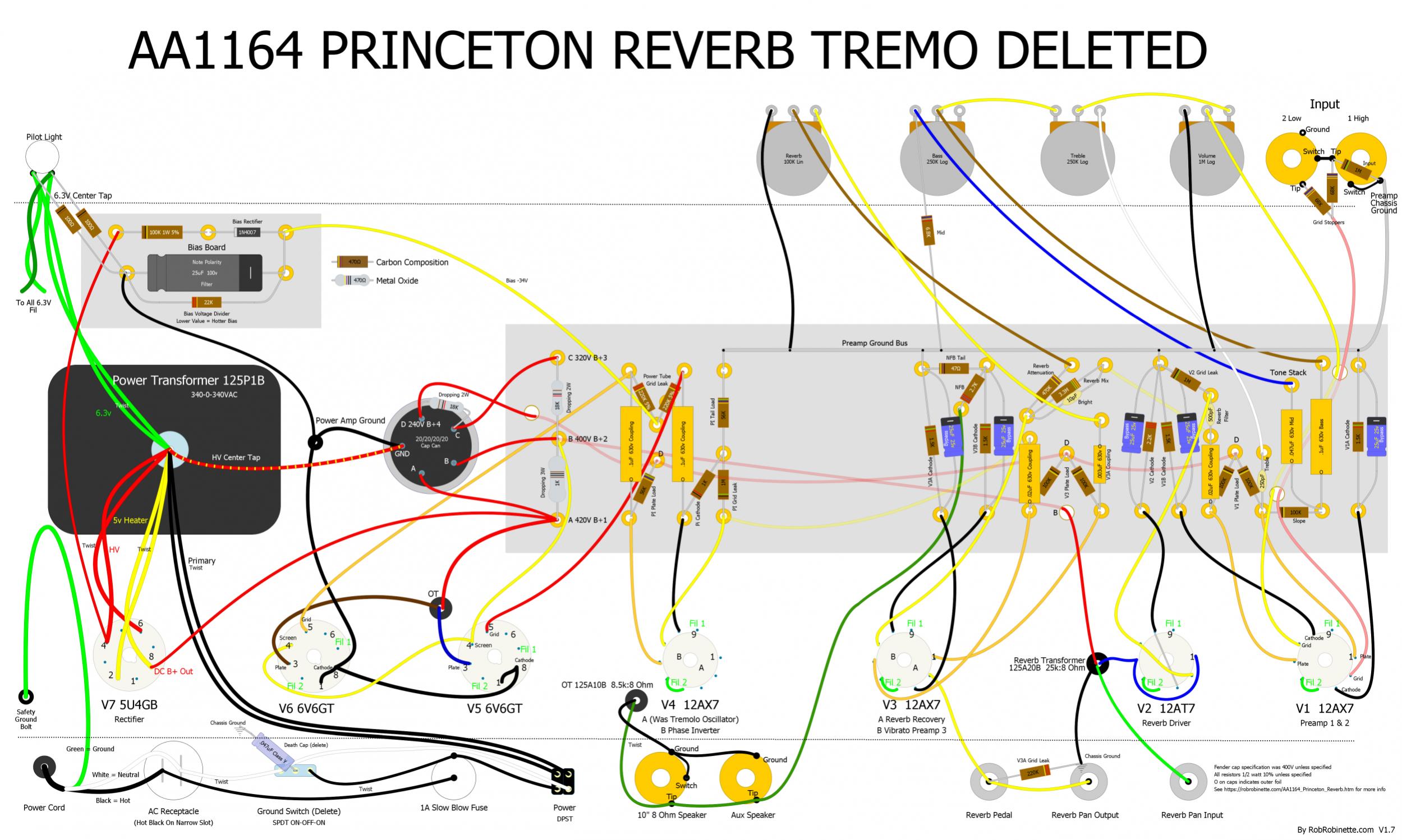

Would it be too pretentious to consider something like an AA164 Princeton, maybe with the tremolo deleted? RobRobinette has layouts and schematics for such an amp and i seem to understand what's going on in them.
Im thinking that with Gain, Mid and Master controls would be my absolute dream amp of all time, i just don't know if it's feasible for a beginner like me.

...an AA164 Princeton...tremolo deleted...with Gain, Mid and Master controls would be my absolute dream amp
As you say, Rob Robinette has schematics and layouts for a simplified Princeton, with tremolo and reverb deleted. I don't think he added a master volume, but it isn't a very difficult thing to add, if there is space on the front panel for it.
