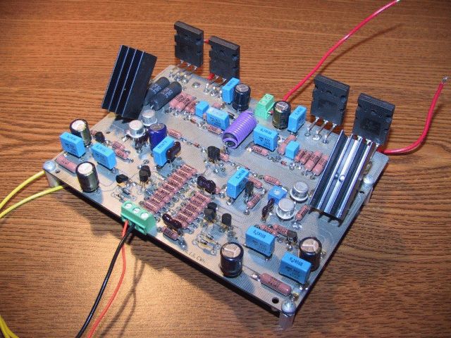

I was actually working on a 6 channel leach amp in a single chassis. I would use two 650VA transformers for this. I put this aside, as with my new Thor TL speakers, I don't need more then 60W per channel. I have a leach amp design that minimizes wiring, if you want the gerber files. I am thinking of getting a board order done in january or febuary, after I finish all of my aleph projects and start on getting a home theater setup going.
Here is a picture of my pcb. Like the P3A (which is great if you need less power), it easily mounts on one heatsink with minimal wiring. It appears to be working now from my testing, and I will soon compare it to a channel of the old design on some measurement equipment. I just have been set back by the ideas of the pass labs designs, making me want to get a good 2 channel setup first with my thor tl speakers, then worry about a ht setup for my other room.
Here is a picture of my leach amp pcb:
More pictures (and hi-rez) at:
http://brian.darg.net/leachamppcb
Brian

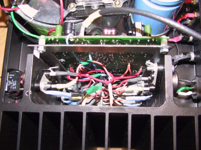

Compare this to my original leach amp wiring as Austin mentioned earlier:
Also, I am getting together a 6 channel PGA2310 digital volume control for the large amp, for when I decide to build it.
I am also working on a version of the leach superamp with integrated devices, should you desire 240W+ power into 8 ohms. I am just building it for driving a subwoofer at 500W+
Brian
