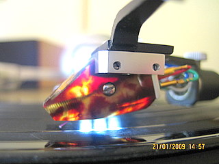

Hi
How else would you get this finish without emery paper? Aluminium parts come off a manual mill or lathe, then worked on abrasive papers from 600 to 2000grit, prepped for anodising of which the second last process is chemical polishing, then de-smutted and anodised. The last processes are colouring if required and then sealed by boiling.
Chemical polish in boiling phosphoric acid will chew threads and change dimensions if not used sparingly for only seconds. I refer here to the mounting plate only, but the rest of it was also finished on abrasive papers of the brand stated earlier.
bulgin
Hi
