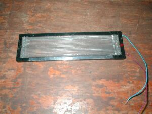

I've taken some pictures of my disassembled AMT. I will add dimensions of the parts to them. I'll probably be able to post the pictures tomorrow.

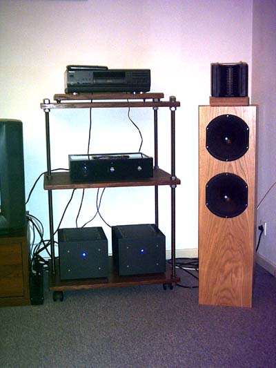

By the way these are my speakers.

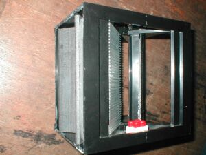

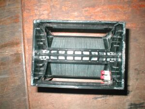

AMT-freak, how did you open up the AMT's. The sides are all glued together, so I think the only way to do it is to saw them off carefully. I would like to get rid off these curved sides and replace them with straigt rectangular ones so it will be easier to mount them trough a hole in my open baffles.
The sidewall... You can definitely do better in terms of dampening and preventing resonances.

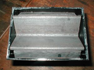

@Sjef: As you can see in the above post, the magnet assembly sticks out the sides some millimeters, so you cannot simply attach a straight panel. I removed the sidewalls with a sharp knife.
The most important parts, the magnets: Sized 127mm x 19mm x 50mm. BTW, they do look that bad in an original AMT straight from the factory. Otherwise I would have found all the missing pieces in the case.

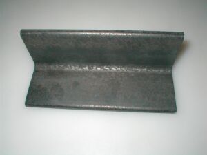

@Promitheus: They are magnetized through the thickness.

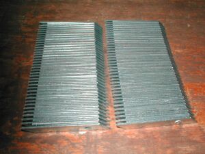

Here's the pole pieces. There are four identical stacks in each driver. They are made of 1.5mm steel sheets, height of the stack is about 120mm, they are 9.5mm long and 69mm wide.
