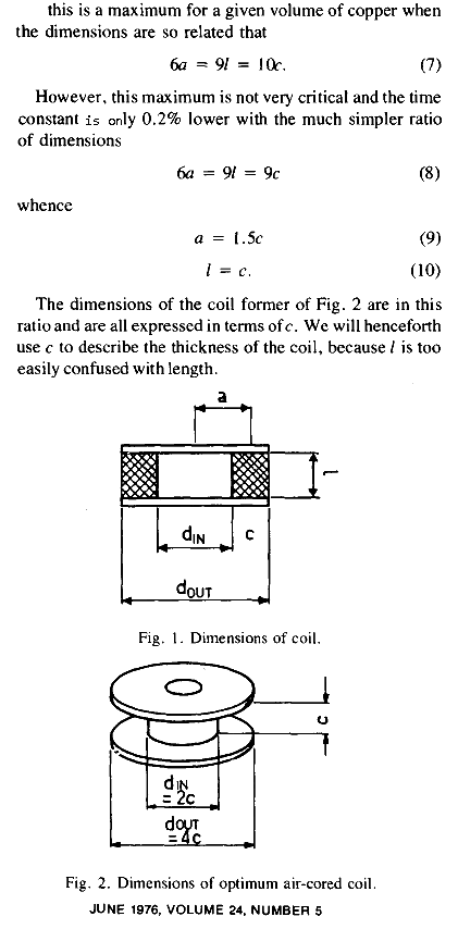

I'm trying to figure out the best dimensions in terms of the length of the coil and the internal diameter.
Looking at Solen Inductors (which is what Caps I'm using), they seem to stick to 1:2 length:diameter eg 25mm length and 50mm diameter.

There's quite a lot of different ideas about what choke profile produces 'better' sound in an air choke and you'll have to make up your own mind but the design is slightly different between low and high freq too, just to make it more complicated.
If you look at the basic Brooke's design, you have the ratios of a : b : c and the equations to build to a specific inductance.
As you see there, using the middle dimensions in fig 2, a=3c/2 and b=c. but a later work (N Theile, 1960's) found that if you make c=2b/3, (c = 0.67b) you get a 'better' sounding inductor and it still produces the same inductance when you use the design equation, depending how well you stack the windings.

Yes, no problems - this is aimed at the max L/R ration and is indeed 1 : 1 : 1 just like most commercial designs today - best "bang for buck", you would say. And even these 'standard' good quality chokes aren't at all cheap.

......Thiele's ....
Less than 10% of a 5-page paper which is very worth reading in full:
(The paper has inches and pounds but an end-note gives Metric math.)
