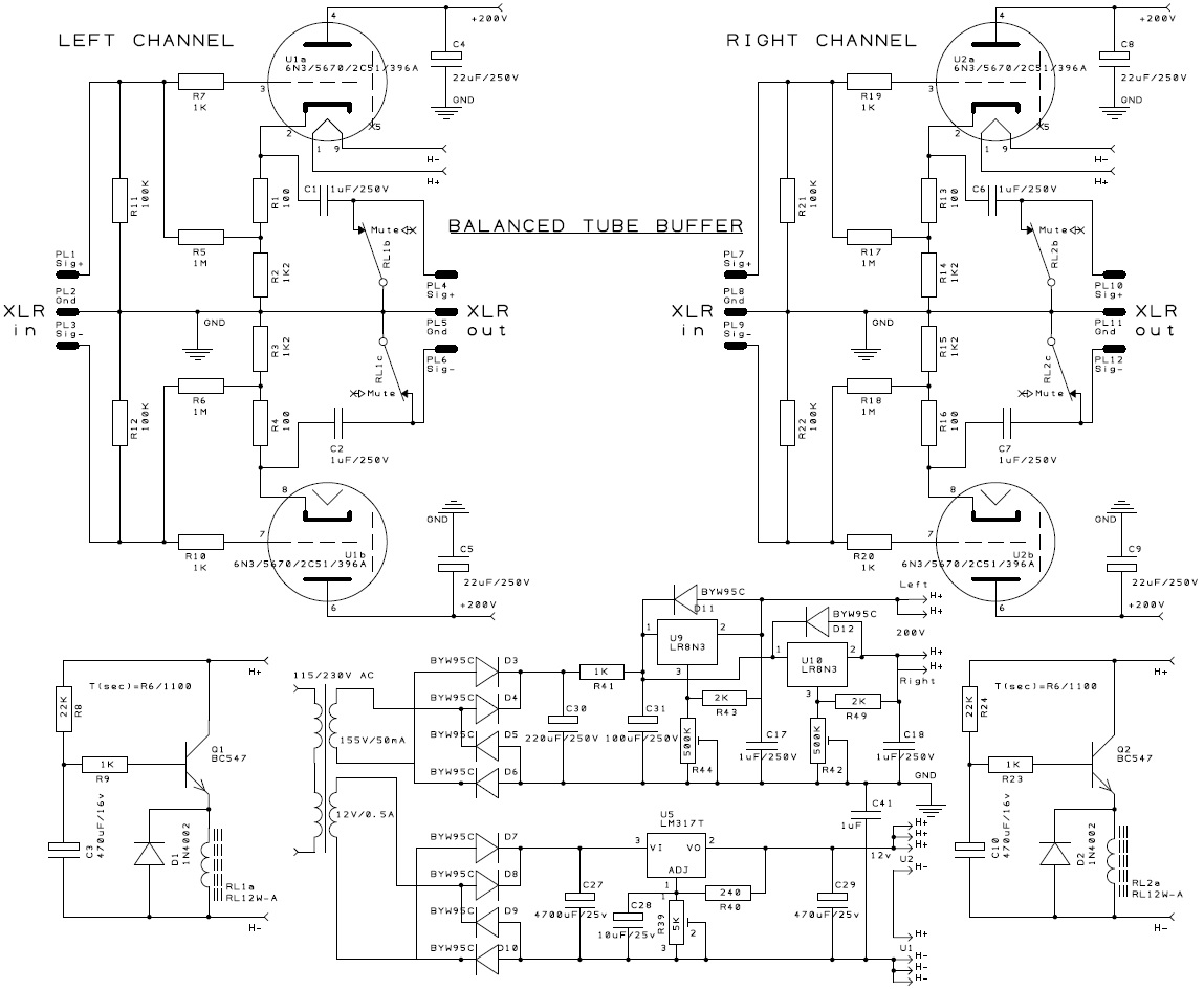

Balanced with a tube and no gain is not a problem. I use often a 5670/2c51/6n3/we396 type cathode follower buffer to ad 0,02% second order harmonics to class d amps. That is what ps audio also does. Do you need only schematic or also a PCB design gerber?
You can also modify the schematic for use with 6n6p or ecc99.

Below the schematic for the balanced tube buffer(no gain).
It has schematic for silent power supply to. For stand alone.
It has also 20sec startup muting so the tube can heat up without nasty sounds at buffer output.
You can also modify schematic for use with Hypexsmps1200 power supply. Just ask me.
I use it with Hypex class D modules to make them less analytic. Also i use a version with gain for Ncore500 and 1et400a.
Rolling different tubes changes the sound signature a little bit.
Ronny

I am working on a similar project, it would be very nice to have a Buffer powered directly from the 1200AS2 board.
This amplifier has auxiliary power rails of +15/0/-15, and +60/0/-60.
It would be nice to avoid the inclusion of a transformer on the chassis itself.
You may not need a symmetrical version, a single-ended one would be sufficient, if necessary a balancer circuit can be used later.
Regards

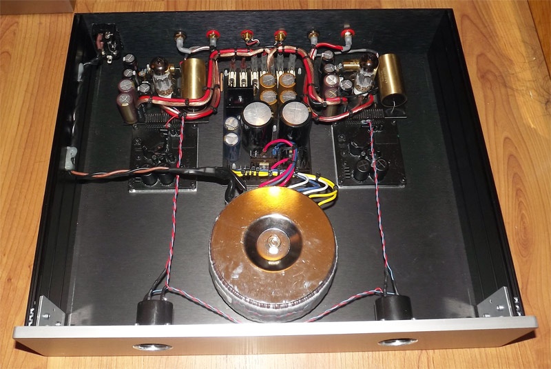

@koifarm, I found a post of yours that says this:
"It is not necessary to convert to symmetrical output. There is no improvement.
Just go asymmetrical with one tubestage and without the opamps. A Ecc99(6n6p) with 6k8 output resistor creates just 3x gain and the right harmonics. Using +/- 65v rail voltage for anode supply and 12v for heater from the original power supply. See picture of my board."
Help with tube buffer
I had a buffer with ECC99, it sounded wonderful, if I could incorporate this buffer into my amp it would be ideal.
Thanks.
