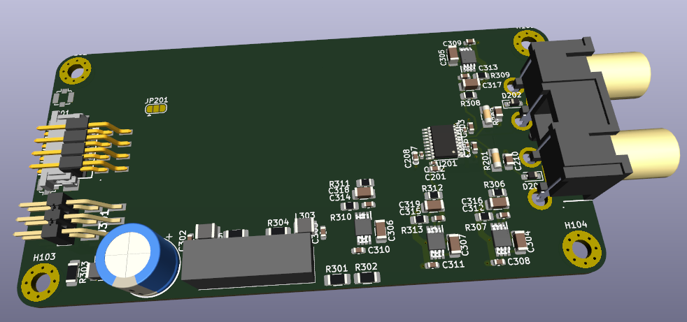

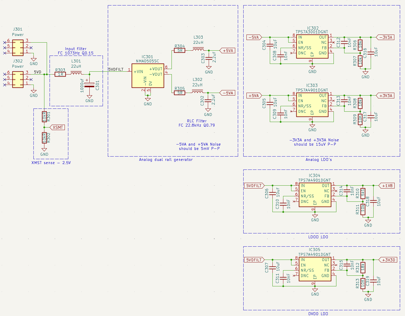

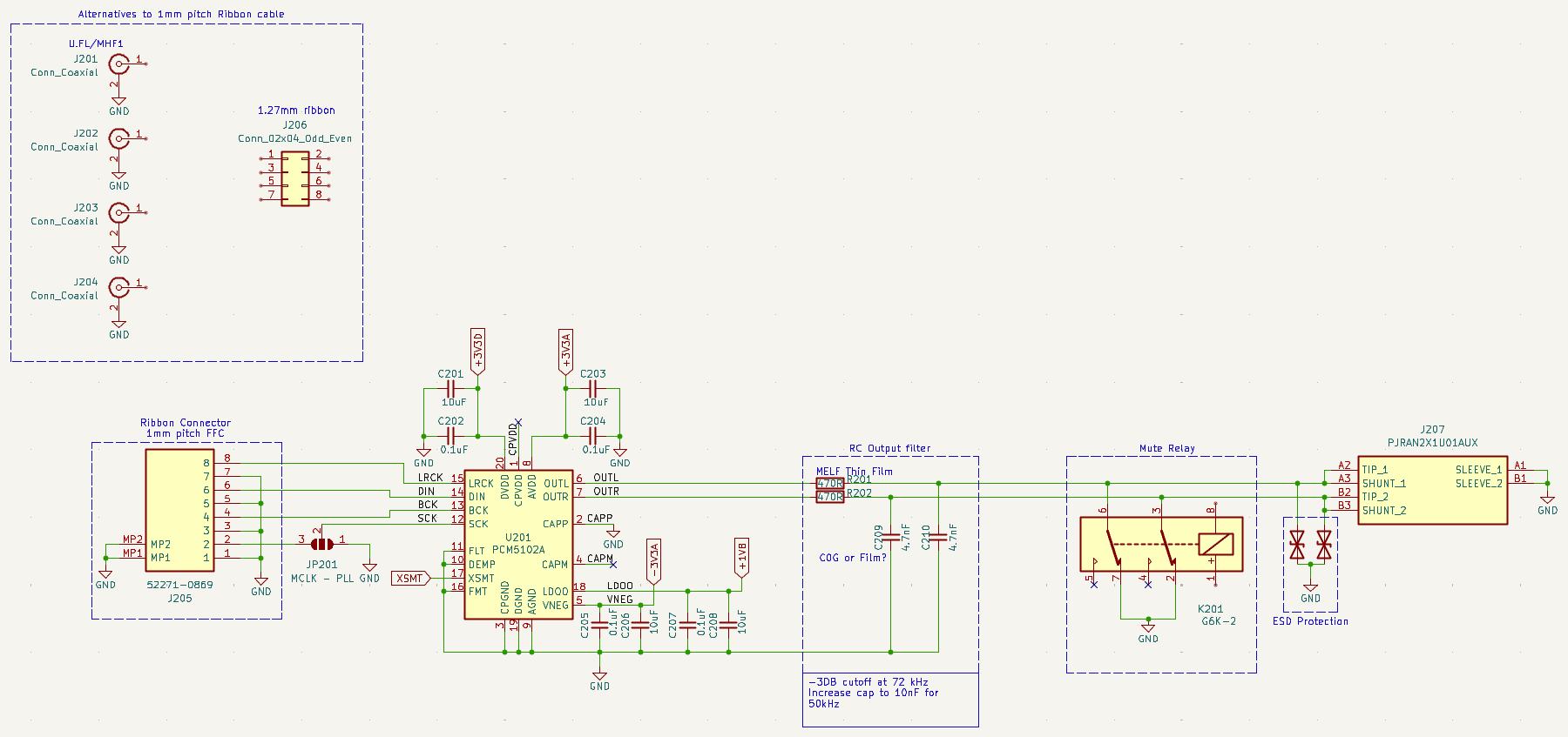

So this is the current stage of my PCM5102 based DAC. This is mostly a proof of concept of the whole modularity of my DSP. Main goal is to test all the connectivity, fugure out if I will use FFC, or normal ribbon cables or U.FL connectors as well as how to distribute power. All while trying to reach decent performance (Not top of the line HiFi).
Schematic PSU:
Schematic DAC:

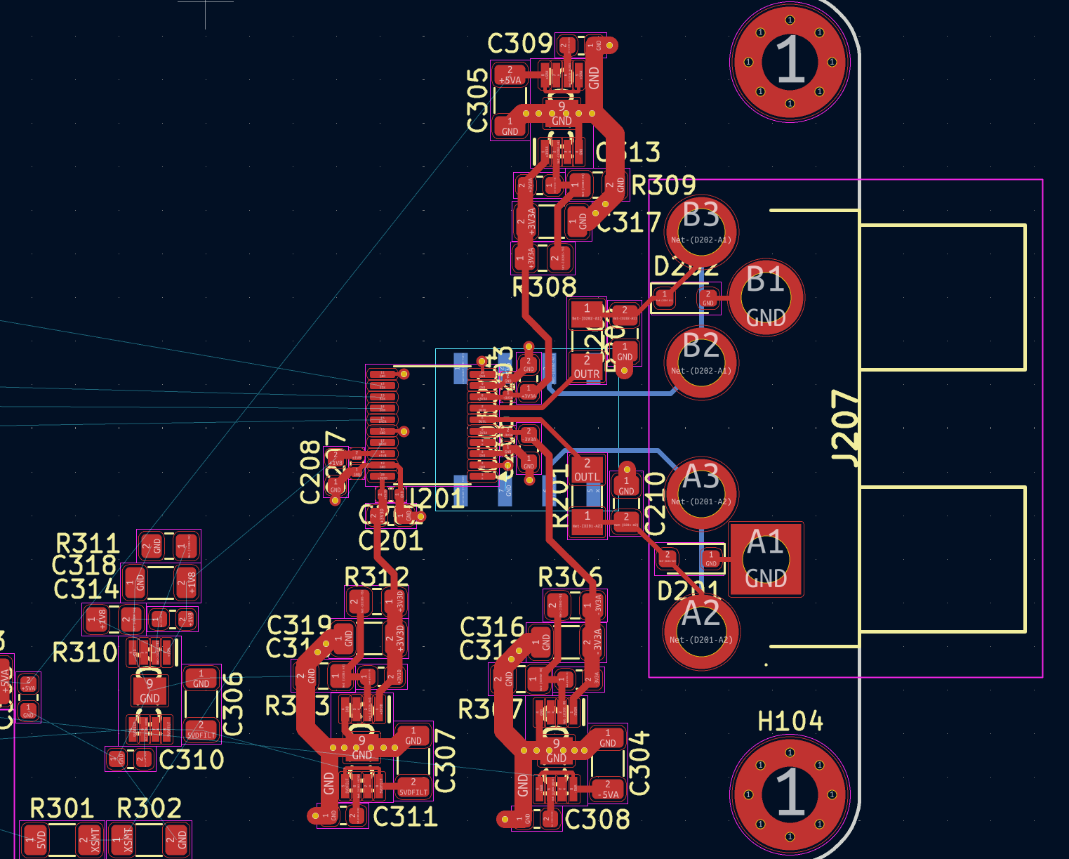

Layout still isn't finished but this will give you an idea of what it will look like:
And 3D render:

Any thoughts @Markw4 and others? 😀
