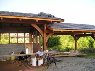

I have not activated my idea as yet to cast some vinyl. I am quite confident it will work well and the technique I am going to use will not likely be too dangerous. Here are the ideas so far.
I have a larger propane burner that will work just fine for heating. I will be outside n the shed. I am going to use an oil bath just like a deep fryer set up. I will keep the oil temp down to approx 400'f to reduce the risks of flames. I will be using a stainless steal bucket as a crucible in the oil bath. I will cut the records up into small bits and melt away. I am going to make a plywood mould that will be 3/4 inch bigger diameter than the finished size. The casting will be + - 3 inches thick and 13inches in diameter. I will screw mount a face plate and begin the turning.

er, I still wouldn't do this in a shed , because of the possible volatile fumes attaining a ratio for combustion fairly quickly.
Please do it outside, even if it is fairly cold. Your burner element will throw off a fair bit of heat. You can easily do as the S.A.S handbook suggests, build a small reflector of logs or stones or brick to direct some of the heat toward you. No spirits to warm you up either :) , until after the pour is completed and the burner is turned off...
If need be you can put up a tarp on the windward side of the "fire" to reduce the breeze past the burner.
stew
This is my shed. It is quite open. Heaps of ventilation

I have to say that your plan to melt down and cast vinyl is very foolish. The risk of personal injury far outweighs the gain especially when one can purchase a 24"x48"x1" sheet of PVC for about $230 USD. You can easily laminate 3 cutouts to get a 3" platter.
I suggest you have a look at this website before you procede.
http://www.besafenet.com/pvc/about.htm
I am not posting this to belittle you. I am just very concearned that what you are trying to do may have consequences that you have not considered.
