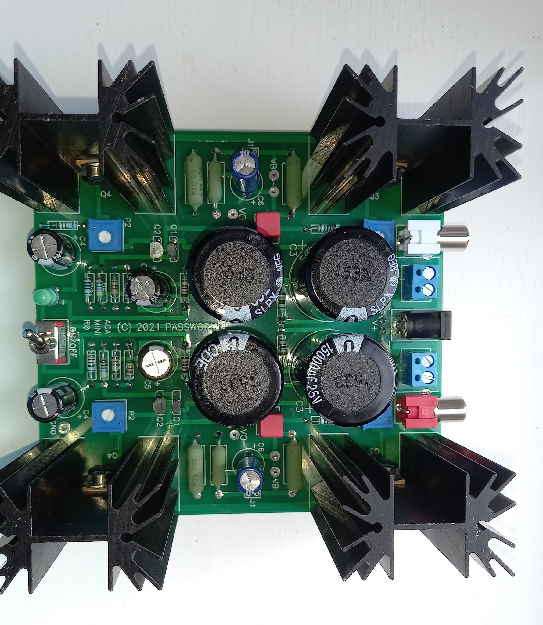

I just finished my unit with the essential kit and supplied my own parts. I got the PSU today, fired up, no smoke.
upon measuring between VO and ground I automatically get 11.5 volts on both sides. But I do see 0 between the VB locations.
Under the impression I should see 0 for both. Any help is appreciated

If you have 0 volts VB, that means no current through r8 and output transistors.
Heatsinks are cold and sound is very distorted.
Unless you do not measure right. VB is not measured against the ground. Its the voltage on the resistor.
Start with all pots in the middle, then slowly turn right step by step both alternatively.

Read the instructions, VB should be 0.3 volts.
Instructions are in pdf article on first watt webpage.

If any question remains about where to measure Vb, the very clear diagram provided by Charles Port in post # 1068 (here) shows connection points graphically for the left channel.
(Note though that for the V0-GND measurement, Charles chose to use a speaker ground for GND, which is equivalent to the labeled GND point at the lower-right of the PCB).
I'll also note that I did not see any voltage across the Vb pairs until I got well past half way (12 o'clock) on the pots. Final settings were at about 3 o'clock on the pot dials (I'm talking about general position of clock hands, not the tiny markings on the pots, which I can't read).

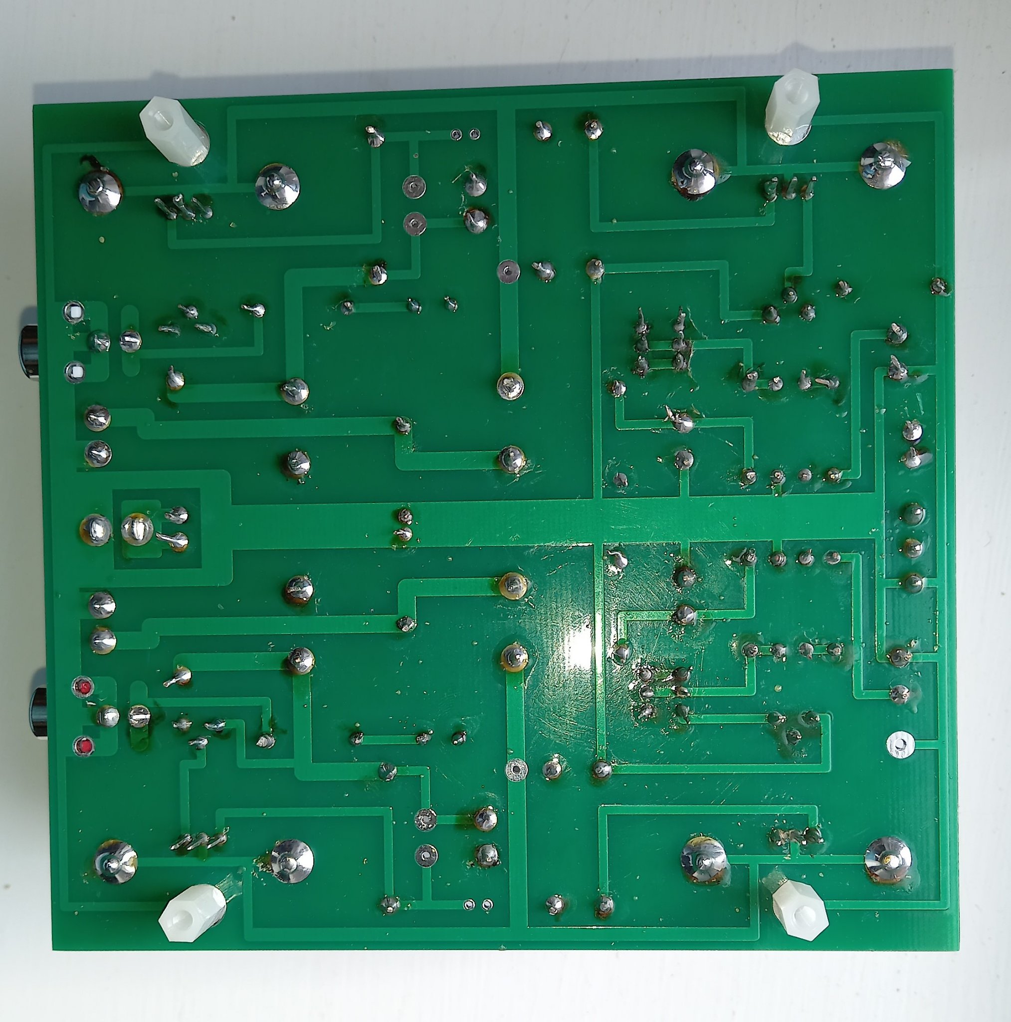

Help!! I completed my amp at the weekend but all 4 heatsinks are cold after power up. I can adjust values for Vb but there is no drift from these once set. I can also adjust Vo to around 11.5v no problem. Can anyone point me in the right direction to begin fault finding??
Kevin’s video of the bias set up was VERY helpful to me setting bias.Help!! I completed my amp at the weekend but all 4 heatsinks are cold after power up. I can adjust values for Vb but there is no drift from these once set. I can also adjust Vo to around 11.5v no problem. Can anyone point me in the right direction to begin fault finding??
The amp will be cold until you set it correctly.
You will want two Digitial meters.
Adding a few posts to clip the meter leads to helped me.
