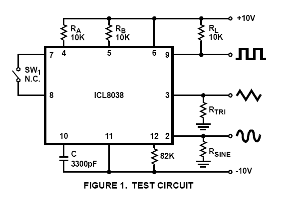

OK folks, problem solved. Unfortunately not without significant embarrassment on my behalf.
So the first thing that I did was to replace the 4.7uf cap with a 470uf cap - this led to a significant improvement in the noise, almost perfect but not quite.
I then revisited the 79L12 (IC4) which had the ripple on the out pin. I decided to replace this IC - Eureka, perfect!! I then put the 4.7uf cap back in, once again perfect. Problem solved 100% with a sharp beautiful trace.
So what went wrong? Here's the embarrassing part. I presumed it was just a dud IC but then I looked closely at the little bugger. It was labeled BC548C (tiny writing). The BC584C is an amplifier as far as I can tell. So, I figure I was taking the small ripple from the smoothing caps and amplifying it onto pin 11 of the 8038.
Sorry for wasting everyone's time and thanks for all the responses. To my defense, the BC548C did come out of a fresh pack from Farnell labeled 79L12. All the others are correct. The other problem of course is this solid state stuff - you could never mistake a 845 for and EL34 😀.
Anyhow, I learned a lot and despite (or because of) the frustration had a lot of fun.
Rob
PS Post above should read pin 11 not 8

1. There was a nice simple little circuit for it on the web with a PCB template.
2. I wanted a stand alone function generator.
3. I could not find a simple option using a more modern chip.
3. Being obsolete has it's advantages - They are no longer needed where a friend of mine works and he was able to put his hand on a couple!
