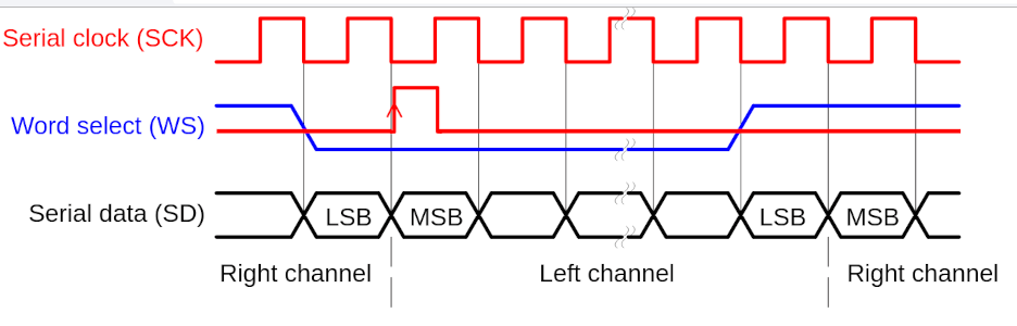

I was studying the bottom of the page 1 in the schematic (post #7 above). I guess it is all about selecting the L R channels - am I right? Boy, my brain hurts! I am wondering what is wrong with just using the WS for one channel and the inverted WS for the other one as 74hc595 is triggered by the rising edge of the WS signal. Is the worry about one channel getting late by one BCLK period in that case? If so, why can't one use a flip-flop with complementary outputs such as MC74AC74? According to data sheet there seems to be identical delays from clock to both inverted and non-inverted outputs. Are there any basic issues I am missing?

You are right, this could be more simple, but it's not that simple. Both channels should be latched at the same time, otherwise there would be a phase difference between channels for a WS half-period, or 32 BCLK. 74HC595 for both channels are chained and lathed simultaneously. The latching edge should come from an inverted WS and be delayed for one inverted BCLK (SCK) cycle (negative edge triggered D flip-flip is not that common). I made a pulse, now I'am not sure why.I was studying the bottom of the page 1 in the schematic (post #7 above). I guess it is all about selecting the L R channels - am I right? Boy, my brain hurts! I am wondering what is wrong with just using the WS for one channel and the inverted WS for the other one as 74hc595 is triggered by the rising edge of the WS signal. Is the worry about one channel getting late by one BCLK period in that case? If so, why can't one use a flip-flop with complementary outputs such as MC74AC74? According to data sheet there seems to be identical delays from clock to both inverted and non-inverted outputs. Are there any basic issues I am missing?

This isn't in compliance with the following statements of the "I2S bus specification",
Yes, it can be seen on the first page, SDOUT is connected to next SDIN.Does that mean that the "SDOUT" coming out of the last 595 on your second page goes into the other channel's 595 chain so that you are strobing them simultaneously? This may sound obvious but this is the fist time I am really noticing the issue.
but it's great circuit simplification as the I2S transmitter word length (actual sample data length can vary) is configured and known."It isn’t necessary for the transmitter
to know how many bits the receiver can handle, nor does the
receiver need to know how many bits are being transmitted."

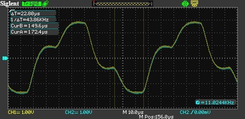

I have proof that this circuit works fine with latching/converting both channels simultaneously. 11.025 Hz signal with 44.100 Hz sample rate. No phase difference.

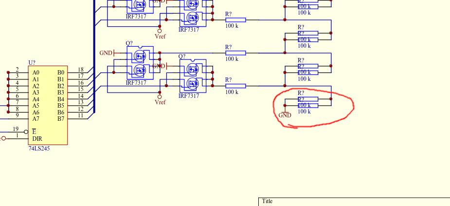

To be honest, I don't understand this schematic 🙂 Part with tubes, MOSFET, and logic gates 🙂 But looks like there is an error in the R-2R network. Shouldn't that be 2R, not R?

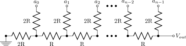

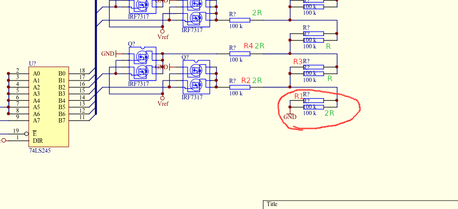

Yes, but this should be 2R (100k), not 100k || 100k.
R1 || R2 = R
(R1||R2) + R3 = 2R
((R1||R2)+R3) || R4 = R, and so on...
R1 || R2 = R
(R1||R2) + R3 = 2R
Thanks, I will fix it. The whole design was based on the idea of trimming the upper bits. For the trimming a built-in generator was used that generated n+1, n and n-1 levels in sequence, that could be observed on an oscolloscope and trimmed so that the analog level of n falls between n+1 and n-1.
With trimming one doesn't need extreme tolerance resistors, 0.1% will do.

BTW, enaB, what is the source of the 11.025 Hz signal? A test track on a CD or a computer or...? What an impressively clean and repeatable data is that.
They (two signals) can be sampled simultaneously or interleaved, but D/A conversion must follow the same scheme.
That must have been hardly detectable. I think the mistake would effect only a few lowest bits.
@lcsaszar, Vref is short-circuited to GND in every bit transition by very low Rds(on) MOSFET-s.
A computer, signal generator in REW software. I have only a USB connection for this prototype DAC.BTW, enaB, what is the source of the 11.025 Hz signal? A test track on a CD or a computer or...? What an impressively clean and repeatable data is that.
Could be. But there is another issue with this, and that is IRF7317 shoot-through.That must have been hardly detectable. I think the mistake would effect only a few lowest bits.
