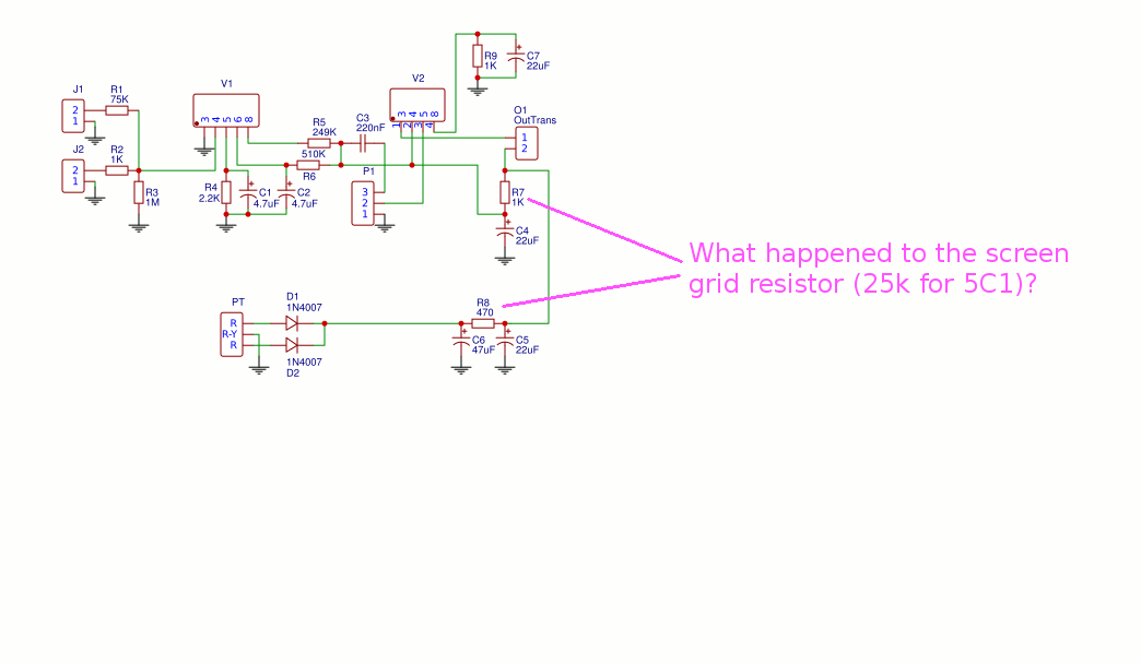

This is too confusing to be even the least little bit usable. It invites errors, and lots of them. Trying to draw a correct schematic in which every component is shown as a rectangle is a bit like trying to correct the spelling of the rest of this sentence, which I shall write using only the letter "a" to replace all aaa aaaaa aaaaaaa aa aaa aaaaaaaa. 😀
See the attached image for yet another bit of confusion - what happened to the value of the 6V6's screen grid resistor? 😕

The thing that's being overlooked is the screen grid voltage on the 6V6, which also factors into the proper value of cathode resistor.1k for the cathode on the 6V6? Seems a little high.
The 5C1 seems to use a very large 25k dropper resistor to feed the screen grid (and the preamp pentode). The screen grid must be at a relatively low DC voltage as a result. And Leo used a 470 ohm cathode resistor.
The 5F1 uses a 10k dropper resistor between B+ and the screen grid node of the power supply, less than half as big as the 5C1's 25k. It seems power transformer voltage was raised too. So there's going to be lots more DC voltage on the screen grid. As a result, some people found it took a 1K cathode resistor to bring plate dissipation within the 6V6's specifications - I linked to a thread about this earlier.
Me, I take the conservative engineering approach. I would rather start with the 1k cathode resistor, measure DC voltages, calculate plate dissipation, and only lower the 1k if the 6V6 was safely within specs and still had a safe margin for further abuse.
-Gnobuddy

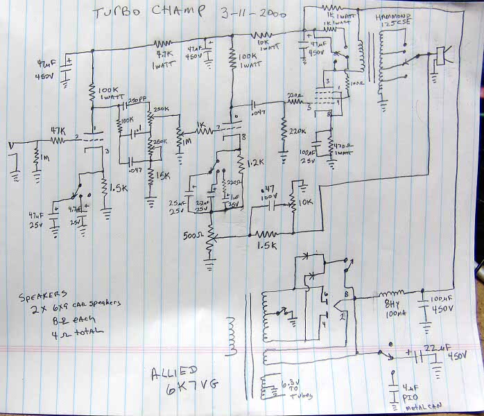

At the time that I was building Champ clones (mid 60's) there were no schematics available, and 12AX7's were not yet common in the trash. Sometime later, maybe late 60's a high school friend traced out the circuit of his 5F1 which used a 12AX7.
I built one, again with parts sourced from the trash. I liked it better than the 5C1 clone, so started making them.....It was about the time that you could find some scrap Magnavox HiFi sets with a 12AX7 and a 6V6 in the trash dump.
Fast forward to the late 90's. My daughter was in the high school marching band. Most of her friends carried musical weapons of some sort, often a guitar. My daughter had a full double bass drum cage, so our rec room was the designated practice spot. I made them a guitar amp.....then another, then several. All based on the Fender 5F1 Champ. No two were the same, and some of them used car stereo speakers obtained real cheap when the local K-mart closed down.
Most were hastily built from whatever I had around. Output tubes ranged from 6V6's and 6K6's to KT88's with several different transformer sets, most salvaged from amps that I had dissected. Many of the power transformers came from some scrap HP audio oscillators, some had tube rectifiers, some solid state due to the lack of a 5 V winding on the HP transformers. Most were given away for free, so cost was the driving factor, but they were good sounding amps. Some were upgraded, or built with real guitar speakers at the new owner's request. They bought the speaker.
After the last amp was built I drew up this schematic from memory. it probably doesn't exactly match any of the amps since all were different, and no two were the same. All had some switches to affect the tone, some had tone stacks, some didn't. The number of switches and controls varied depending on what I was using for a chassis, how many holes I could get in it, and what switches and pots I had in my box of dead circuits.
At least two or three did use the 6K7VG power transformer, a KT88 and a Hammond 125 series OPT. That transformer produces about 430 volts of B+ which is far too much for a 6V6 or 6K6 tube. Those amps got the HP transformer for about 350 volts, or a 6K56VG transformer for about 335 volts.

The 290WEX, 239VAC@50mA? With no losses (x 1.414) you get 335Vdc. A little shy of the 350V in the above schematic. Even at 50mA across 470 ohms is there need for a 10W cathode resistor in an amp that puts out 5W? 23V across the resistor, multiplied by 50mA, 1.2W. Again, with no losses which is not realistic.
Given the transformer being used a 470R 5W would seem more appropriate. But then again, I am not a great authority on Champs. But these guys are, current production.

The 6V6 tube in the Fender Champ, and many other Fender amps is run far beyond it's plate voltage spec of 315 volts. The screen voltage spec for the 6V6 at the time the original Champ was designed was 285 volts. Also exceeded in many amps. Some modern 6V6 tubes can eat a lot more voltage than the vintage stuff.
The large 10 to 25K dropping resistor prevented tube meltdown when the amp was driven hard into clipping because the screen voltage would drop when it started drawing heavy current. This also pulled the preamp's B+ voltage down, reducing it's gain and performing a self limiting function that prevented blown tubes. It is also a built in compressor of sorts with it's gain and time constants determined by the large resistor and the filter cap values.
This is what gives those old amps that punchy attach and long sustaining sound when driven hard. The small OPT and speaker had poor low frequency response which helps to reduce hum. That's why these amps often exhibit a faint hum when wired to a cabinet with bigger speakers.
I'm going by the part numbers in the linked TubeStore schematic since it's the most clear, and correct schematic. If one were to DIY a Fender Champ clone, it's a good schematic to use.
The resistors and cap values in the power supply filter R13, R14, C5, C6, and C7 will affect the B+ voltage, and how much of this "compressor" effect, and it's attack and recovery time you will get. Larger caps and smaller resistors will reduce the effect, but increase the B+ voltage, so the output tube's cathode resistor must be increased.
Diodes D1 and D2 and thermistor RT1 are added to prevent blown rectifier tubes and will not affect the sound. I added them to my SSE HiFi amp design to reduce dead rectifiers. A 5AR4 tube can be used instead of the 5Y3, it will produce more B+ voltage and better voltage regulation for a "tighter" sound.
R12 is the feedback resistor. It is a big contributor to the "tone" of the amp, and it's action is highly dependent on the speaker being used. Another place to tweak the tone.
C2 and C3 are the coupling caps. A higher value .047 or so will allow more bass through the amp, this can make it "fuller" or more muddy, this depends on your guitar, speaker, output transformer, and playing style. Adjust to taste, and they do not need to be the same value.
I see no reason for fuse F2, but someone must have found one.....I would leave it out, but that's just me.

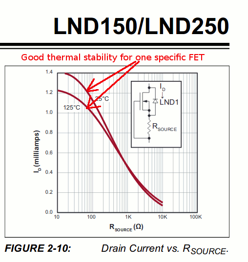

So 18.5V across the 470R resistor, 0.0439mA. The GE datasheet says at 315V, -13V bias and 0.036mA, so not too far off of Fender's take. Seems the newer Champ's run the same voltages as the 360V (350V plate) in the Harvard schematic. They did increase the cathode resistor from 1W to 2W though, also added a 470R on the screen. So say 350-20 = 330V, multiplied by 0.040, 13.2W. So if we have 12W on the plate and 1.2W on the screen it would seem that the Champ is operating within its limits with Fender's values.
Using LND150s instead of tubes makes total sense, but the 3.2 Hz 😱 input high-pass filter doesn't, nor does the unreliable biasing method (self-bias) for the recovery MOSFET. 🙁Effects loop can fit on a pef board, no heater current required. Put it after the volume control and before the second stage.
It only takes two more components to turn this into a reliable biasing scheme. Add one resistor to bias the gate of the 2nd MOSFET with a potential divider, like the first, but chosen to put something like 20V DC on the gate. Increase the source resistor accordingly. And add the second component - a small resistor in series with the source bypass cap - to define the AC gain.

Using LND150s...sense... does the unreliable biasing method (self-bias) for the recovery MOSFET. ...
It makes sense. The LND150, unlike almost any other device we can name, is tightly specified for Id vs Rs, see page 5:
http://ww1.microchip.com/downloads/...etion-Mode-DMOS-FETs-Data-Sheet-20005454A.pdf
Also the output is a "small" signal (relative to supply voltage) so we don't need precision of operating point.
K.I.S.S.

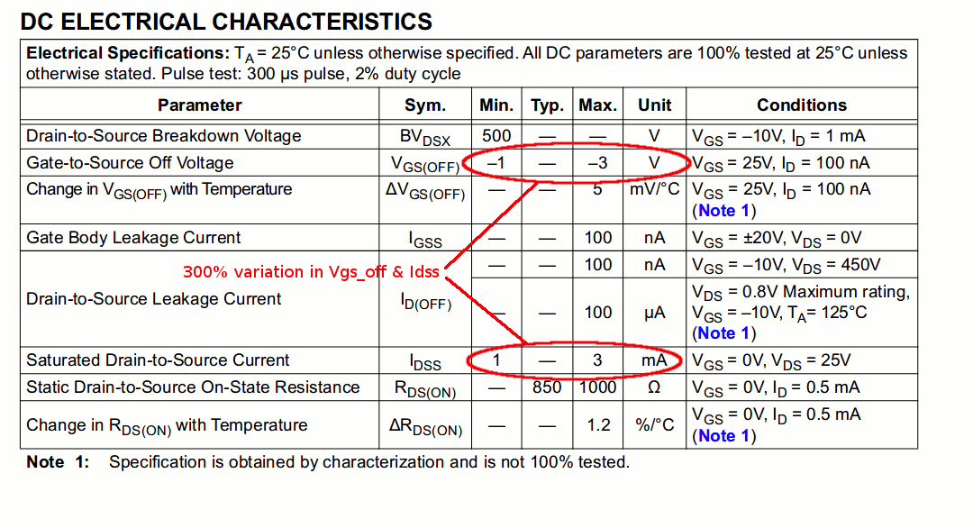

I think you are misinterpreting that datasheet.The LND150, unlike almost any other device we can name, is tightly specified for Id vs Rs, see page 5:
The datasheet shows that Id vs Rs for one specific LND150 shows little variation with temperature (image attached.) There is no variation shown with Rs because the data is for one (bogey) FET.
I know that data is only for one single FE, because elsewhere on the same datasheet we see that Idss and Vgs(off) each vary over a huge 3:1 ratio (image attached.)
Just like ye olde JFETs of ancient times, apparently. Evidently the rumours of tighter tolerances in MOSFET parameters don't apply to the LND150.
300% variations in Idss and Vgs(off) automatically mean there will be large variations in drain current (Id) between different samples of the LND150, all with the same value of external source resistance.
Along with that will come large variations in headroom and voltage gain as well.
Isn't this exactly what good electronics design is supposed to eliminate? Large amounts of random variation between production samples?
As mentioned earlier, it doesn't take much additional complexity to do much better: just two additional resistors.
