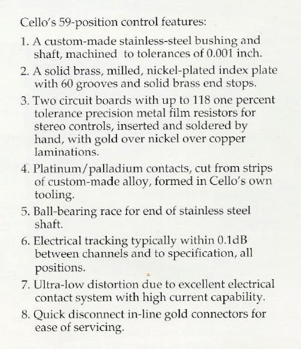

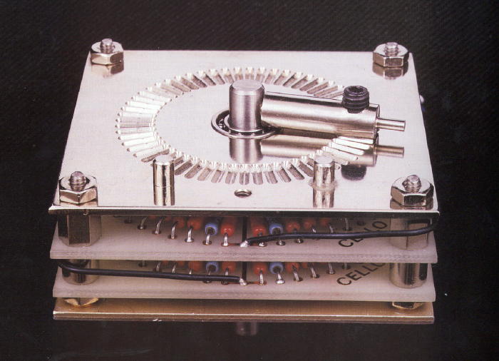

Cello is probably out of business now. It was a company started by Mark Levinson. You might try to search under Cello Music System. Here's the pic of their attenuator.

When the whole thing is sealed, I dont see much reason for spending another 200USD for platinum for the contacts ??
Errrr...How much is it you think this whole thing is going to cost on materials and manhours again?
Price for a mono unit is O.K, $ or Euros too...
You can even use my one of my tooth fillings if it reduces cost...:devilr:
Cheers,😉
Cheers,😉
The total price of a stereo switch would end up between 1000 and 1500 USD if Id just go out and have it all made and paid by the hour. So you see, its not likely to be a mega seller 😀
The material cost is a fraction of that...I know, but considering this switch would have material cost like 200USD for a stereo, adding another 200USD for something thats not going to make any difference....seems like a lot of money then 🙁
Did I understand your question right?
Magura🙂
I'd like to think so...but:
What's not going to make any difference? The platinum?
Dunno about you but I'd rather use coinsilver than platinum at that price.
$200,00 in production costs is a truckload % wise IMHO.
Lotsa peanuts indeed. :xeye:
