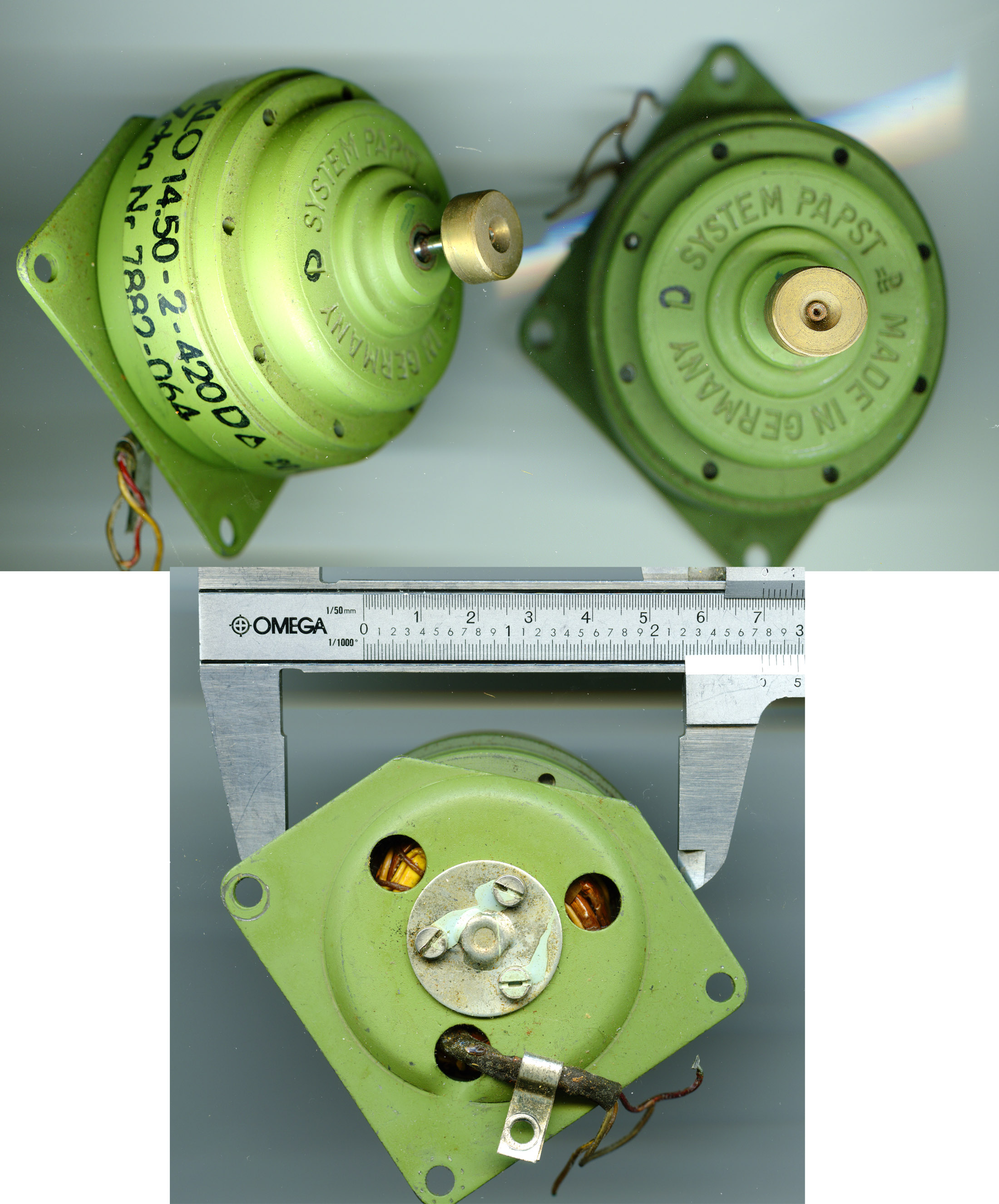

Papst motors
I may have the Papst motor you refer to but was told it was probably a two phase by another member...here is the original post... I purchased two green flywheel papst motors from ebay for possible use in a diy turntable project. I know nothing of them and got little info from the seller but the price was right...highest bidder at 16.50 cdn...I am looking to get a power supply/speed control for them...I will try to attach pics for these (original from ebay)...Motor numbers are as follows: KLO 14.50-2-420D followed by a triangle symbol...second line reads as follows: 7cha Nr 7882-064...what type of motor is this AC or DC?..could these possibly be 3 phase?...no indicaton of voltage, frequency etc...any info or help would be appreciated.
Attached Thumbnails http://www.diyaudio.com/forums/atta...urntable-drive-system-motor-thread-papst2-jpg

The DC motors I have come across all need a feedback loop of some sort in order to maintain a consistant speed, whether this is an optical sensor on the motor, a hall effect sensor monitoring the speed of the platter, or a method of using the back emf of the motor. In addition brushed DC motors can also be prone to a small amount of cogging, but this is generally insignificant with the better motors having more poles. This type of motor is often driven at very low speed and low power compared with its rated value, this also keeps any noise at a low level.
There are 3 different types of 'AC' motors used with the SG4, the simplest being a sqirrel cage induction motor as used in the Thorens td124 (E50), the Garrard 301 and 401, and the Lenco GL75. In all these cases only one phase of the SG4 is used, in order to generate a higher quality sine wave than can be obtained from the mains. It is possible to use the variable frequency of the SG4 to obviate the need for the eddy current speed control for the 301/401 or td124, but as the motor is not synchronous there may be some drift as the motor warms up
The SG4 can be used to generate 2 phases 90 degrees apart, which would allow it to be used with many belt drive turntables that use the Premotec, Hurst, or other similar 2 phase motors. The ability to adjust the output phase and voltage allows these motors to be optimised in a way thar cannot be done with the simple capacitor phase shift usually employed. In addition these motors will normally allow the SG4 to generate 2 different frequencies that will remove the need to swap the belt to another pulley.
Unfortunately these motors rarely allow the vibration to be reduced to a near zero levels, but the motors are such low power devices that any remaining vibration is at a low level
Another type of motor that is used is a Brushless DC motor, usually referred to as a BLDC. These are similar to stepper motors, but are designed for electronic commutation with a sine wave signal, thereby making them a type of 3 phase synchronous motors. They are quite efficient, and with good bearings, can provide good torque characteristics
They also have the advantage that they are generally low voltage motors and do not need high voltage amplifiers or transformers to operate.
The last type of motor I am aware of that is used in turntables, at least in belt drive ones, is the Papst external rotor 3 phase Hysteresis Synchronous motor. This motor is the least efficient of the AC motors, and needs 115 or 230V to operate. It does have 2 significant advantages over any other of the AC motors that I am aware of:-
1. There are no permanent magnets in the motor, so there is zero cogging, in addition, being a 3 phase motor there is an absolutely constant torque, a feature that is not possible with any of the other motors (AFAIK). This, inconjunction with high quality sleeve bearings produces the lowest amount of noise/vibration.
2. Being an external rotor design the motor has a high polar moment of inertia, which means that the belt is the limiting factor in achieving ideal drive characteristics.
The only downside of the Papst motor is the fact that it is only available secondhand, having not been made for many years.
