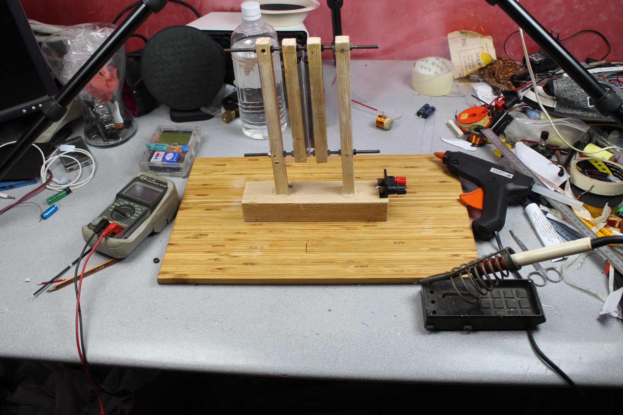

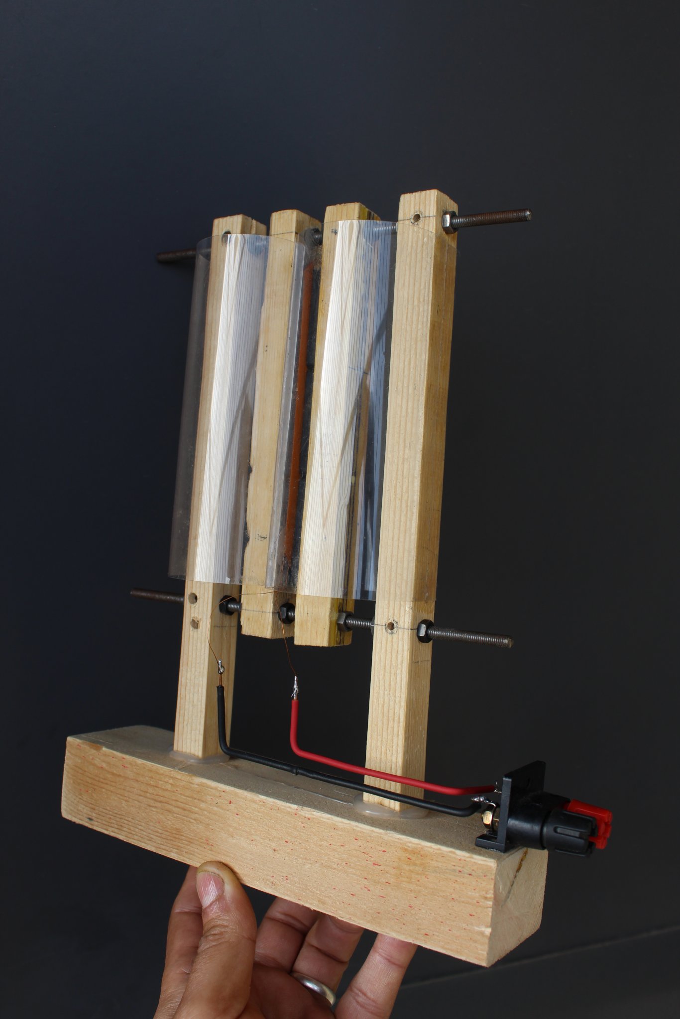

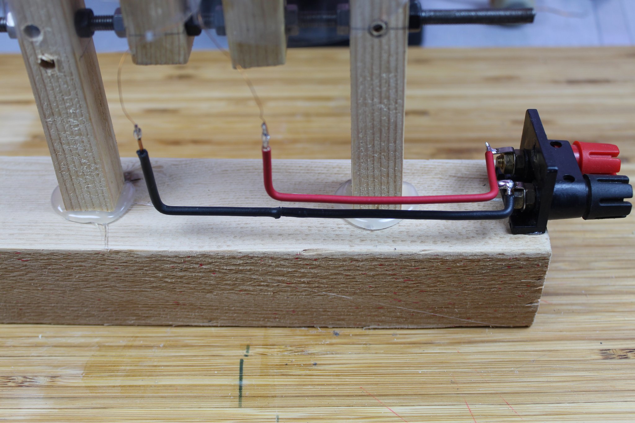

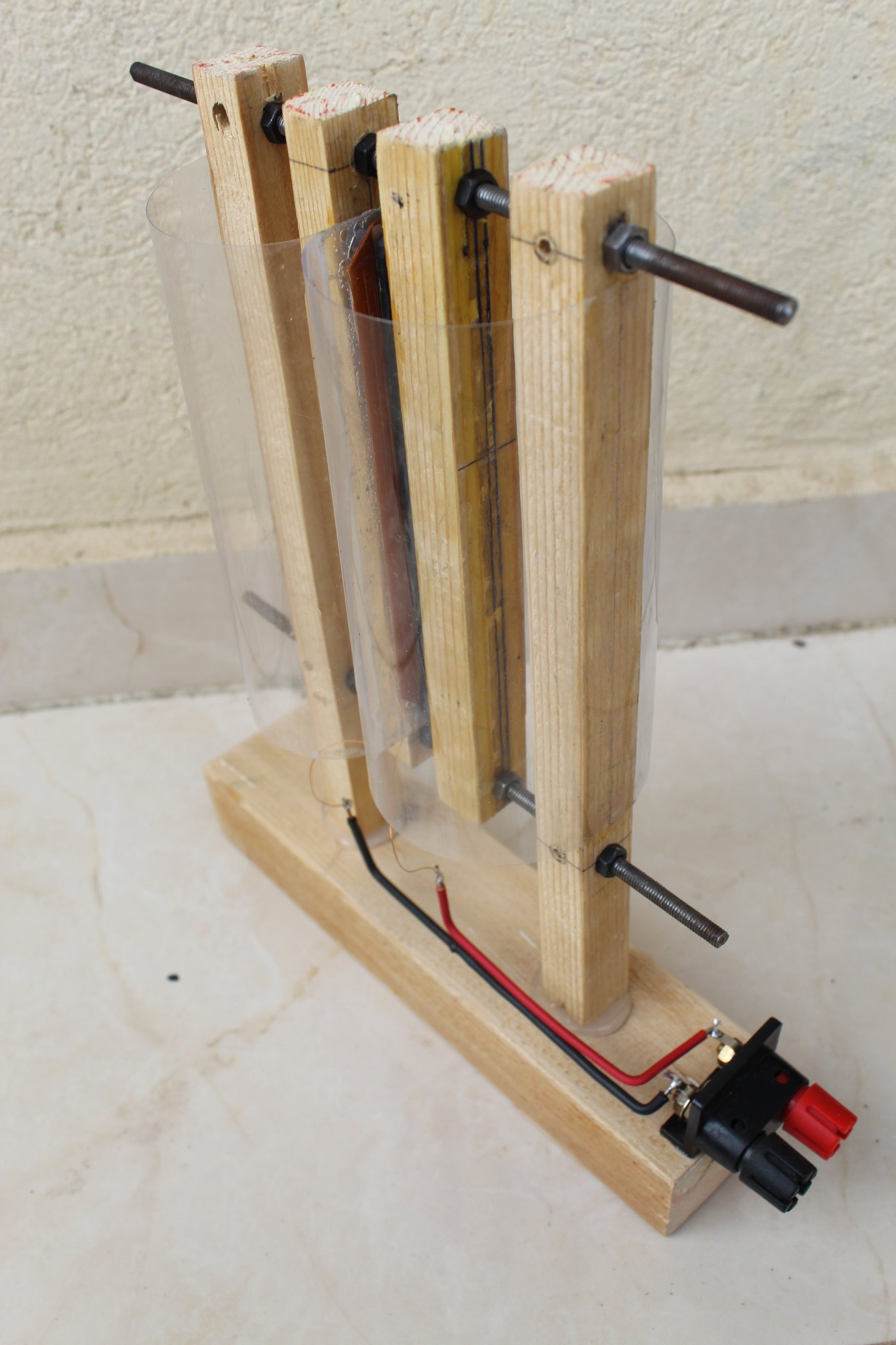

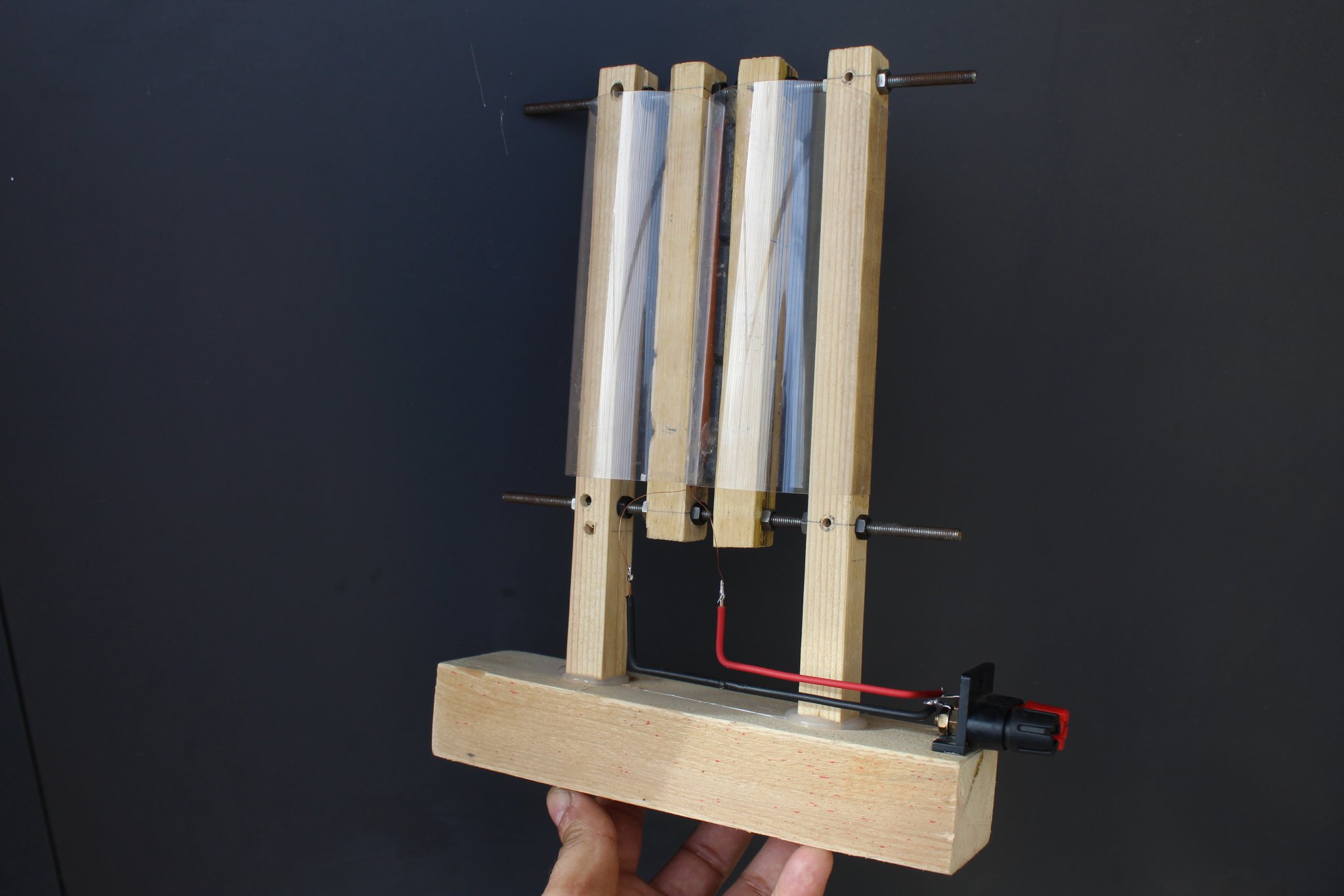

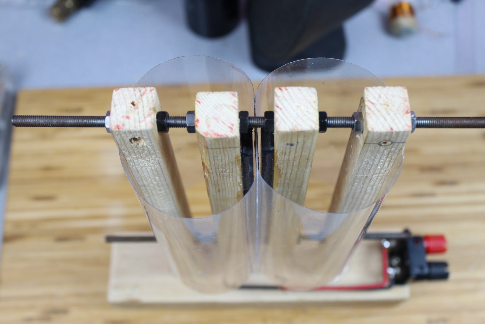

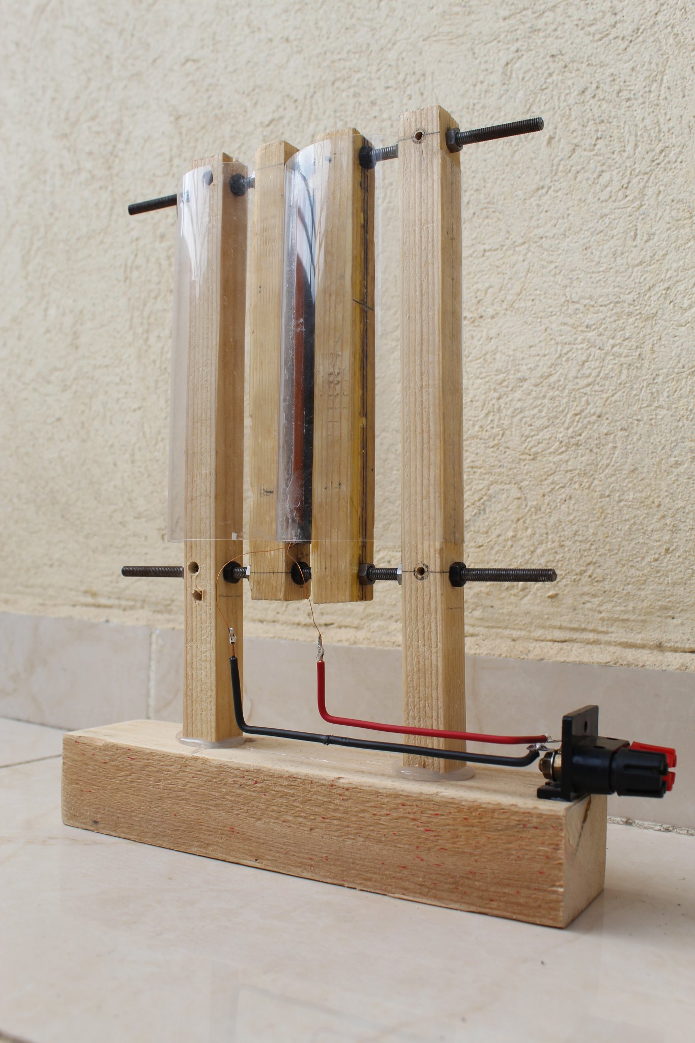

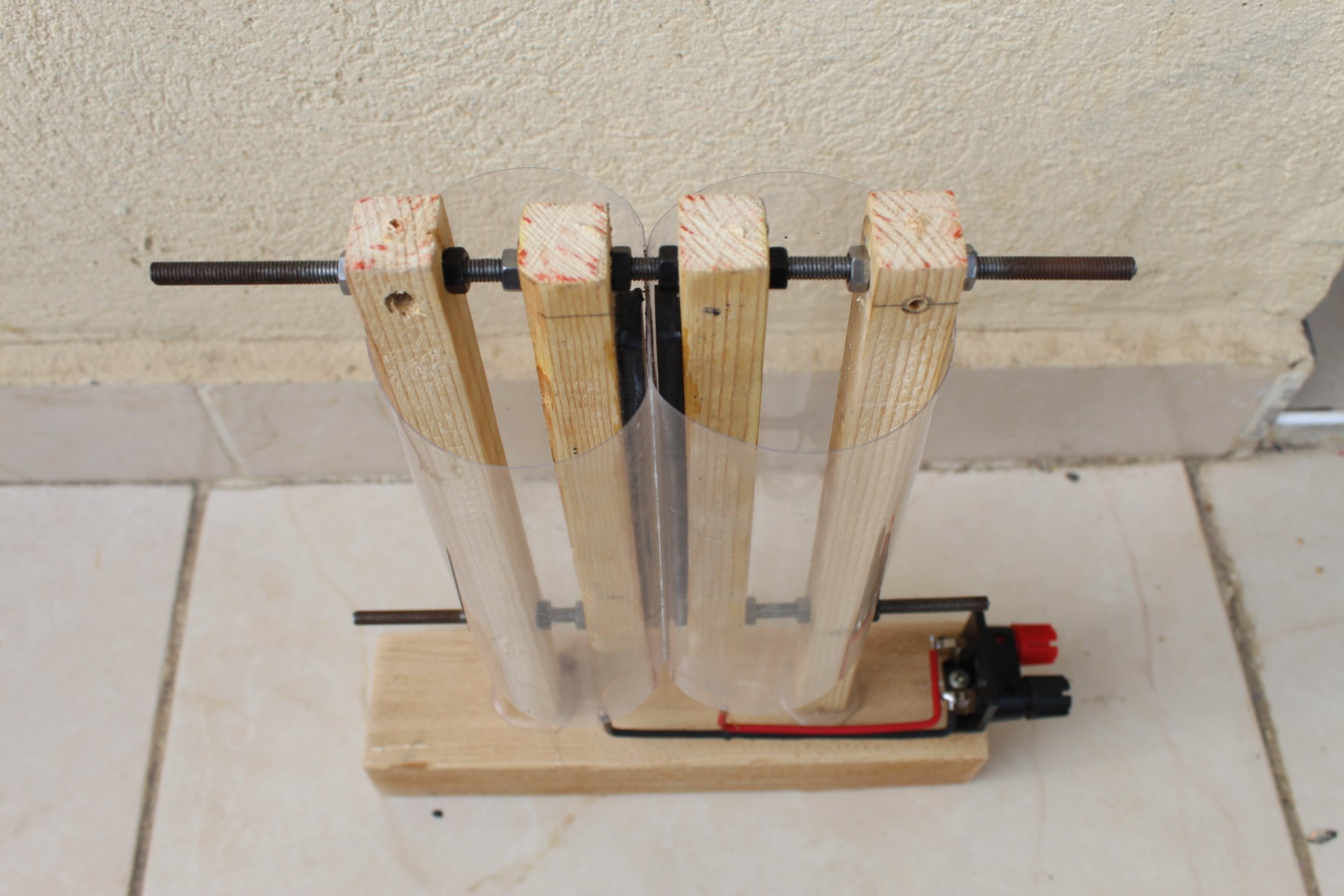

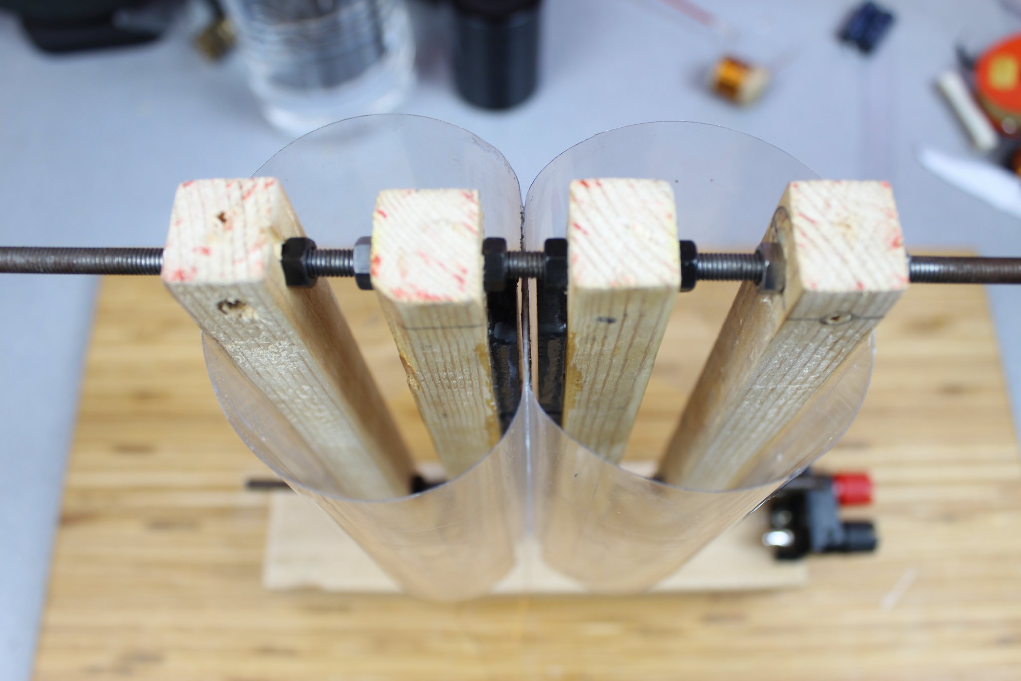

I present to you today a somewhat bizarre project, it is a ribbon speaker inspired from an old tweeter used by the linaeum company in two-way speakers.
In my model I changed the size of the ribbon and its material, I tried several materials before deciding to use plastic as ribbon because it sounds better than other types of paper.
The project is very simple and easy to do, the correct name of this speaker is Rubanoide speaker.
the speaker has no cabinet but it can plays the sound loud down to 150hz very well like a a small full range speaker, the reproduction of midrange is really very impressive and clear.
you will find attached the photos of the project as well as the link of the video which shows all the stages of manufacture in my youtube channel where you will find other audio projects.

Hello Steve great video did you take the measurements? 150 Hz is very low for such a small rubanoid? Where is the plastic membrane from? How thick is it and what is its weight per square meter? Greetings

I am novice in this field and need some help here, I just followed your instructions and created these with similar materials like 32guage copper wire approx. 35 rounds on a cd case, 200 microns acetate sheet etc which were available at my home. But the sound I am getting is too low (really hard to hear). Please help in troubleshooting the problem. Thanks in advance.
@peril
please write in English.
I've translate your message here below:
"hello ankit....

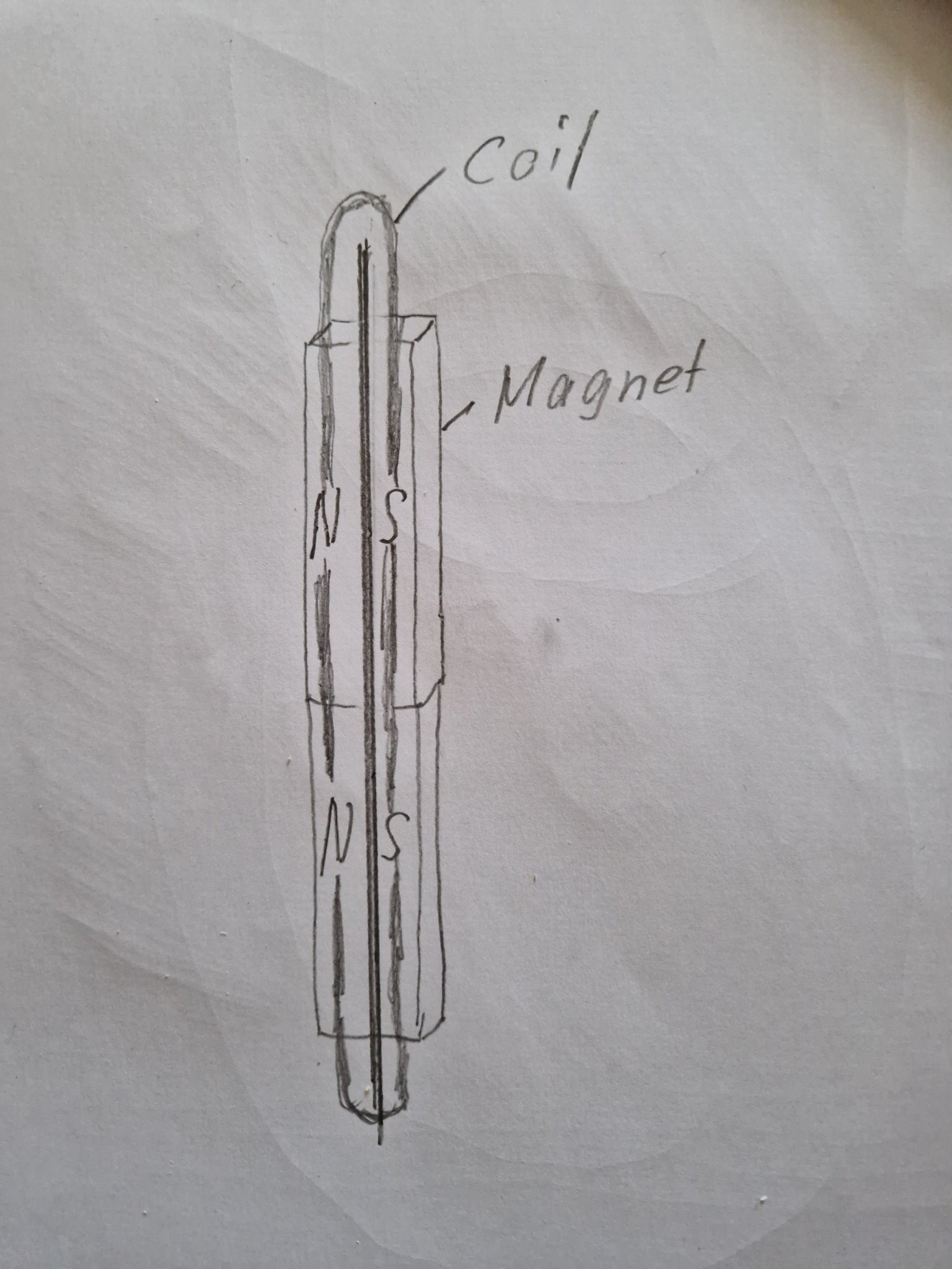

Hello, maybe this is your problem? the magnetization must change due to the direction of the electronic current.
Greetings"
I agree with Peril, you may have a magnet phase problem. Those little buggers are always flipping over and spinning around.I am novice in this field and need some help here, I just followed your instructions and created these with similar materials like 32guage copper wire approx. 35 rounds on a cd case, 200 microns acetate sheet etc which were available at my home. But the sound I am getting is too low (really hard to hear). Please help in troubleshooting the problem. Thanks in advance.
Other than that I would guess you have a short in the winding. Use a meter to check the windings.
