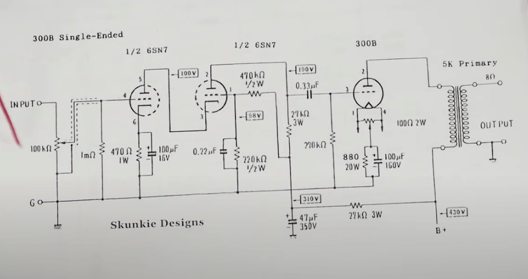

As above, I've always been happy with point to point. But I'm a fan of "long tubes life". I go with those who prefer a 300b dissipation of 25W or even 18W. In fact I prefer to use 2a3s myself at 15W, or EL12n at 18W.
Right, the extra cost of the rectifier tubes is also a concern for me. But don't forget the extra power coil and circuit for soft start of this tube if you want to extend the life of this tube. They also complicates the overall circuit.This is a choice / some spend more money and use rectifier tubes for 300b singles. You must know that we have expensive tube rectifiers. This type of power supply does not have many parts. And it is not necessary use pcb. 300 b It is an amplifier for sound quality before targets such as making it comfortable and long tubes life.
Even with the use of a rectifier tube, the B+ is not regulated, I still need to use a LM317, so it doesn't help a lot. I'm doubtful if anyone can hand wire nearly 200pcs of components ...

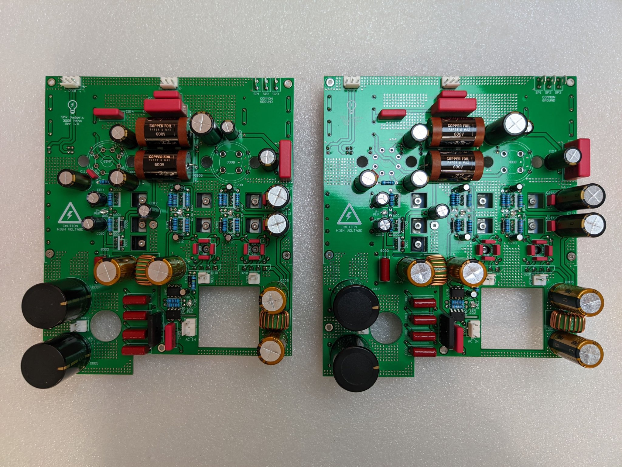

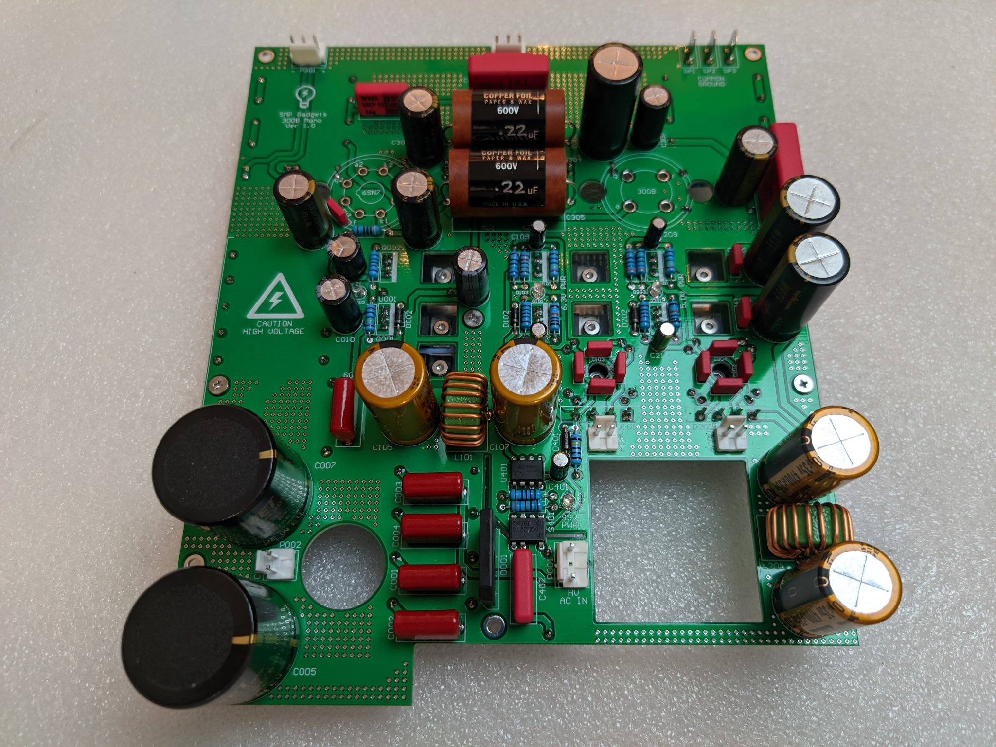

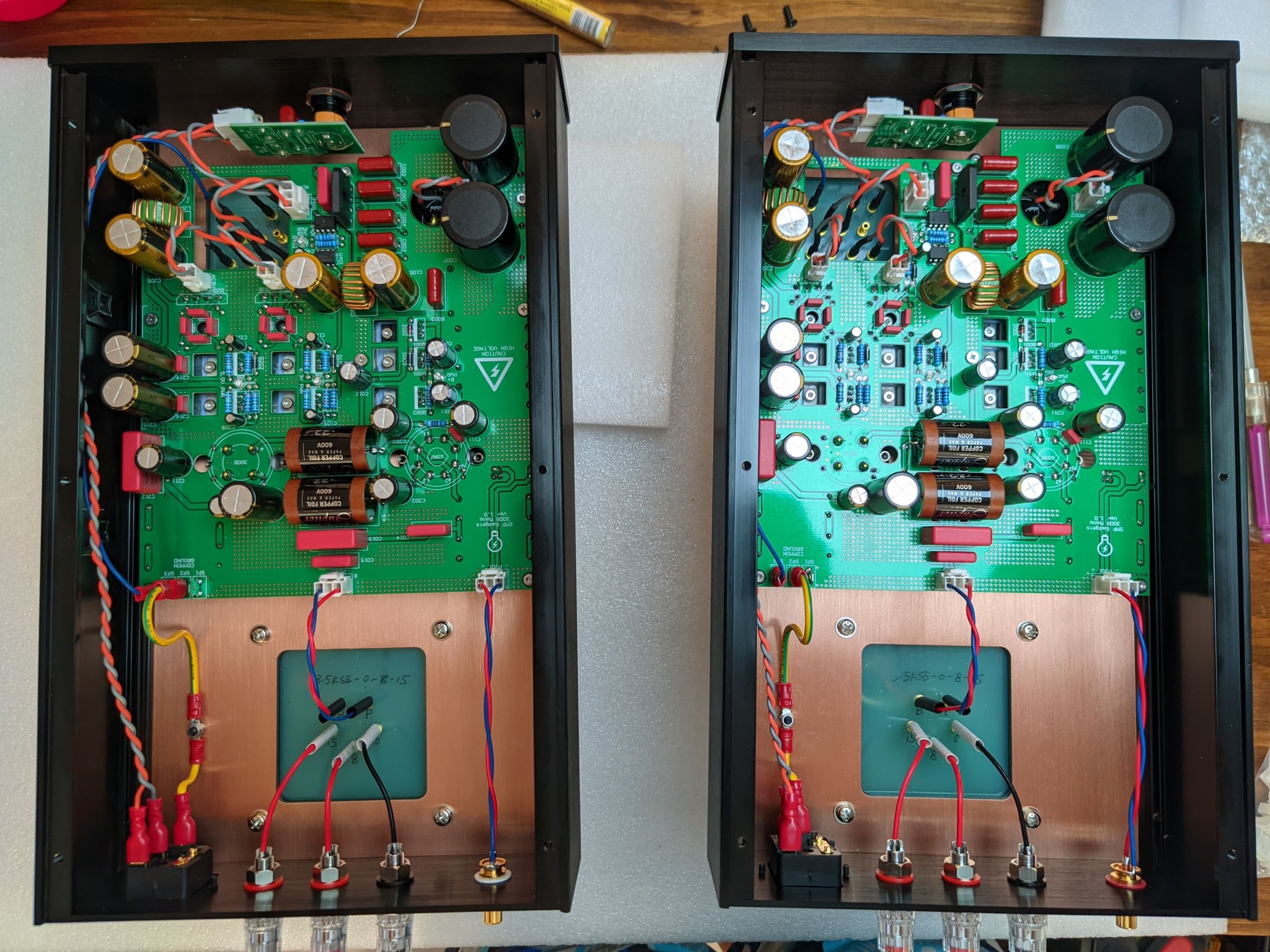

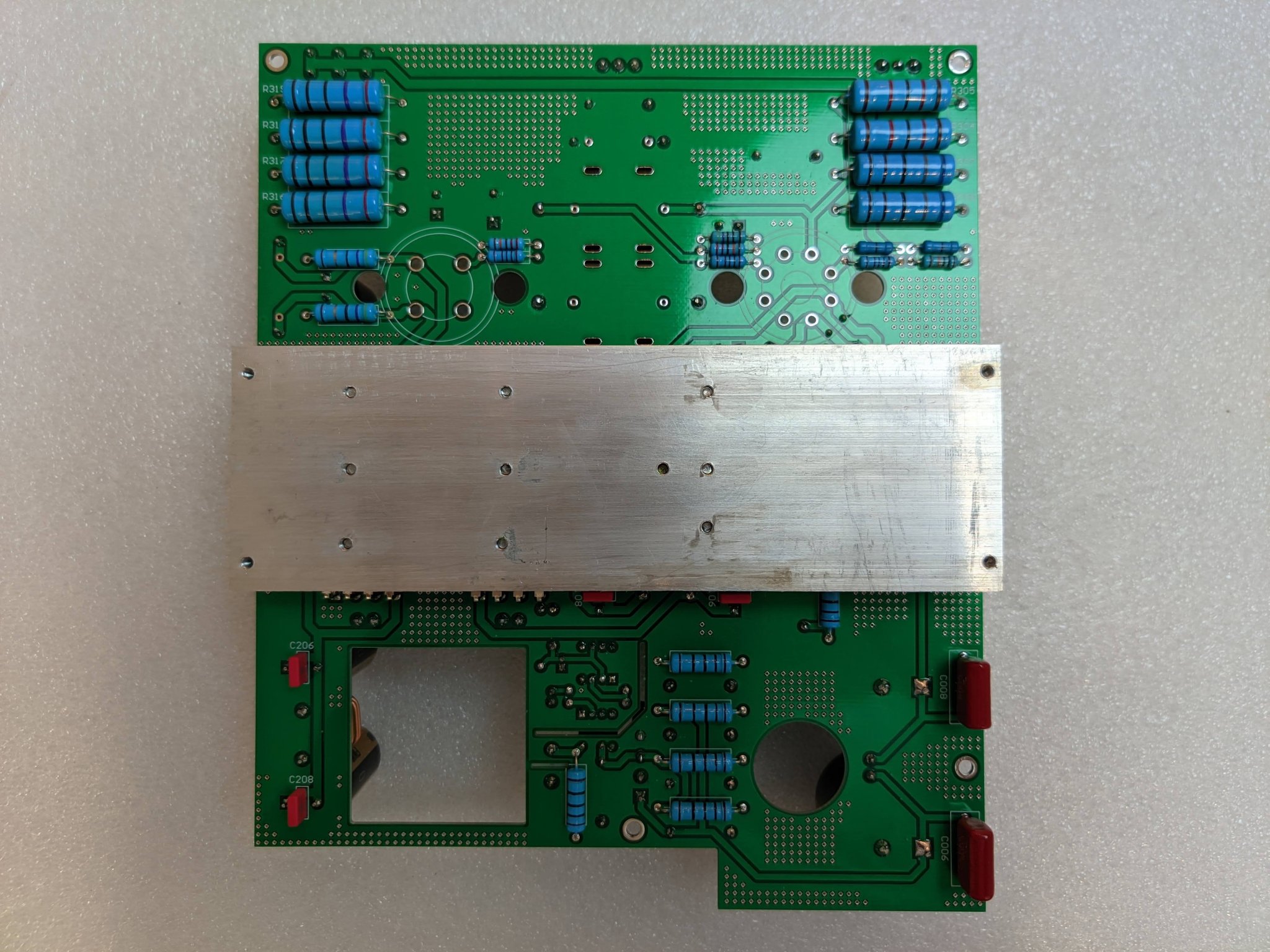

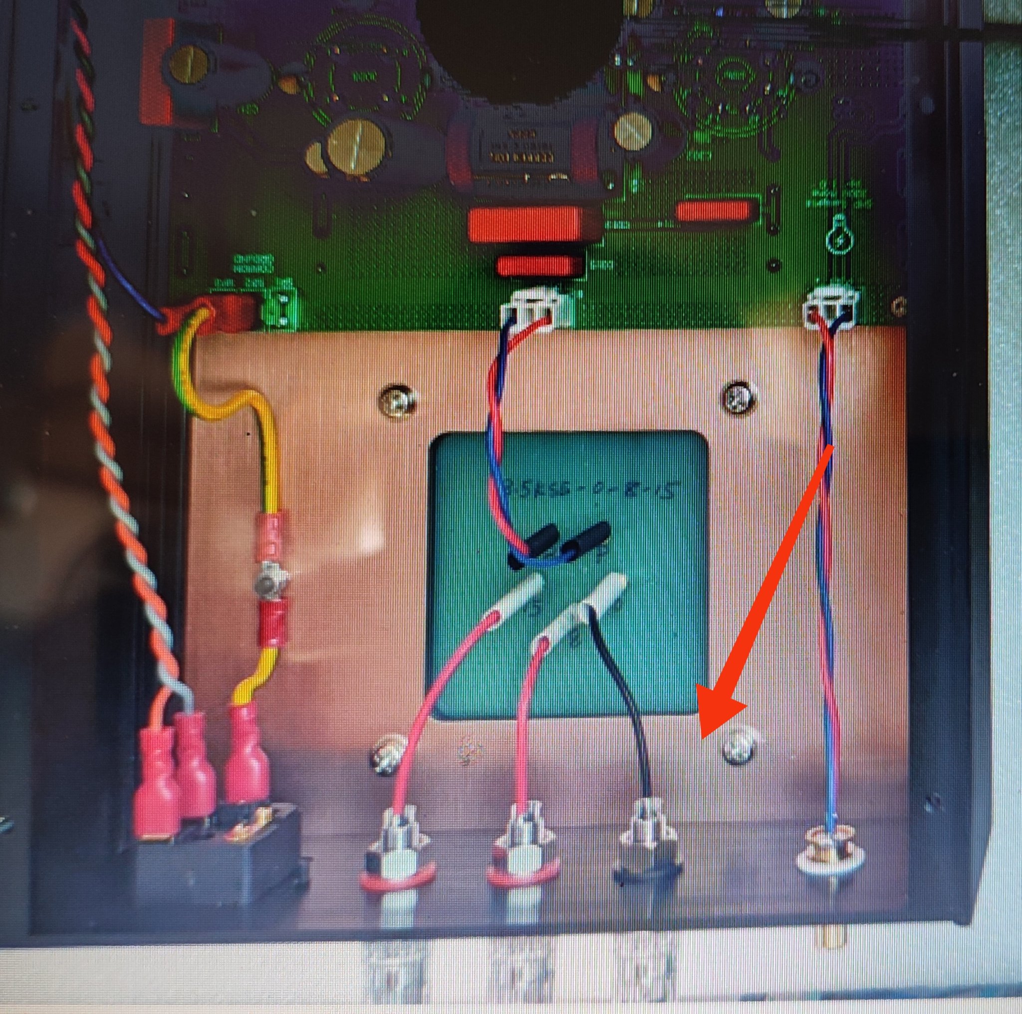

Hi folks,
Following my first 300B monoblocks built in 2021, I'd like to share my latest 300B monoblocks built in 2023.
Features Highlights:
-5.5W effective output from each channel

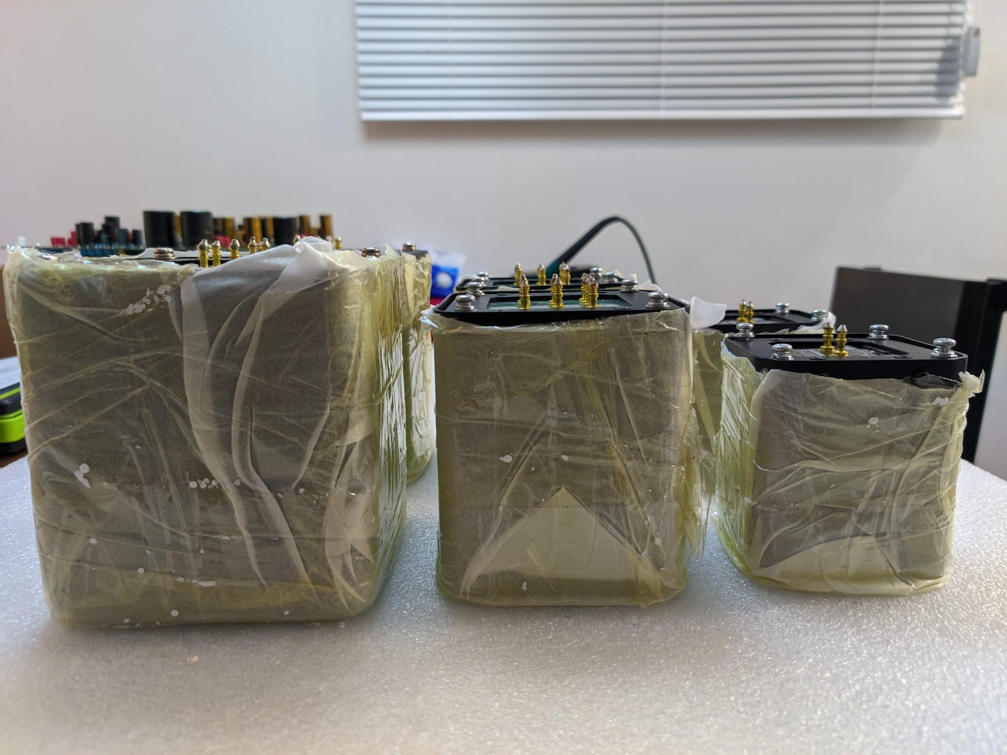

-Each block contains an 100VA Power transformer, an 10H choke and an 35W output transformer

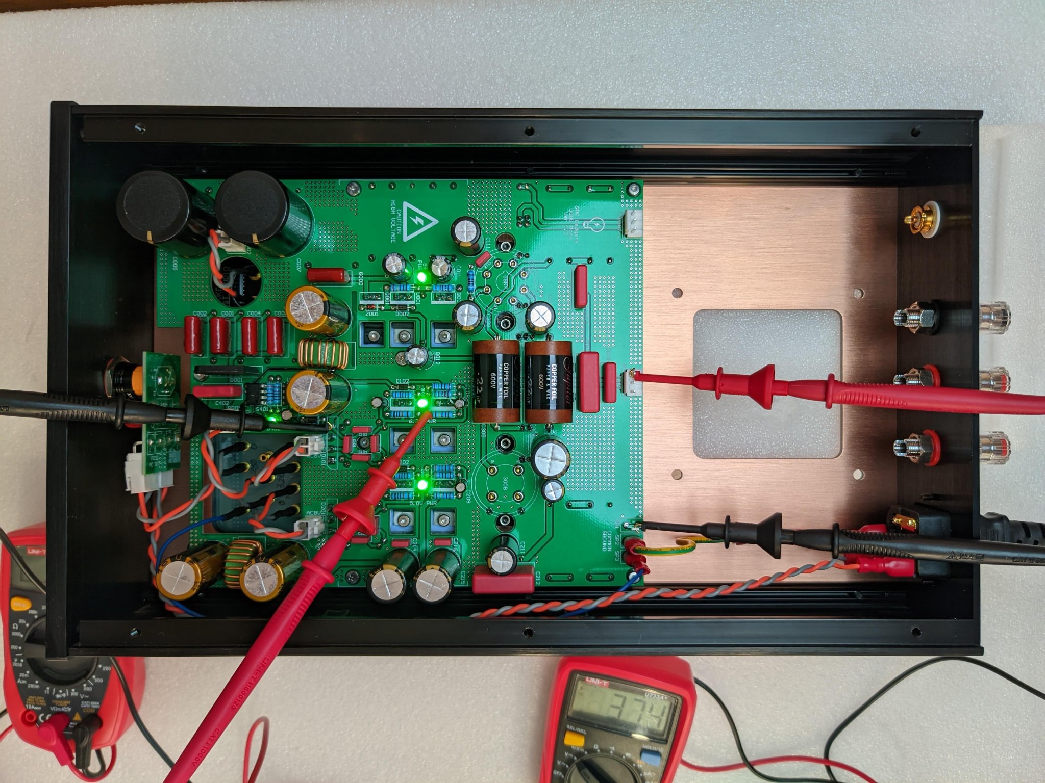

-All of the B+ and filament voltages are regulated by LM317
-Soft start for filament voltages (to prevent inrush current from damaging the filaments)
-starts from 1.9V to 5V and 6.3V in 10 seconds
-Delayed soft start for B+ (to pre-heat the filaments before supplying B+ for prolonged tube life)
-starts from 20V to 376V in 30seconds after 30seconds delay upon power ON
-Timer function achieved by 555 IC
-Solid state relay for B+ for prolonged life
-Zero-crossing detection (achieved by the solid state relay)
-Plenty of RC snubber networks used to reduce damping and noise

Because they have some features that others do not have:why 300b amp need 200 pcs components? can send soft start circuit?
You can actually refer to the application note of LM317 from TI, there is a reference schematic for soft start (i.e. slow turn ON).
DISCLAIMER: High voltage can be lethal, I'm not responsible for any damages that result from the use of this schematic.

How reliable are these switching mosfets under linear operation? These are 10ms champs in the SOA but how do they do at 200mA 400V?Because they have some features that others do not have:
https://www.mouser.com/datasheet/2/389/std3n62k3-1850520.pdf
