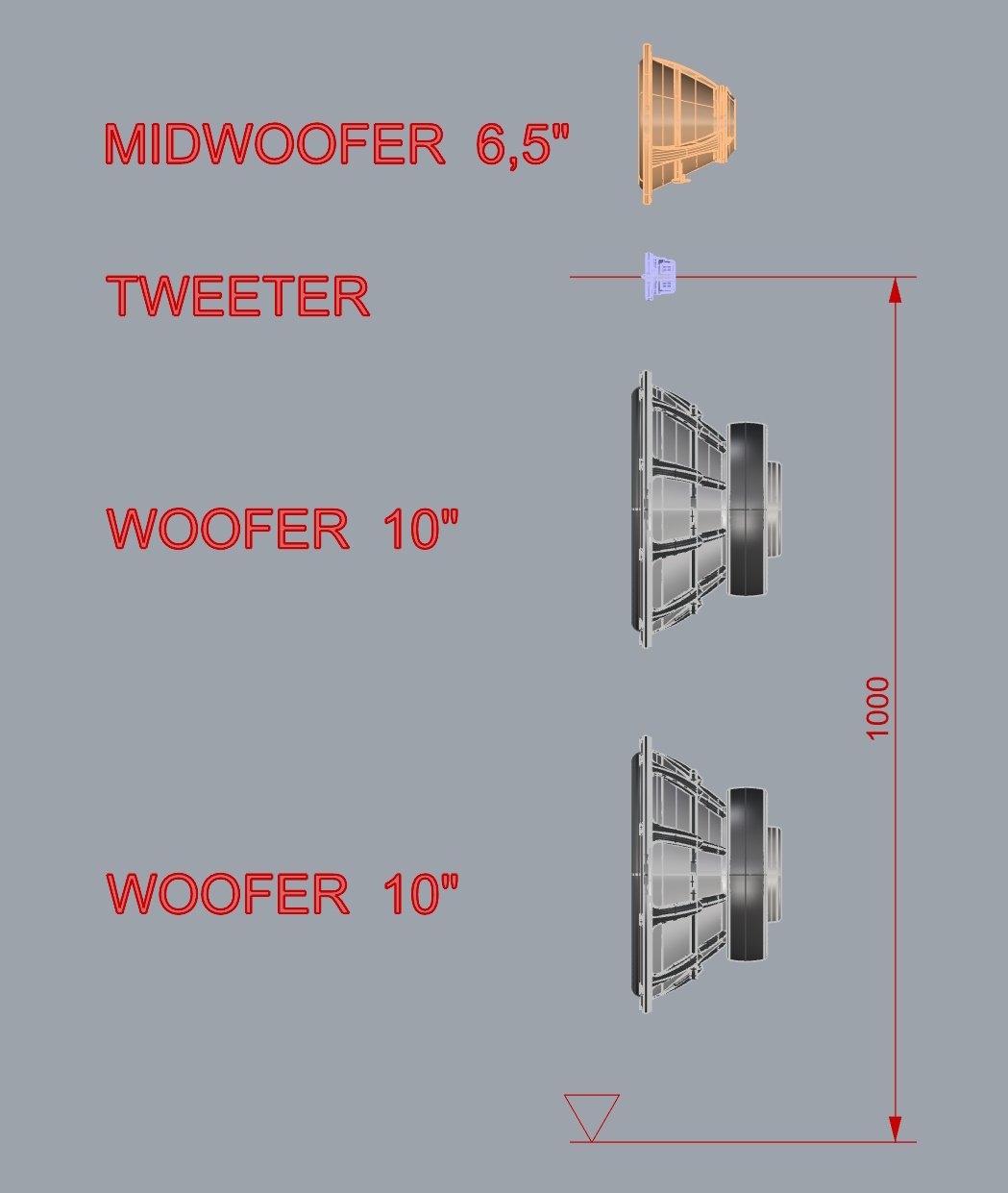

I would like to build a pair of active 3-way floorstanding speakers using 2 HYPEX FA253 modules. For design reasons, the circuit I need to follow is approximately that of the attached image.
What would be, in your opinion, the best combination of drivers (brand and model) that I could choose and find in Europe?
The speakers are intended for a home environment of about 60 square meters. Someone has already shown me that a higher price for the driver does not necessarily correspond to better performance.
True, using the HYPEX modules would allow me to choose three different types of drivers, but at least the woofer and midwoofer should belong to the same product family for aesthetic reasons.

Depends on what's available and your priorities.
Looking at your proposed speaker, my thinking is that the tweeter to mid x-over is going to be important. My suggestion would be to consider a 5.25" driver similar in performance to the Peerless HDS GFC driver. (It's not available, but I like mine. ) https://www.parts-express.com/pedocs/specs/264-1074--tymphany-hds-p830991-spec-sheet.pdf It's very smooth, and I crossed mine passively, with shallow slopes to a nice Morel tweeter at about 2k. This speaker is a sealed 2-way, that is crossed to a sub at 80hz. So, I picture your situation as similar. Your 4 tens can cover 200hz, and lower about the same as my sealed 15" sub. A 5.25" from 200hz and up, should be good for reasonable SPL, and well suited for a 2k x-over. I think the Morel tweeters are excellent. I like shallow x-over slopes, although steeper probably sounds just as good, if done well.
I can play music at 90dB cleanly. You may want more. It's all about compromises. To play louder, you may need a 6.5", but you may need a really stout tweeter too

Run with that and pick something you like. Kartesian and Scan-Speak are European companies. SB Acoustics is Indonesian but readily available in Europe through TLHP. Those three companies - at a minimum - make attractive driver families. You're not lacking for choice at all in Europe.

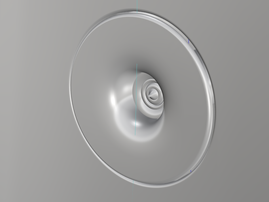

You'll probably have a waveguide if you're crossing down to a 6.5" so it might be easy to go with one of the tweeters Augerpro designed and tested waveguides for. Unless your tweeter is a compression driver, then you might want to custom design one with ATH. A smaller diameter mid gives you more flexibility in using a stock tweeter without a waveguide at the expense of LF output from the mid. And you don't have to use a waveguide with a 6.5" or even larger woofer. It's just common to start using waveguides as you midrange gets larger. Once you start using waveguides the visual aesthetic is dominated by that rather than how the company designed their faceplate.

This is my idea of tweeter installation (currently a SCAN SPEAK model). It is housed in a rather short waveguide and integrated into the front panel, the guide will have the possibility of a small mechanical rotation of a few degrees in the vertical plane."ma almeno il woofer e il midwoofer dovrebbero appartenere alla stessa famiglia di prodotti per ragioni estetiche."
