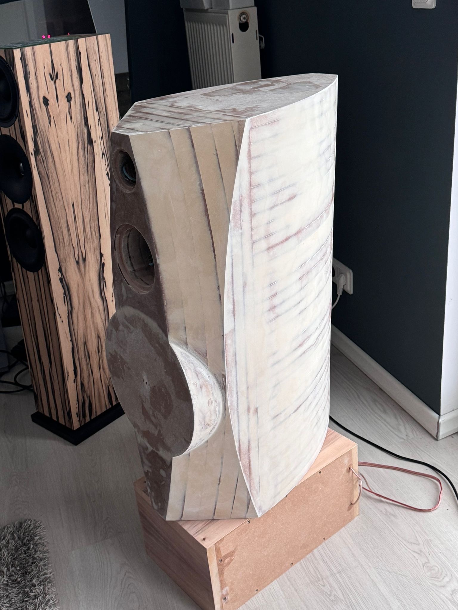

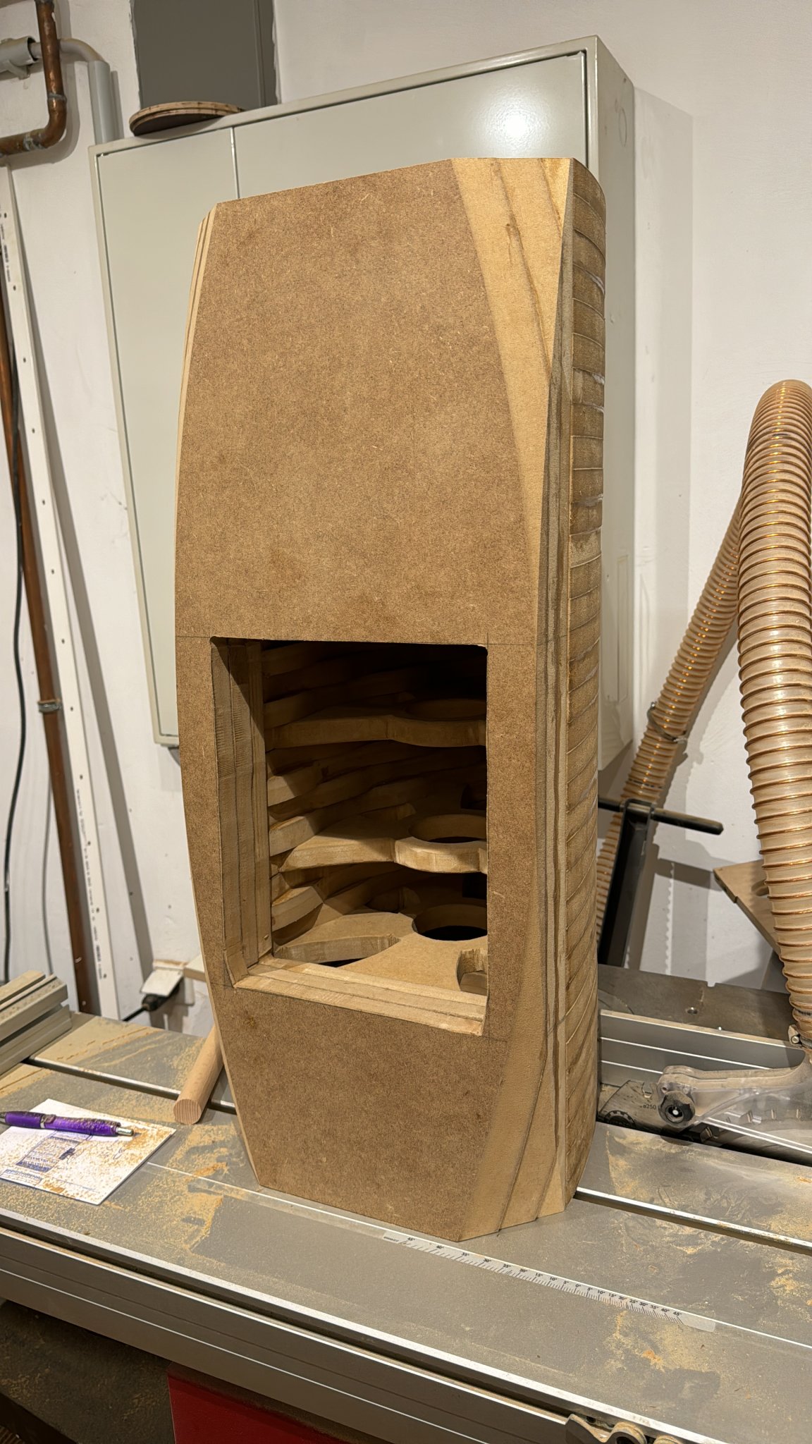

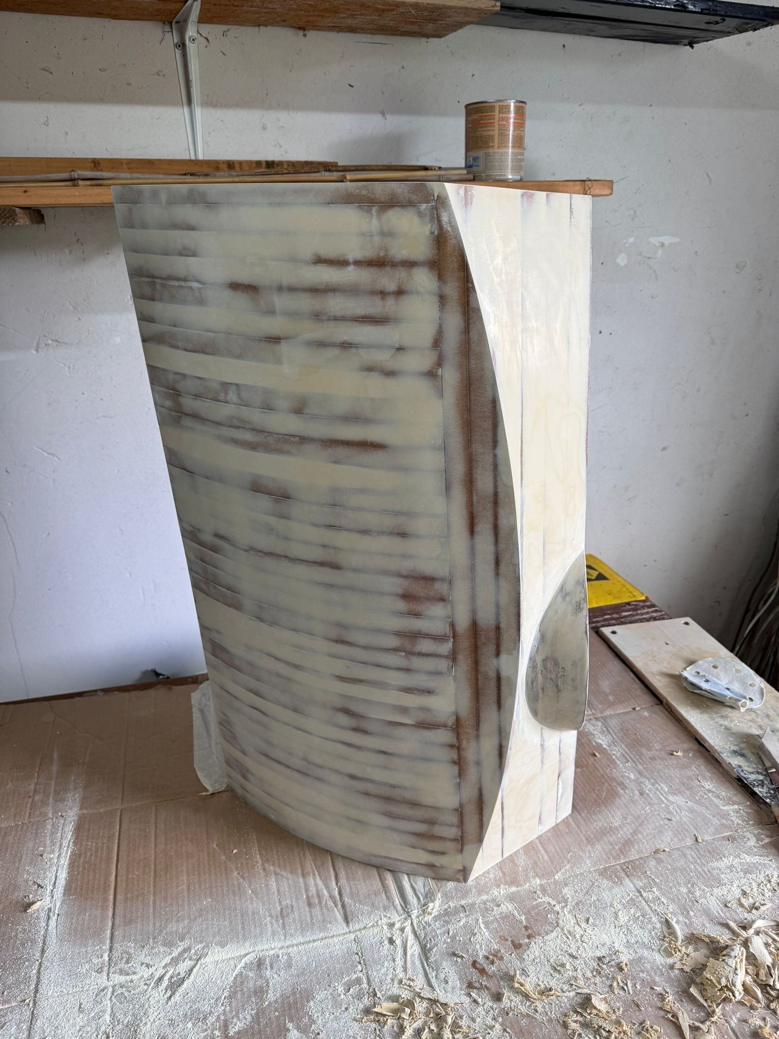

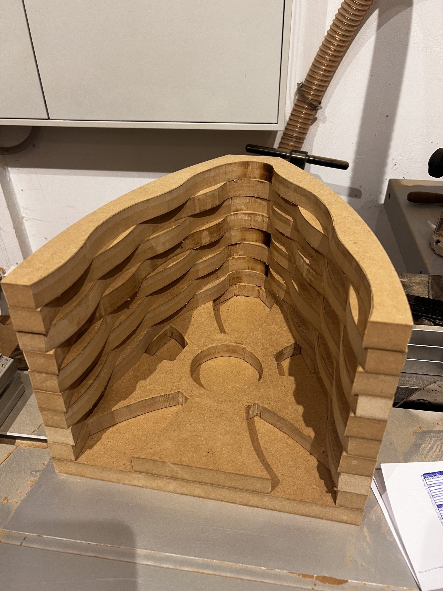

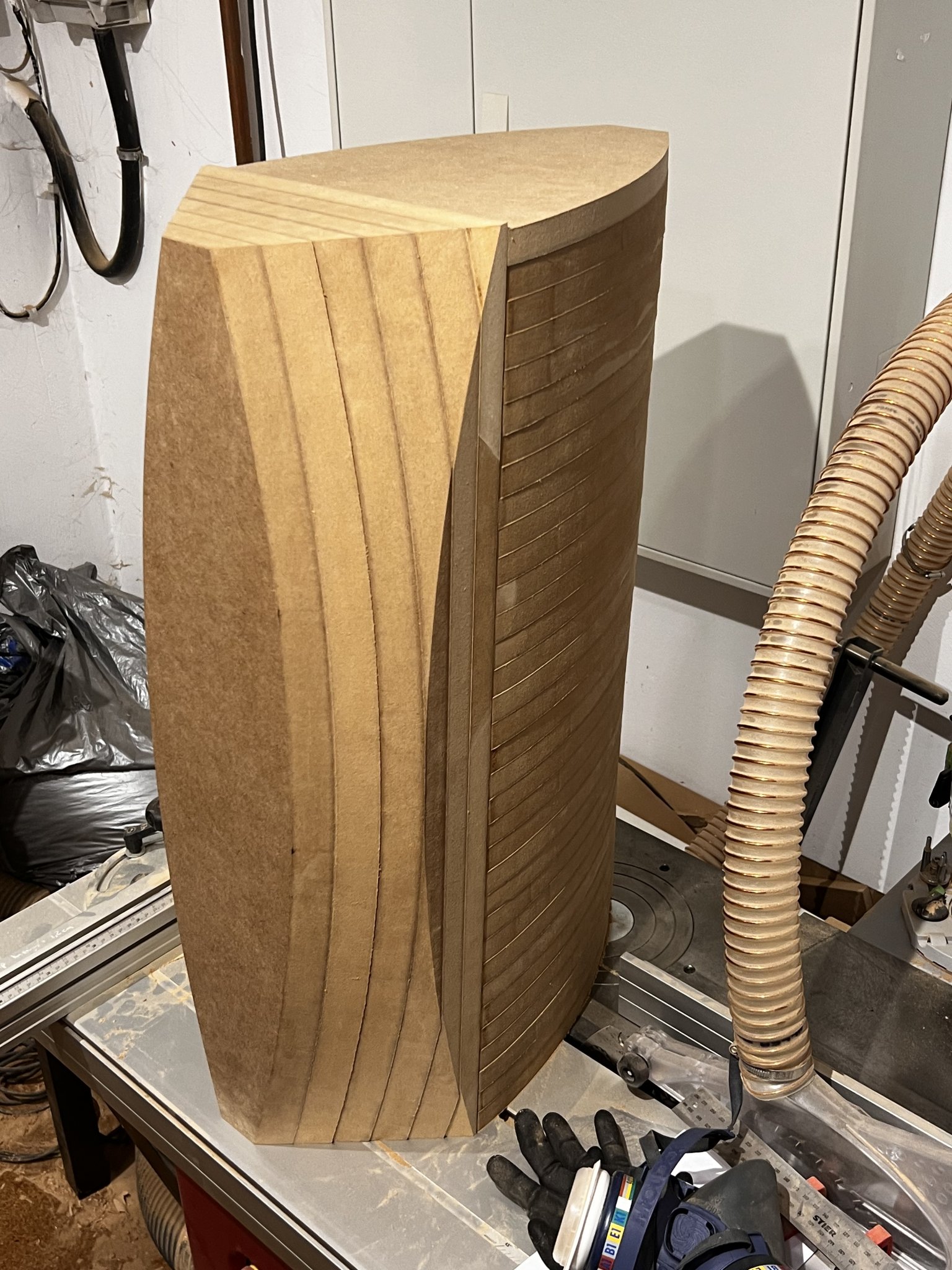

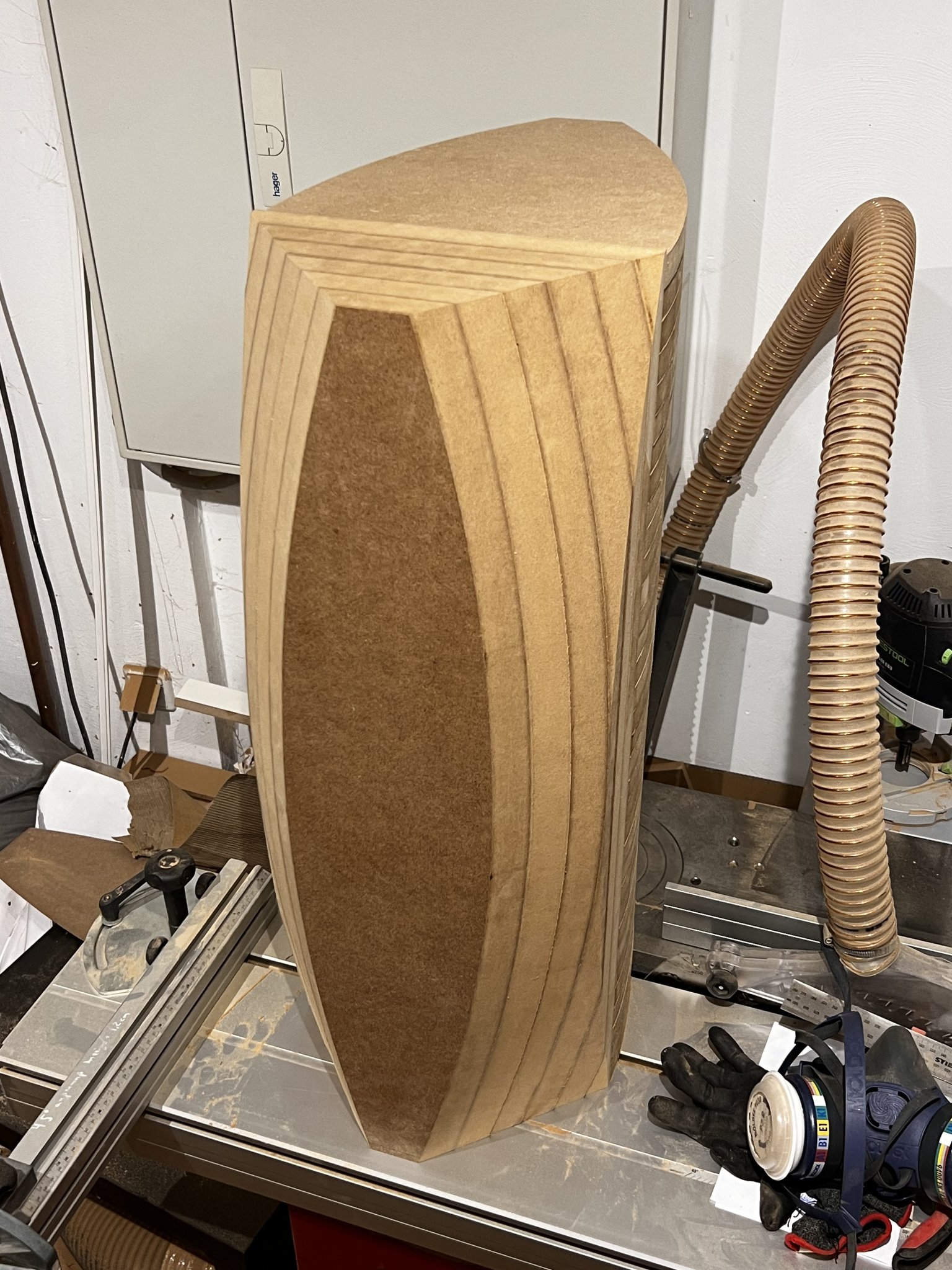

Last weekend I just finished more parts for the cabinets (pictures attached). I did some internal waves on the "Ripps" of the cabinet, like I saw in a other build. Maybe it will help with resonances, maybe not. But it looks cool (sorry) and wasnt more work. The walls now alter between 19mm-31mm. I will also do some braces that connects top to bottom with 30-40% overlay between the braces and Weicon Flex 310 M as glue.

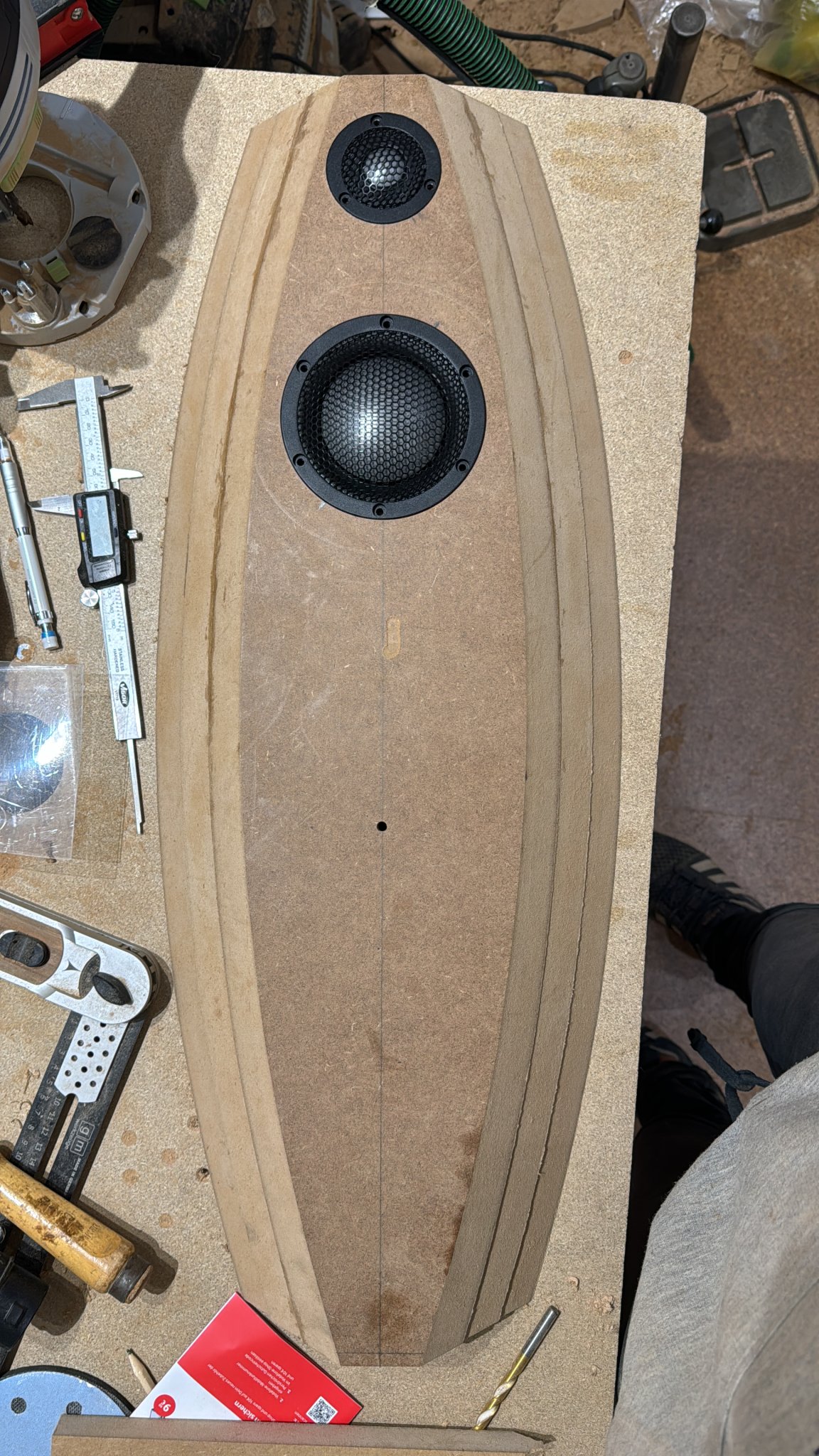

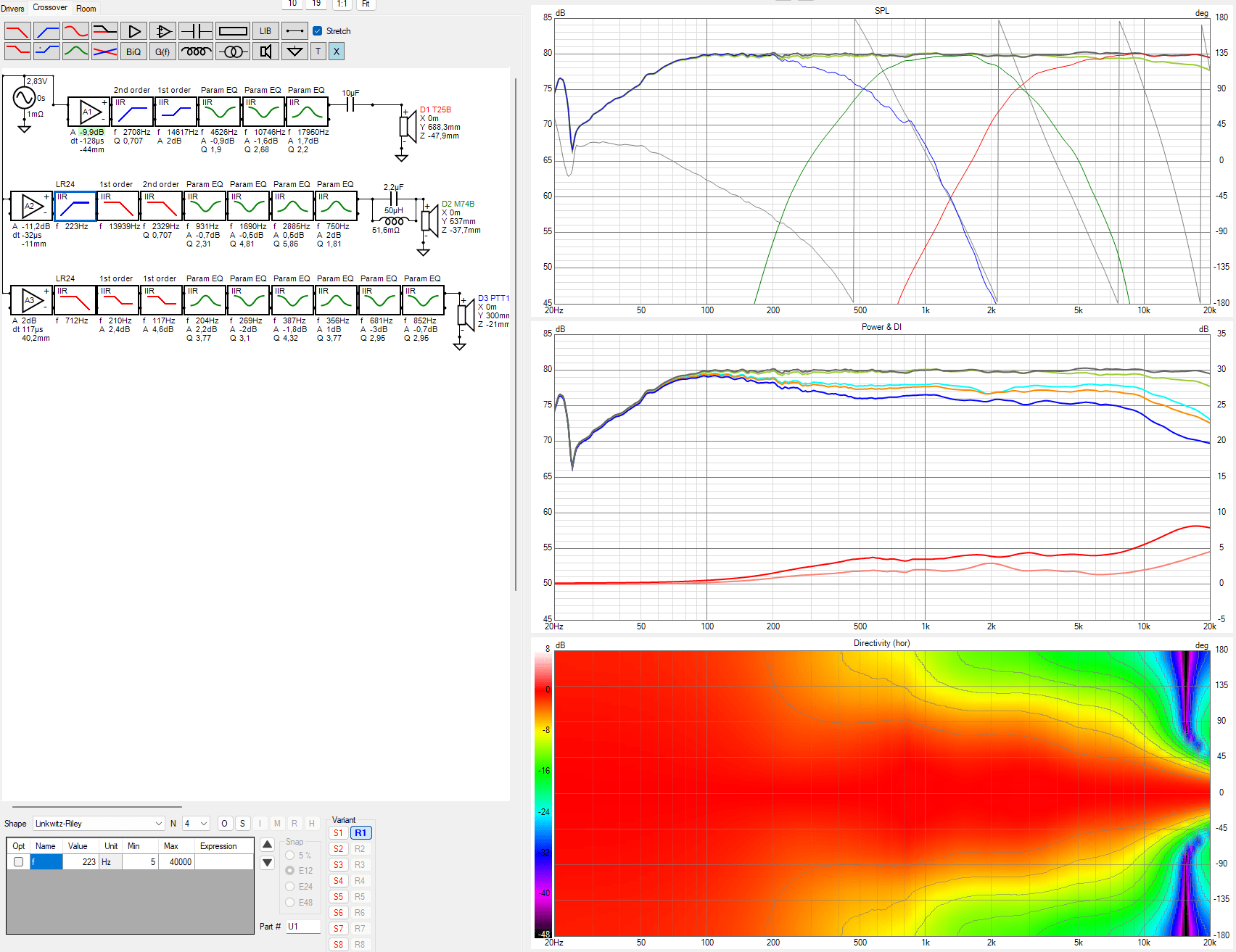

I tried some different things but the best results I could get, was with 1.2 c-t-c spacing for tweeter-midrange and a closer spacing with midrange-woofer. So in Hifijim/Kimmo I trust. Maybe the crossover is total ********? Here is the current state. (SPL adjusted to 80 db as a reference point)
There is a Dip in ER Total at 2k. The rest looks not to bad in my noobish opinion. (Just noticed the 1st order LP on the M74B is still in, its out now)

Somebody wrote me per PM that I should rethink my 0 Point for the Y-axis in VituixCad. Correct would be between Tweeter and Midrange. So I changed that. Tweeter now at 74,5mm, M74B -74,5mm and PTT10 -315,5mm. But without real measurements I dont see a point in posting the new crossover here. But its simpler now, less peq.

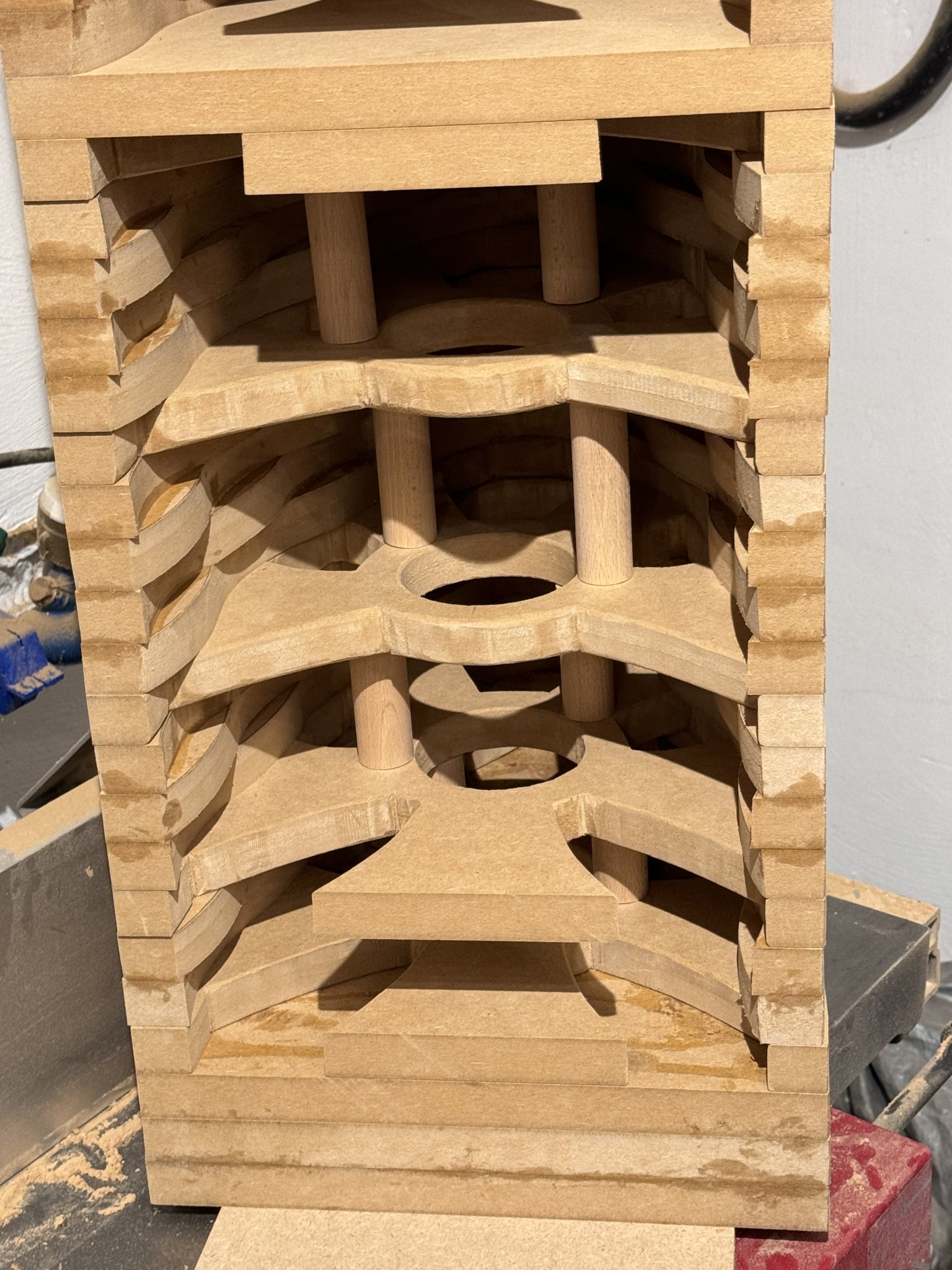

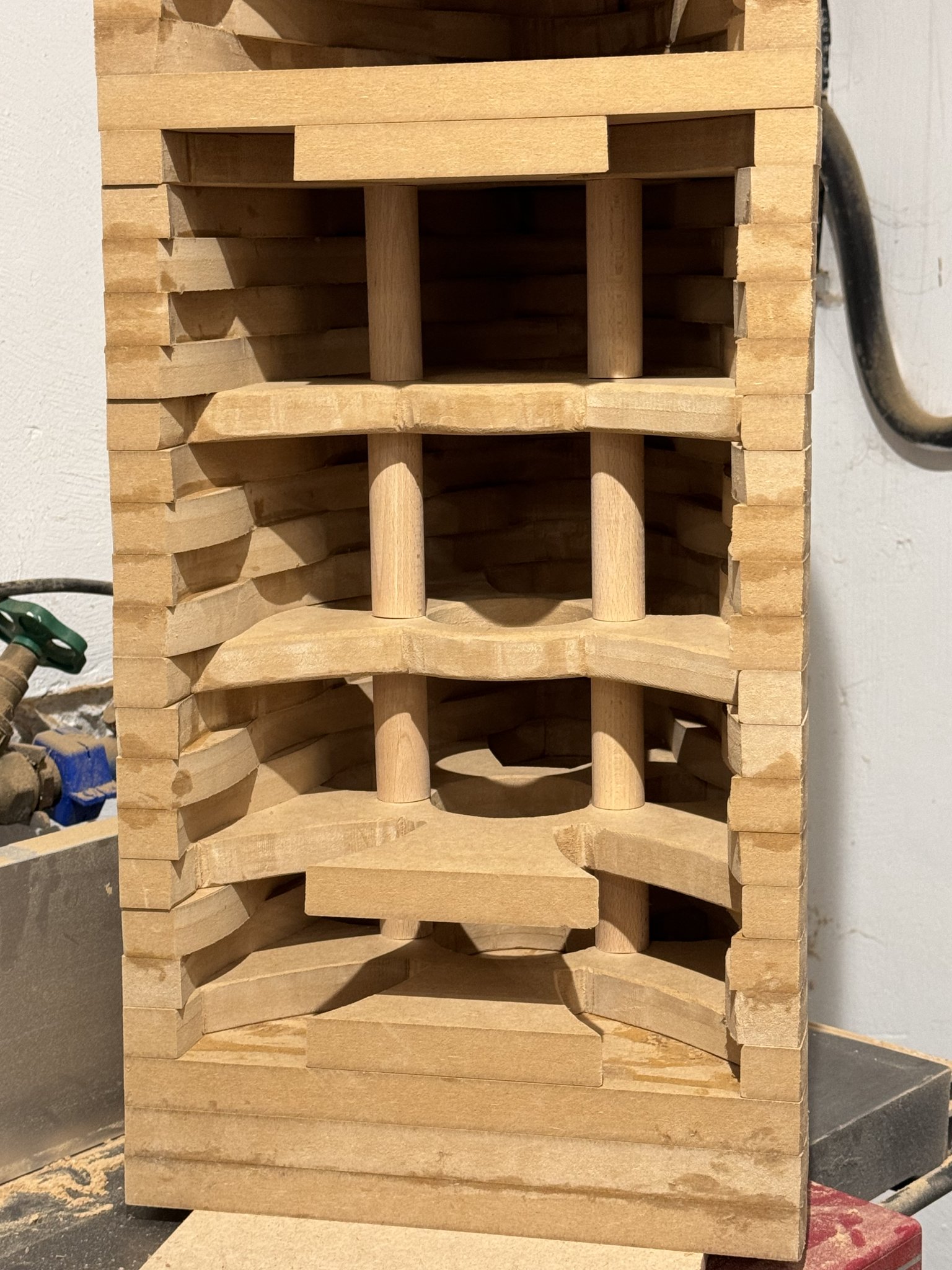

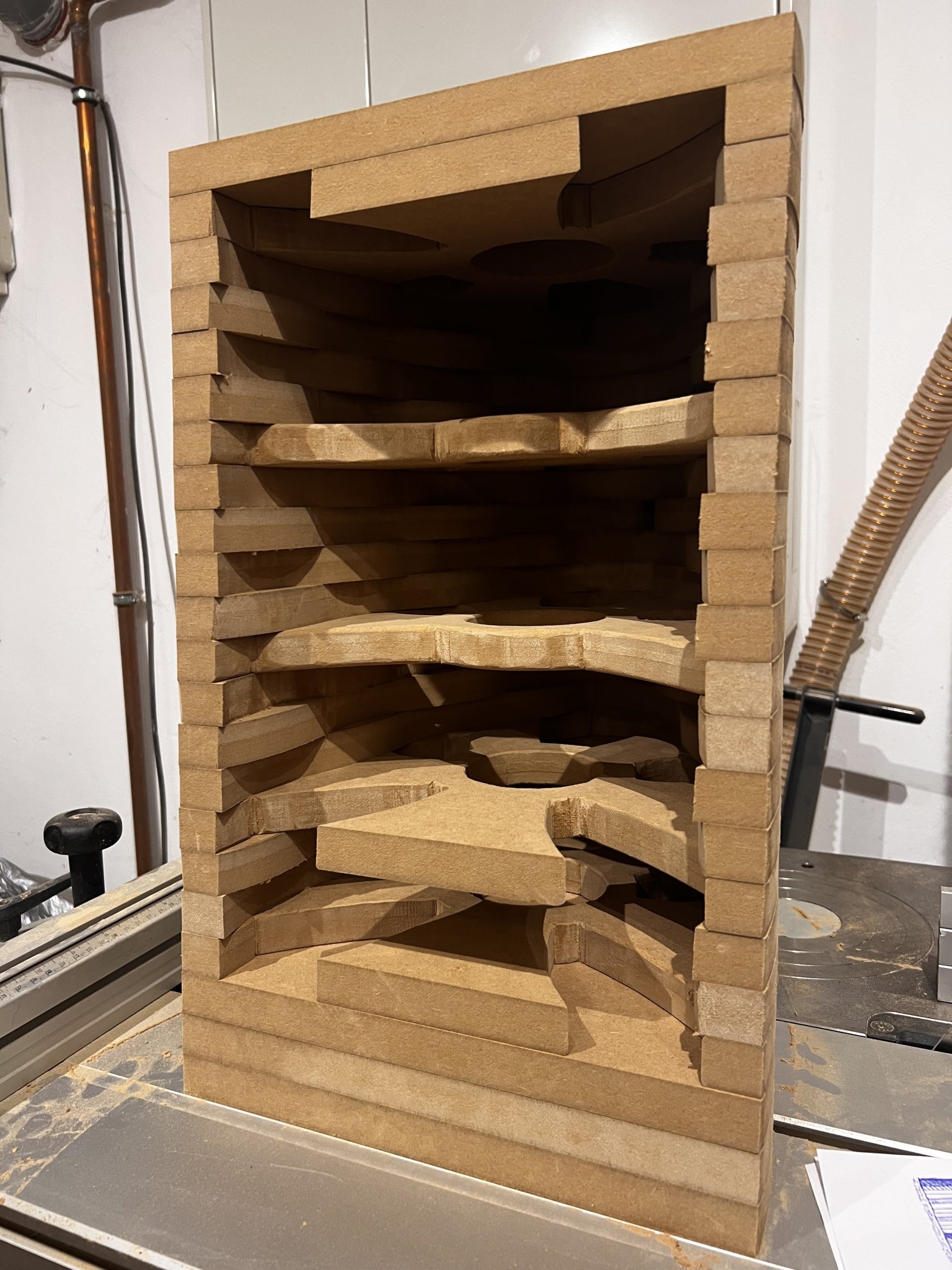

I want to add some top to bottom bracing for the bass cabinet. But not to much. I have some massiv beech wood sticks as leftovers I want to use. I think about putting them parallel to each other or in a criss-cross pattern. I hope you can see what I mean in the two pictures. Do you guys have a advice what would work out better?

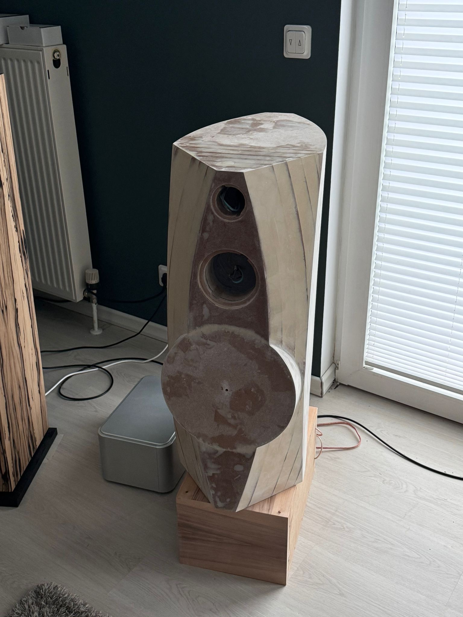

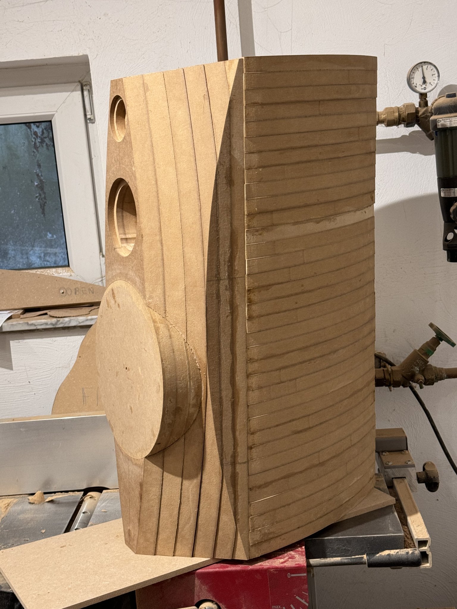

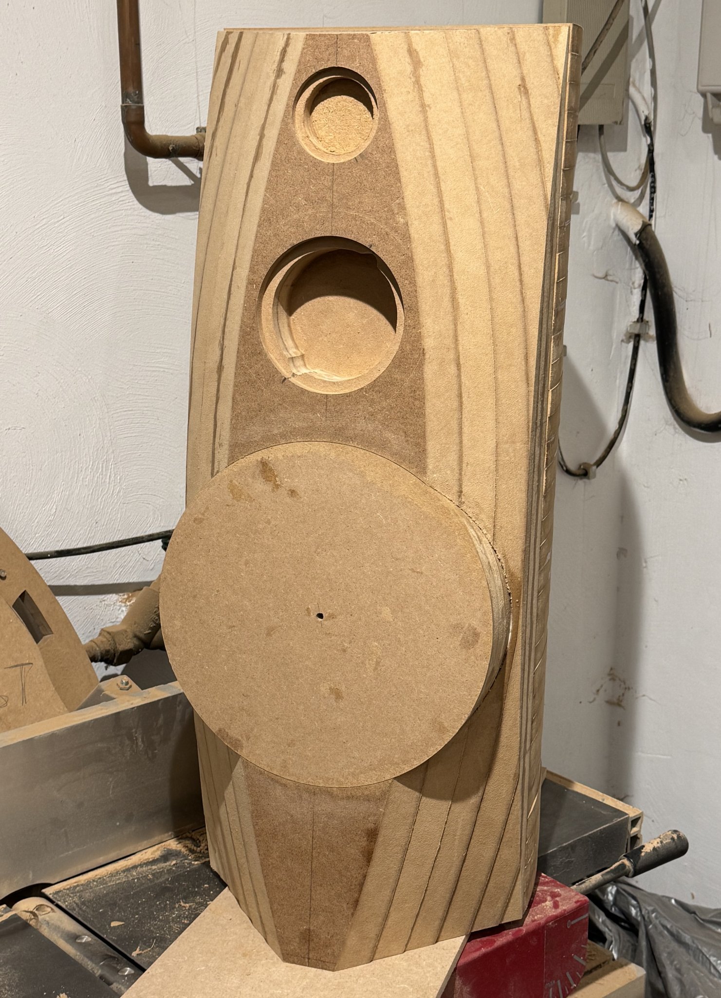

Why the perturbing bass tube? Its just causing diffraction for the mid and as you have DSP it's not needed from a time alignment perspective... cool look?
Hi, I dont know if i fully understand what you meen with "perturbing"? The Insert was the way to make the baffle around tweeter and mid as small as possible and still fit the 10 inch woofer. The corners will also be rounded but only after the driver arrives and the spartula work is finished.
Do you have a opinion on the bracing I showed?
Very impressive build, lukerhunter!what would work out better
With your stiff and heavy construction I can only think that you don't really need additional bracing ...
Parallel! You want it to be stiff and not "bending" over the bracing.I want to add some top to bottom bracing for the bass cabinet. But not to much. I have some massiv beech wood sticks as leftovers I want to use. I think about putting them parallel to each other or in a criss-cross pattern. I hope you can see what I mean in the two pictures. Do you guys have a advice what would work out better?
Why did you do the "waves" at the inside of the woofer cabinet? I mean it looks pretty cool - but at the wavelength the woofer is playing ...
So you would use top to bottom bracing in General? I also tend to go parallel.
The waves come from two speakers here from diy Audio. One was a high linearray. Dont know the exact Threads. One hoped with shifting thickness of the wall, to spread the cabinet resonance of the wall to a wider Range of frequencies and so lower them in there possible audibility. But he also Said, he dont know if its worked.
I know PBN Montana Sammy speaker also use multiple layers with grooves in it, to help with standing Waves. (I dont belive this works)
Gauder Acoustics also use multiple layers with waves in there higher end speakers. (But Mr Gauder also Talks some questionable Stuff on YouTube)
As I want to cut the inside of the layers with the jigsaw, to Safe a lot of time and just made a Template to draw the lines on the MDF, it was Like 1% more effort to made Waves instead of a straight line.
Will it help with resonances, standigwaves or reflections? I dont know. But I think there is a much higher Chance it helps than it hurts. Most likely I will Never know, as I wont do the Same endloser again without them.

Yes!So you would use top to bottom bracing in General? I also tend to go parallel.
The form of your speaker will already help to get stiffer. Just stay with 40-50mm wod thickness if you want great behaviour.
Normally resonance behaviour evens out and builds an average and you still get a weaker area (coincidence frequency), especially when you glue stuff together.
I also had good results with 1-2mm iron sheets glued on the inside with a thick layer of flexible floor glue. Brings weight and dampens resonances.

Still waiting for the Purifi. Next delivery Date is End of may, so Fingers crossed. Some Progress on the cabinet was done. Driverhole for the PTT10 is the last Part missing before I will begin with measurements. The inside diameter for the PTT10 is already cut and a big roundover was made, so the Woofer can breath freely.
I wouldn't use solid beech as bracing, it has one of the most longitud expansion of the wood species. Starting with 8-9% humidity in the beech, increasing a few %, kitchen door frames can have up to 3mm expansion on a half meter length, despite being lacquered. Of course, during winter in nordic countries, it can go the other way...
Hi, to late to change but I dont think there should be a Problem. They are round sticks in longitunal direction. Expension in this direction is minimal with 0.01% for each 1% of less or more Hydration. They are in a airtight enclosure and glued with Weicon Flex, so they can move a little and wont detach because of it. Time will tell.
