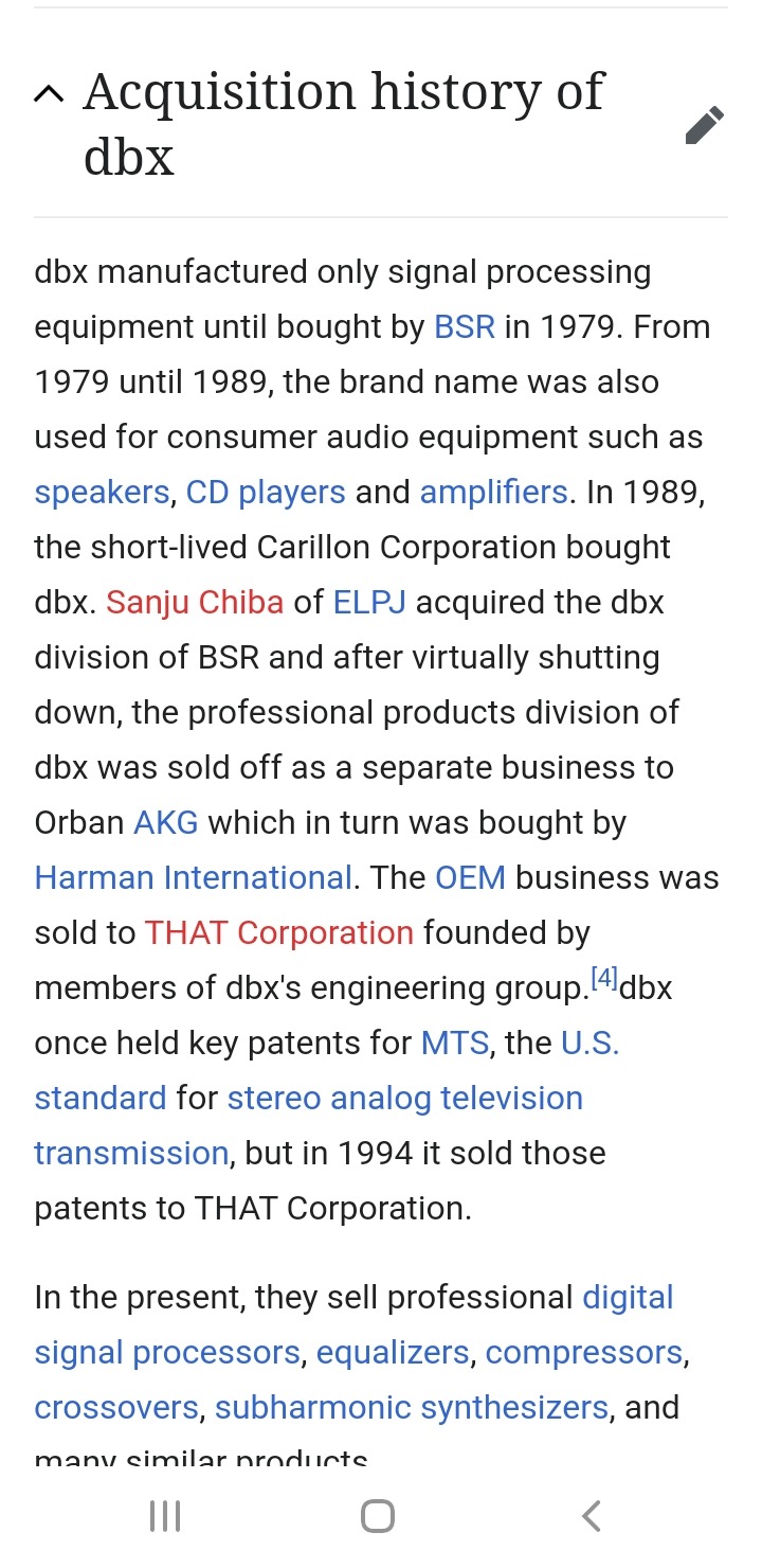

DBX merged into THAT.I didnt even know the THAT chip existed.
Now the "Blackmer" reference in the spec JMF posted the link to makes sense.DBX merged into THAT.

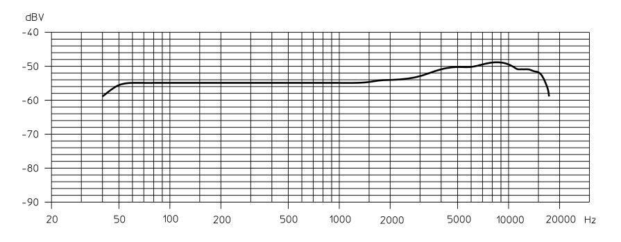

As you probably know, besides dynamic range compression, boosting the upper mid by a couple of decibels is a well-known trick to improve intelligibility. See the frequency response of the Sennheiser MD-21 for example.
