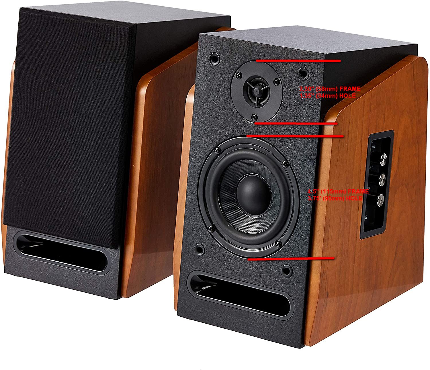

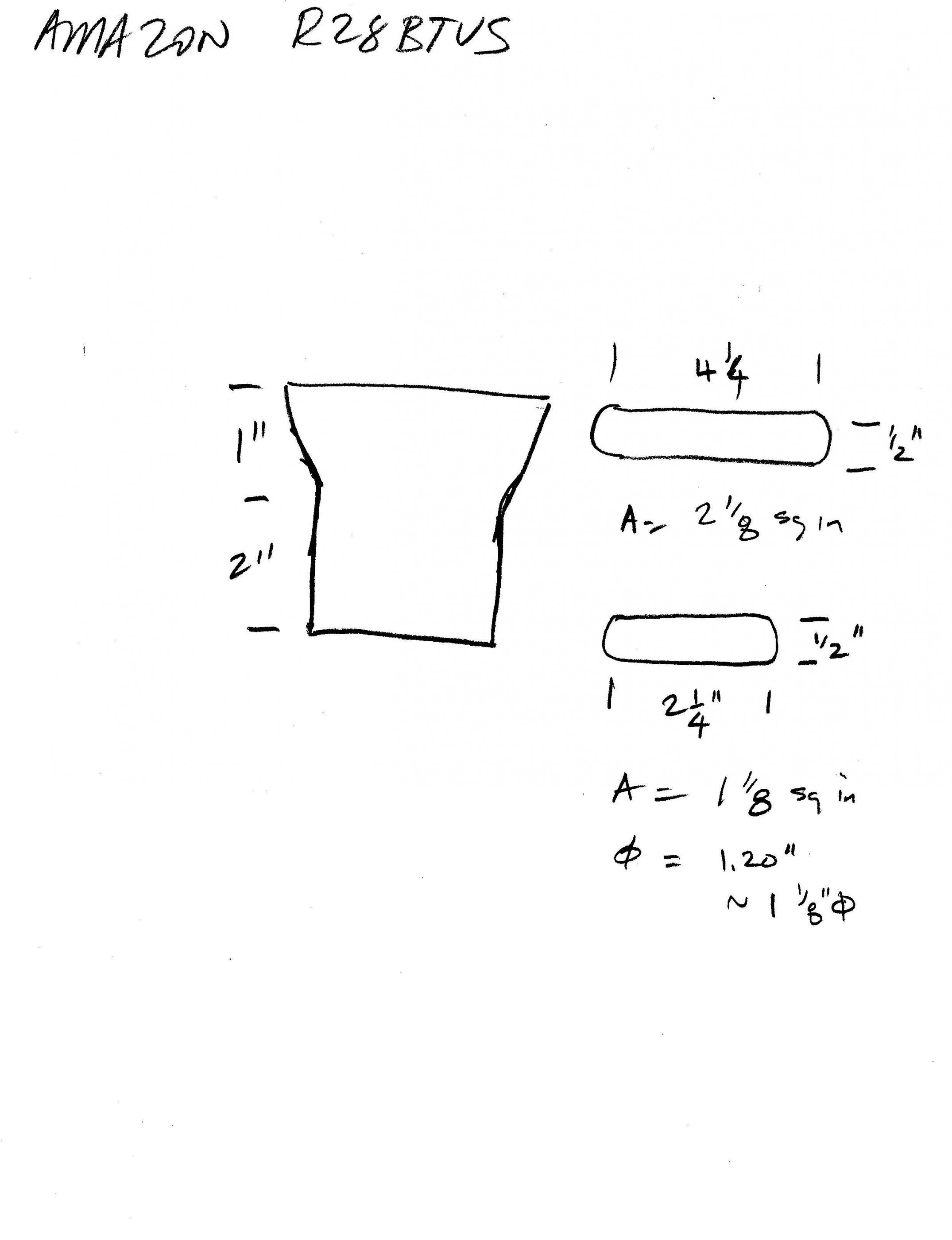

Both these look good as options cabinet and driverwise, but I'm not sure about the port. The Alpair would be drop in with a good fit and no mods other than plugging the tweeter hole and reducing the volume to 3.2L. It appears the 1"dia/2"L port for the bass reflex design is equivalent to the existing port if the existing slot is equivalent to 1.2"D/3"L, but I can't say for sure due to the way the port expands (see diagram). Does this shape affect tuning or is the entry area of the port the driver? The existing port/enclosure do not offer any opportunity for modification.
The Dayton port at 1 1/8"D/6.5"L is just too long, unless there is a way to work around this. Otherwise, it would definitely be a good option.

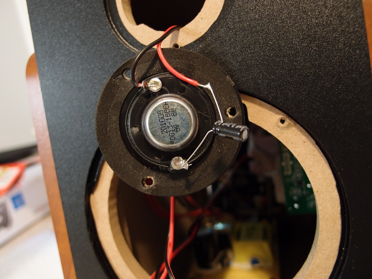

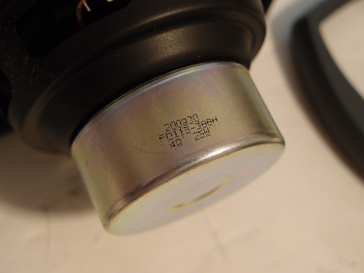

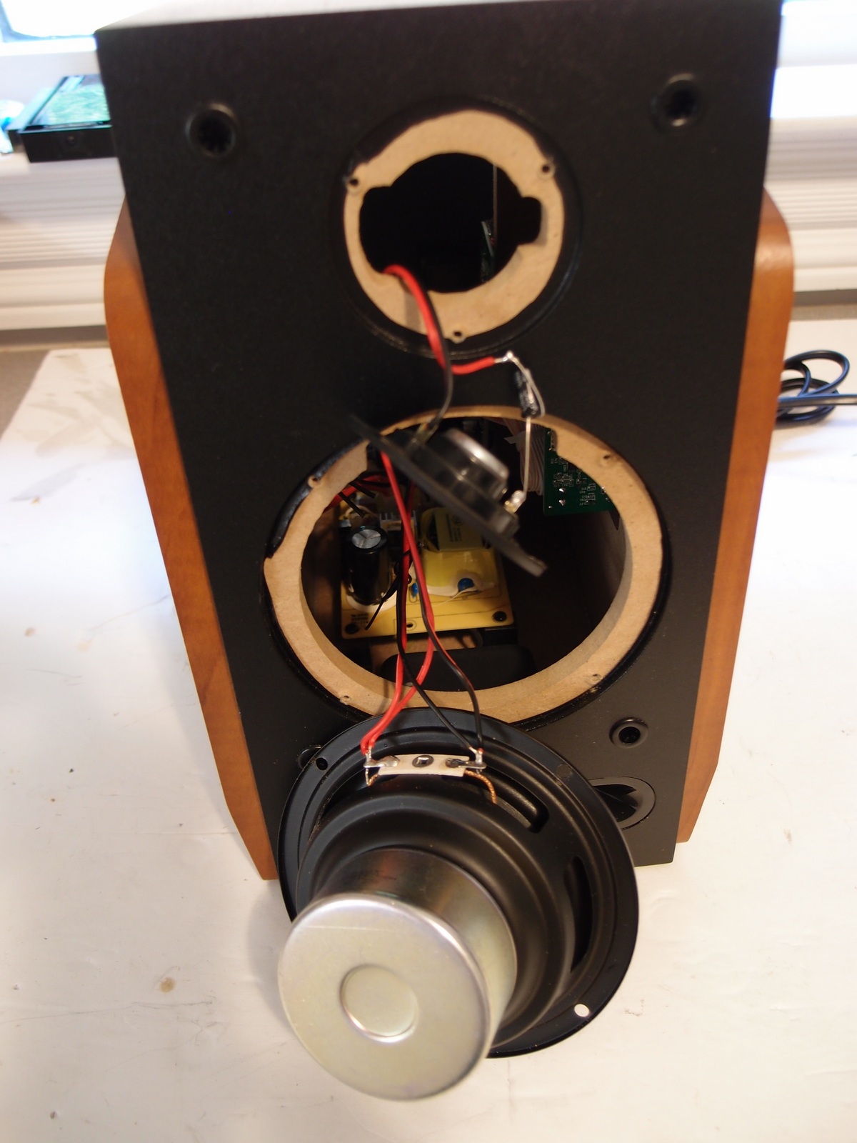

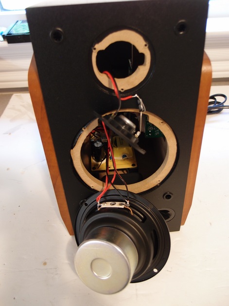

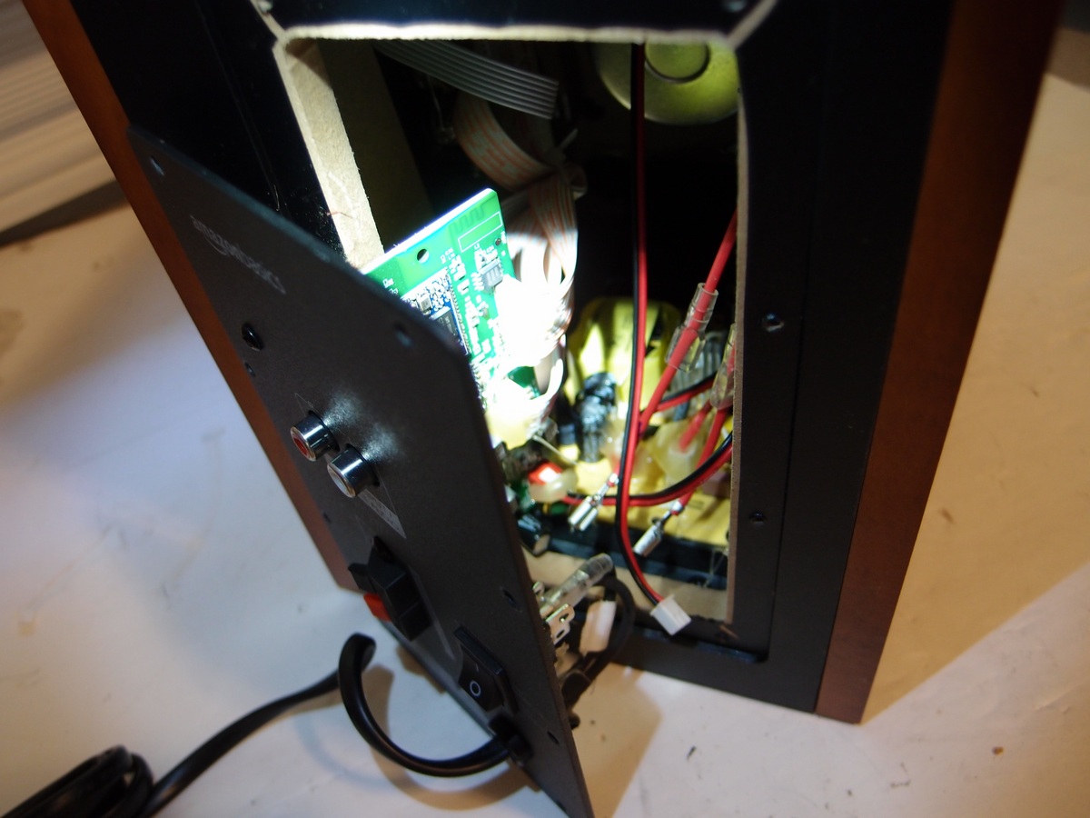

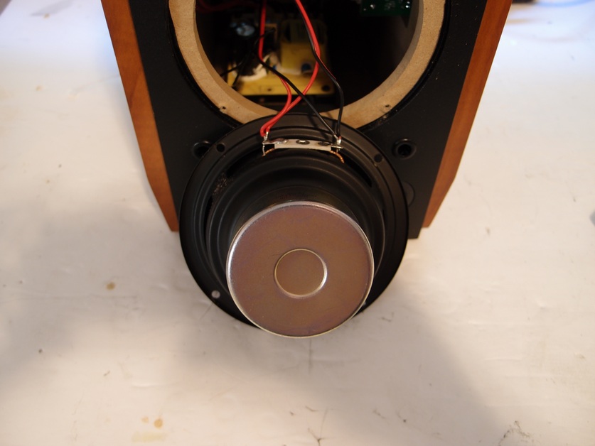

They are small and have no bracing internally. 1/2" mdf with the faux wood side panels.

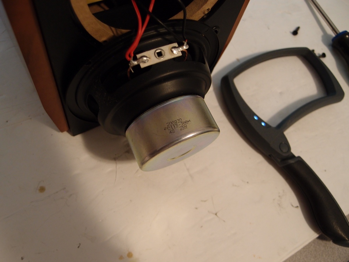

The port changing size may change how it behaves. I tuned the TCP-115 to the low fifties IIRC. A smaller port will be more apt to cuff at high volumes. I wish you had a way to measure the speaker to see the box tuning and what the amp is doing eq wise. Until then you are guessing. Going with a completed design will take some of the guessing out but you still don't know what the amp is doing. If you have the funds buying some of the drivers and trying them could be fun.
That's a brilliant suggestion, but I'd be more comfortable cutting a hole on the bottom and putting the speaker on feet. I'll have to look at that. Taking some measurements soon to see what is going on with the original drivers. I am hearing some output from the woofer at 8000 Hz.

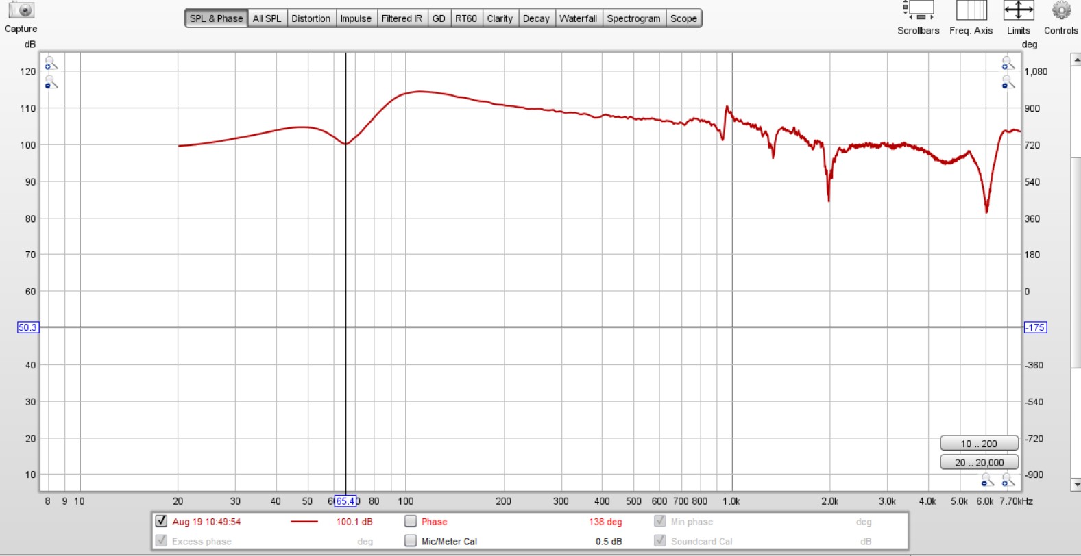

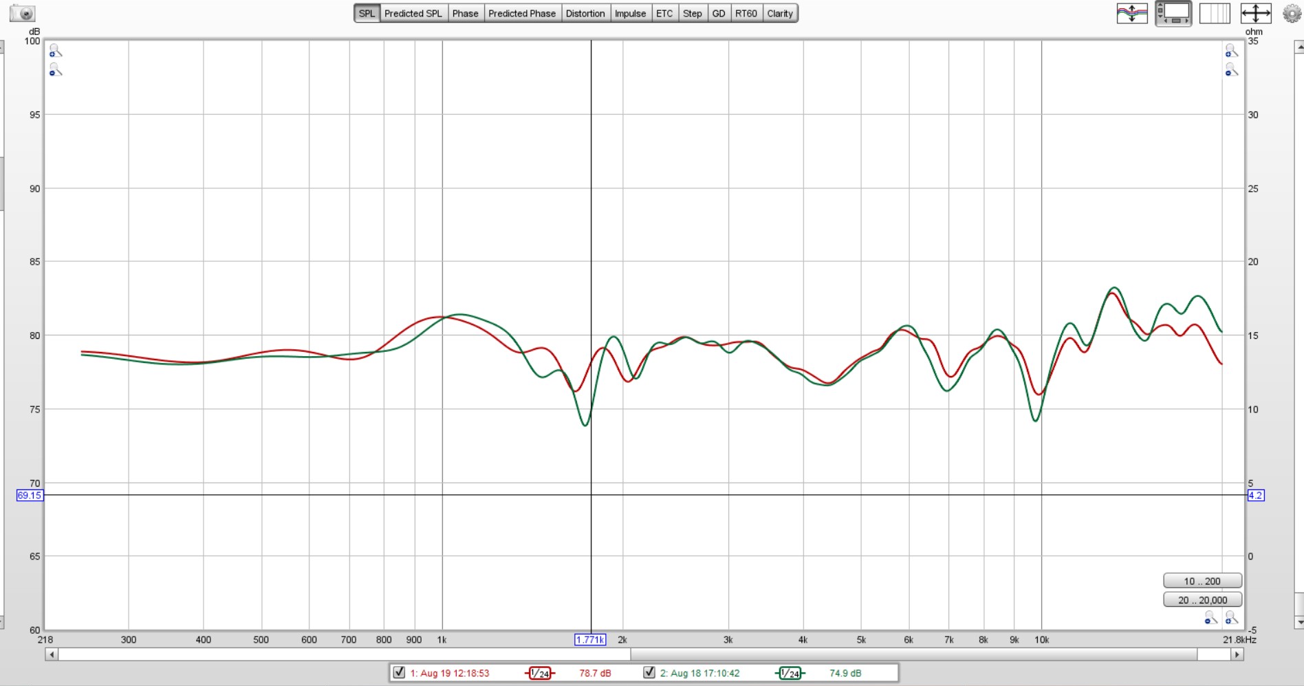

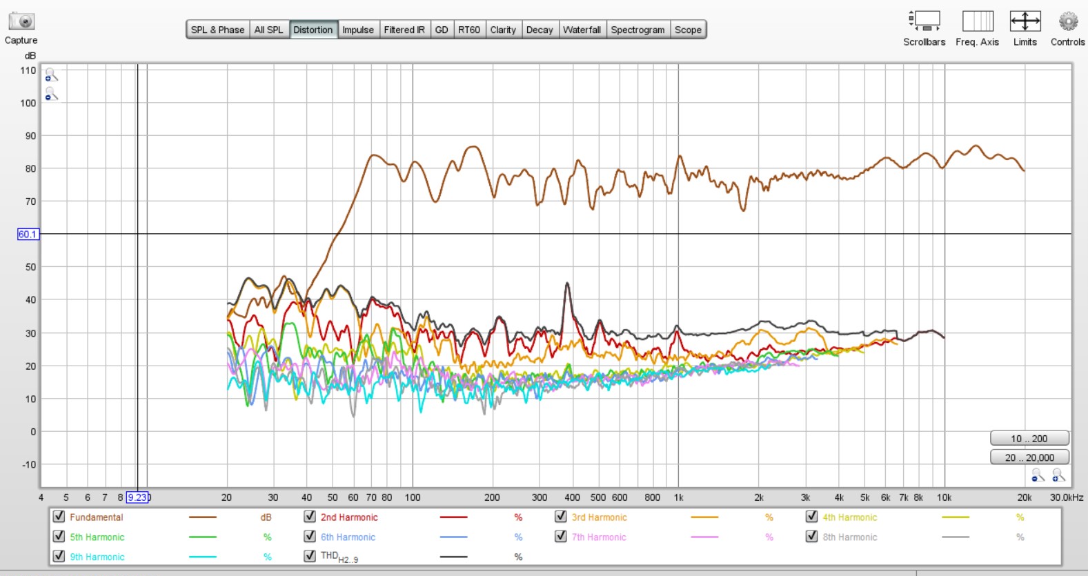

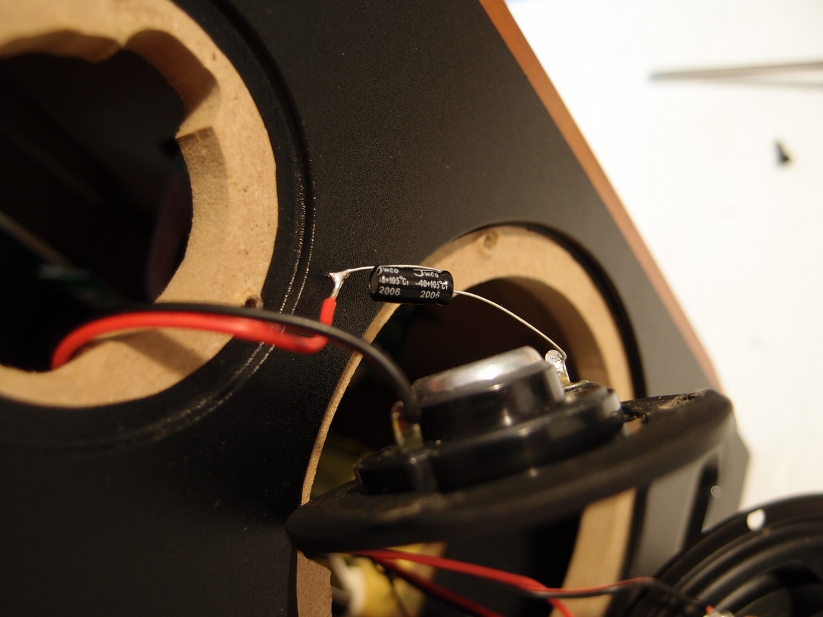

So this is frequency response and phase using REW/UMIK-1 measured at 1m in a room with 8 foot ceiling and no reflective surfaces closer than 4'. I am using a 4ms gated measurement here, so good to 250Hz. The speaker is stock, port open with a 2.2uF cap on the tweeter, microphone in line with the tweeter.

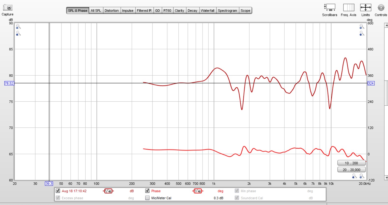

I have taken tweeter and woofer measurements at 1m. Also, near field woofer and port measurements. I have been looking at Bagby's Response Blender, but that only combines the far and near field measurements and accounts for baffle loss, but not the port as far as I can tell. How do I add port output to the woofer response?

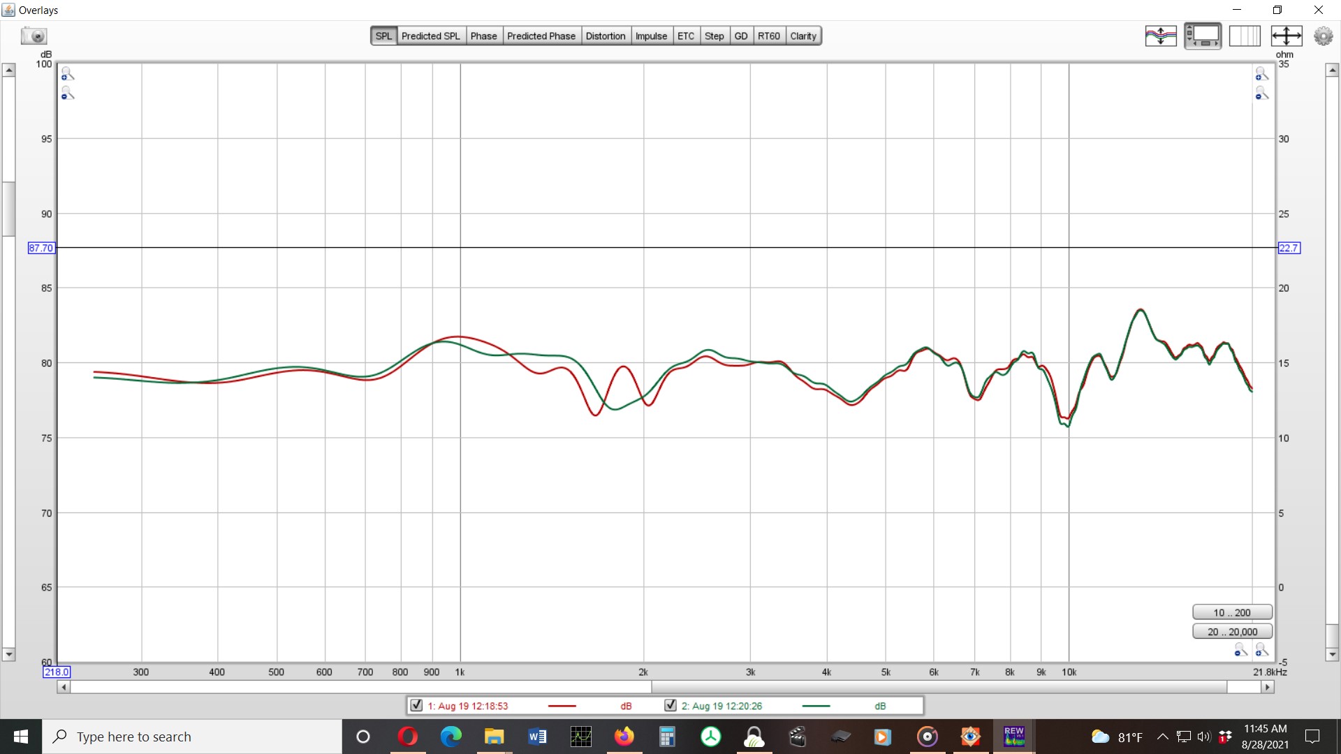

This is the lined cabinet with port open (red) and port plugged (green). Plugging the port seems to have some smoothing effect between 1KHz and 2KHz, but otherwise response is same. This measurement has been offset to line things up, the plugged output was somewhat lower unaltered by a dB or two.
