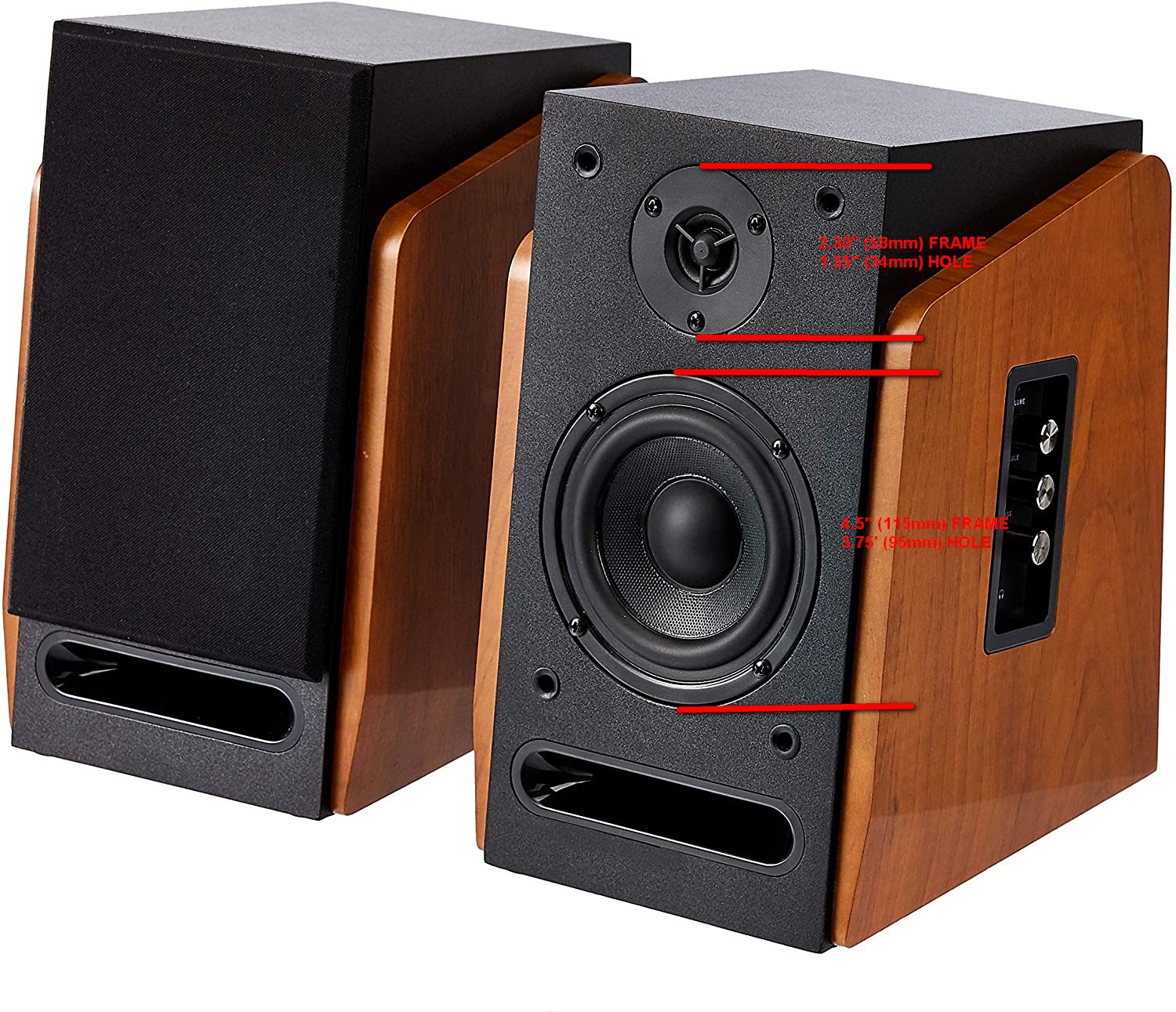

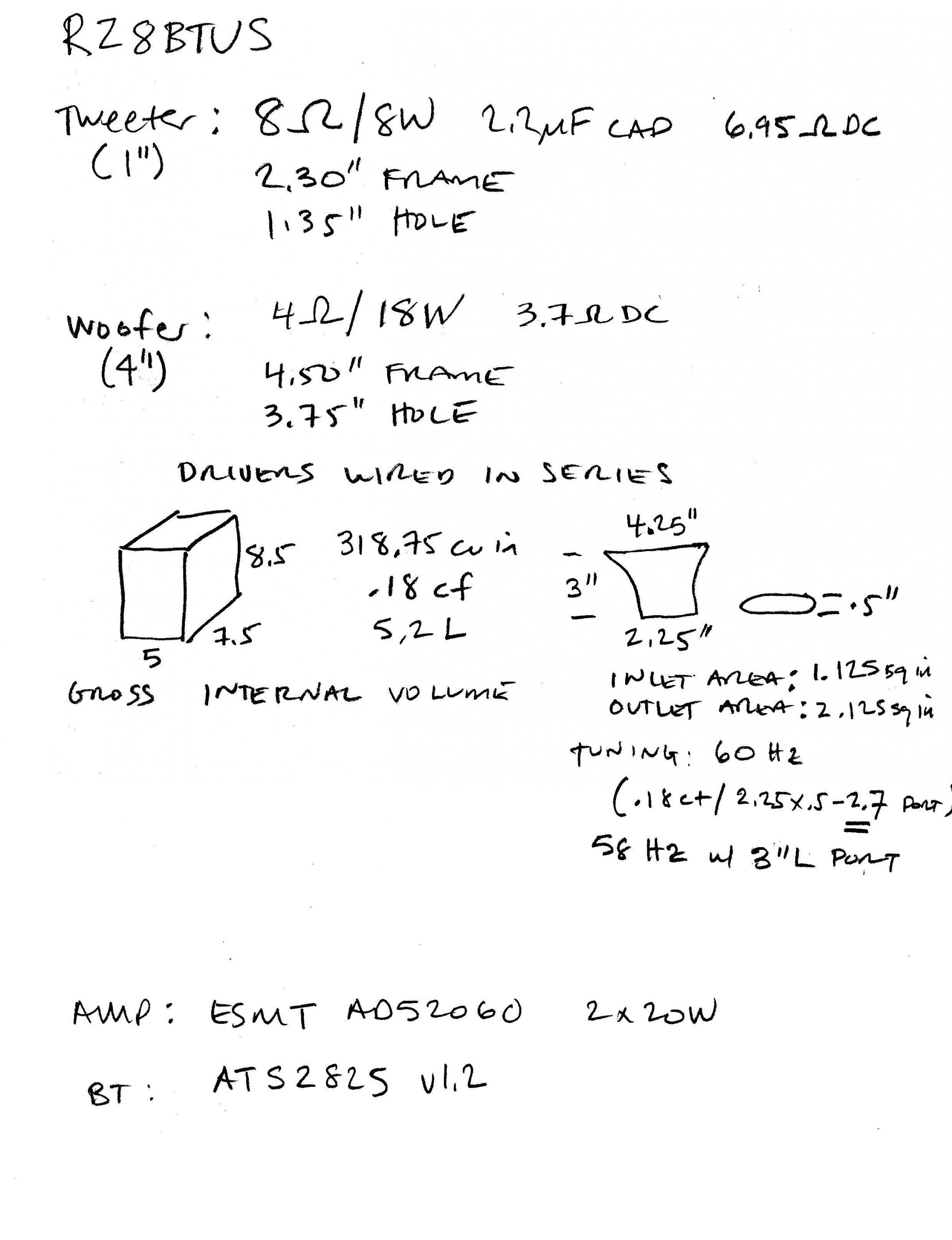

I recently picked up these powered BT speakers from Amazon, model R28BTUS. They sport a 1” tweeter and 4” woofer. Didn’t need them, but for $25 what was I to do? Crossover is a 2.2uF cap on the tweeter. Drivers wired in series. They aren’t too bad with the ports stuffed, but they very likely can be improved.

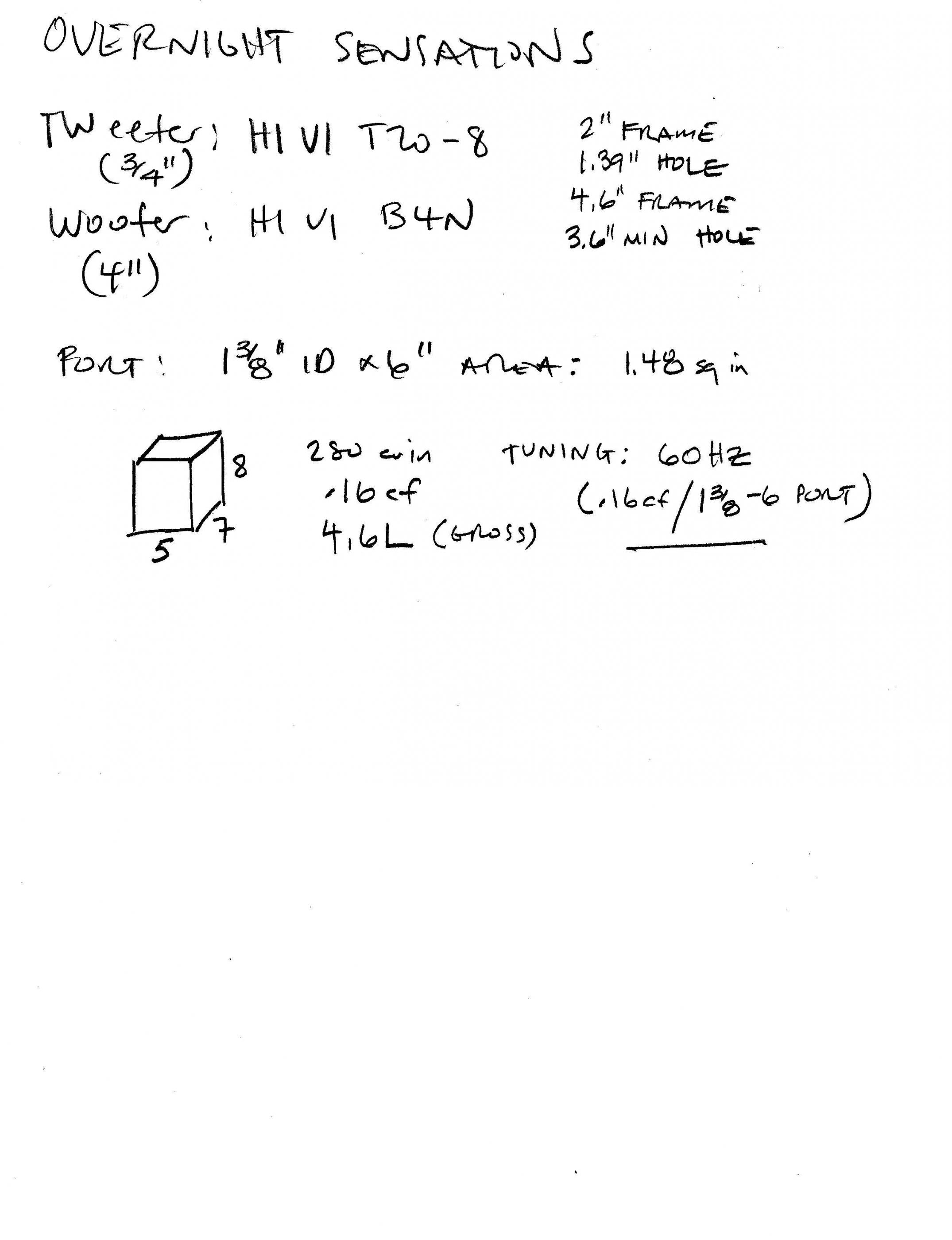

The Overnight Sensations using the HIVI T20-8 and B4N design appears to be a very good fit to the unit’s .18cf (5.2L) cabinet. The OD of the B4N frame is .1” larger than the existing, might be able to sand out the difference. The hole for the tweeter will need a bit of enlargement, but that should be easy. Even the odd port looks pretty close to what is needed. Driver costs would be $23 per side, about as low as can be expected. I have good stash of crossover components, so I’m not that concerned about crossover cost.
Are there any other 2 way designs out there that use similarly sized (or somewhat smaller) drivers in about a 5L box that I should look at? Is there a full range driver that might fit with no modifications? The drivers can’t be surface mounted, the grill is flush to the front baffle and there would be no room.

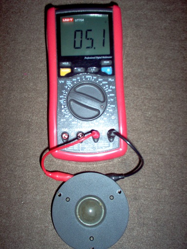

Measure your drivers;
591815d1484284062-visaton-alto-iii-morel-cat298-jpg
An 8 ohm bass (6 ohm dcr) might prefer 1.8mH and 6.8uF.

The W4-1052 should work and I have a pair of ND20TA-6 in the Amethyst which I could use in lieu of the FA. So far, the options are the Overnight Sensations ($50 driver cost with the HiVi tweeter) and the Amethyst ($100 driver cost- assuming use of TA driver).

How is that wired? It makes little sense.

I was wrong, the way it is wired threw me off, never seen it done like that. positive wire goes from amp to (+) woofer to 2.2uF to (+) tweeter. negative from amp is same, goes to (-) woofer then to (-) tweeter.

I would suggest to start measuring the current drivers first of all, and work from there. Get ARTA, REW, HOLM or whatever freeware and learn to measure the raw drivers in box.
My initial intention was to drop in a proven design. But maybe I'll upgrade the tweeter to the ND20TA-6 which I already have on hand, make use of the existing 4" and either use a canned crossover crossed at 4000 Hz or develop the zma and frd files for a more customized crossover. I have the necessary tools, its just a matter of learning how to get good data and then coming up with a crossover that will work.

The volume works, but the drivers are too large. The wide flange thickness on the SB unit also might not work due to the grille being solid particle board with cutouts for the drivers (like the old Smaller Advent) and sitting flush with the baffle. This particular model is not very forgiving as to modification to make things work.
