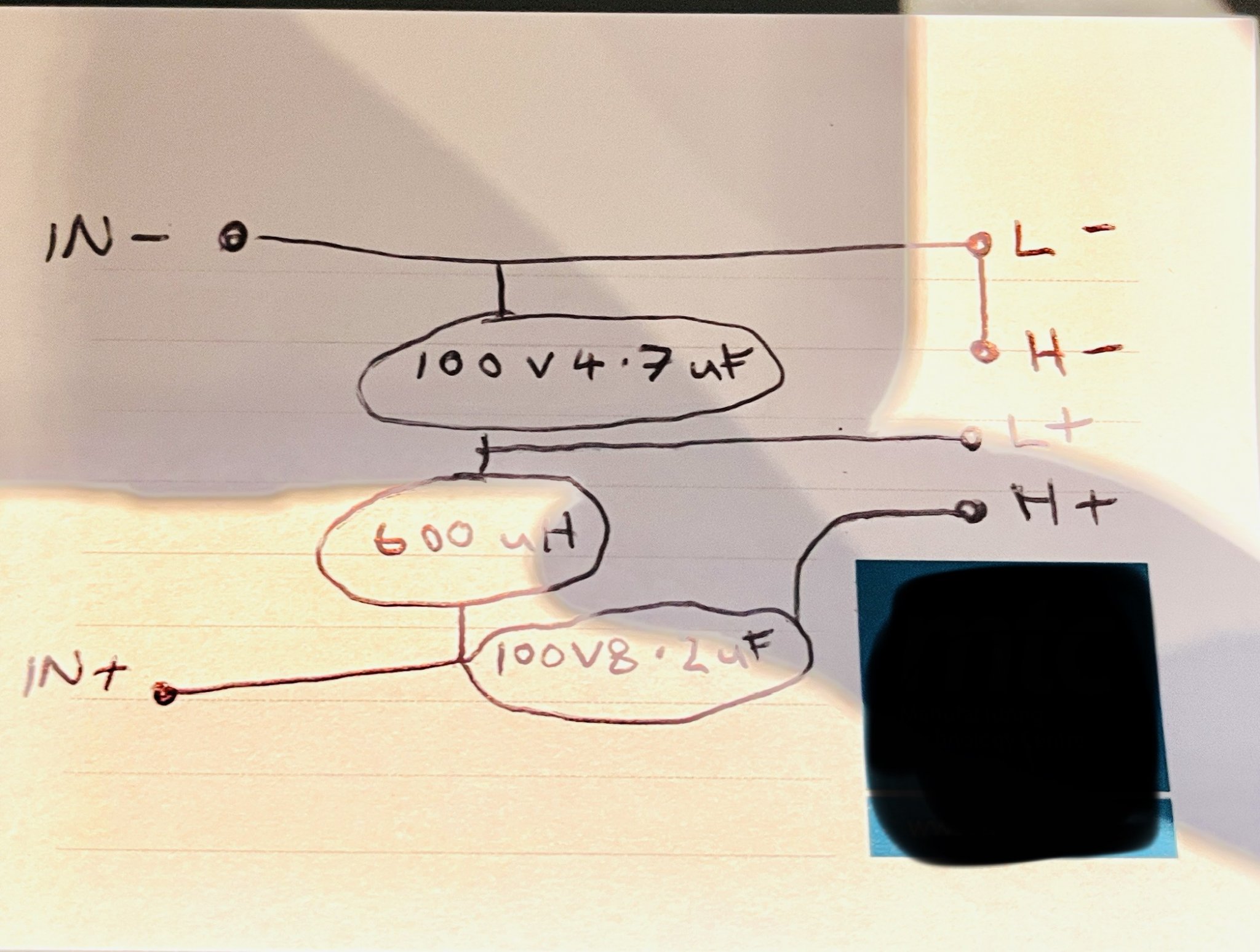

So I've managed to find the crossover circuits for the Mackies, but they were part of the amp board so I've had de-solder to remove the components. Do these numbers make sense to anyone.... 3 components, 600uf / 100V4.7uf / 100V8.2uf
In+ => branch => 600uF => 100V8.2uF Cap => Out High +
=> branch to the Out Low +
=> 100V4.7uf Cap => Out High - and Out Low -
In - => branch => to the 100v4.7 => Out Low - and Out High -
Thanks for that, that's really helpful, I had the tweeter and bass caps mixed up in my diagram.The attached has the diagram for the crossover components.
