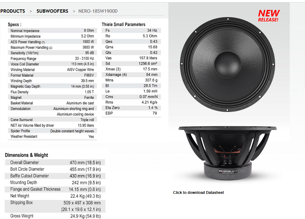

If you want a "compact" 18" and have a little bit more money the new NERO-18SW1900D is very impressive for the price.

@scholl with "these" being the NERO-18SW1900D?

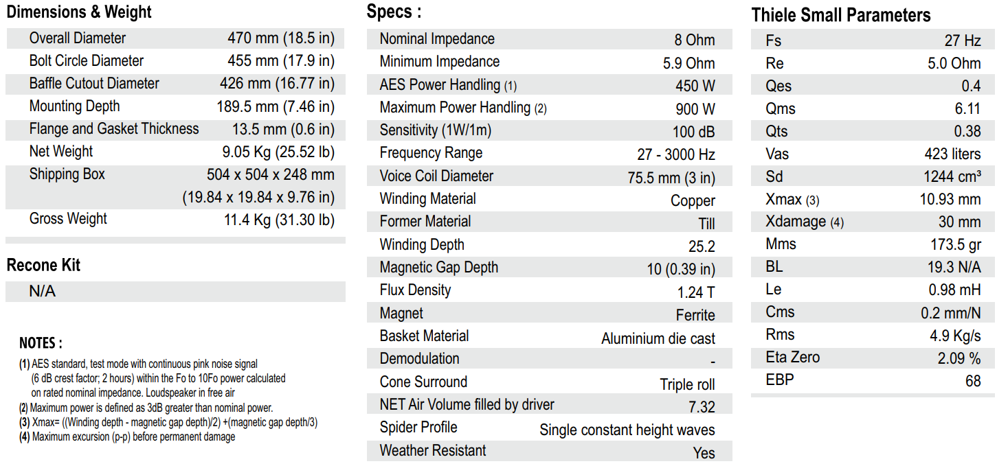

At any rate, I really like value for the money, so I have 4 x SB Audience BIANCO-18SW450

Yes the 18SW1900D in a 170ltr box tuned to 30hz for an F3 at 31hz to be more exact. a 32hz tune will give a little better group delay. BMS has the best group delay and for some reason I tend toward drivers with larger Vas for lower power listening but they're hard to get in the US. I chose this box size and tuning because I already have the boxes.

I bought the 4 x SW450, and then the 1900D launched shortly afterwards, otherwise I might have gotten those because of the space savings.
The 4 x SW450 might have better fidelity, and they should be more efficient per amount of power, so I am happy either way.

That's not correct.It is hard to beat these drivers for the value, most manufacturer calculate xmax by:
VoiceCoil-MagnetGap/3*2
22-11/3*2 = 7.33mm
The linear Xmax (Xlin)n is calculated using the formula:
(Hvc - Hg) / 2 = Xmax [+/-mm]
Hvc = Voice Coil Winding Depth
Hg = Magnetic Gap Depth
Xlin means that the voice coil remains completely within the magnetic field or air gap and moves proportionally to the current flow.
This value could be called the "theoretical excursion," and it is only a geometrically determined excursion limit that does not necessarily provide information about the actual performance of the loudspeaker.
The value (winding height - pole plate thickness) / 2), which is used to calculate Xlin, is therefore no longer sufficient today.
In reality, at least with PA drivers, it is often the case that the drive can go significantly further beyond Xlin, even if the drive is already partially weakening.
To obtain a meaningful indication of a loudspeaker's maximum power, distortion and IMD measurements should be performed.
Wolfgang Klippel (IEC PAS 62458) has provided templates for a standardization, and he has conducted useful research and proposed a practical standard. This standard states that the linear excursion of a driver ends where the driver (at natural resonance) causes distortion values of 10% (THD). For a realistic assessment of Xmax, the minimum of XBl, XC, and XL (and XD) should always be used.
The actual, real Xmax therefore describes the excursion with still low distortion, which, according to Klippel, should be limited to 10% THD.
Unfortunately, not all driver manufacturers adhere to this standard, as it is not a binding standard but merely a recommendation.
When calculating the actual Xmax, it's also important to note that the voice coil heats up more when it leaves the magnetic gap than when it's in the linear range within the magnetic gap. This can lead to distortion and overheating. Therefore, adequate cooling of the speaker is essential to ensure reliable and stable performance.
And here we come to an important quality feature that many well-known manufacturers rely on: the pole plate!
The voice coil still has almost its full driving force when it's only 50% in the air gap (some say 75%... different sources). And since a thick pole plate increases the power handling almost proportionally to the thickness, this is also a direction many manufacturers of high-performance drivers are taking. This means that with a very thick pole plate, the actual Xmax is much higher. However, the distortion then increases significantly.
In simple terms, this means: the thicker the pole plate, the more powerful the system can be. Cooling for the beaten coil only really exists where the heat can be dissipated, and that's what the large amount of metal is for.
Thick pole plates can help ensure that the system remains stable even under high loads and that the voice coil is cooled more effectively.
And this is one of the most important explanations for why some speakers sound better at higher volumes than others.
So there is definitely a correlation between the ratio of pole plate thickness to voice coil length.
The bottom line is that, for the same Xlin (theoretical Xmax), a driver with a thicker pole plate—i.e., a deeper air gap—is capable of longer excursions than one with a thinner pole plate.
Not to be underestimated in terms of operational reliability.
Despite the proposed standard by Klippel, there are still different methods for determining a speaker's Xmax value, and the values can vary depending on the manufacturer.
For example, FaitalPRO and Fane add an additional 1/3 of the pole plate thickness.
18Sound does it differently again and adds 1/4 of the pole plate thickness. B&C, RCF, Oberton, and Lavoce do the same.
Beyma adds 1/3.5.
Therefore, the formula for the actual Xmax of a powerful PA driver is as follows:
Here are some examples of some well-known PA drivers:
18Sound: (Hvc - Hg)/2 + Hg/4 = Xmax
B & C: (Hvc - Hg)/2 + Hg/4 = Xmax
Beyma: (Hvc - Hg)/2 + Hg/3.5 = Xmax
Faital: (Hvc - Hg)/2 + Hg/3 = Xmax
Lavoce: (Hvc - Hg)/2 + Hg/4 = Xmax
Oberton: (Hvc - Hg)/2 + Hg/4 = Xmax
RCF: (Hvc - Hg)/2 + Hg/4 = Xmax
