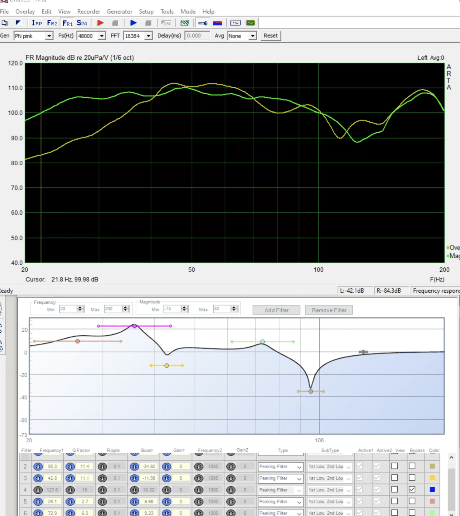

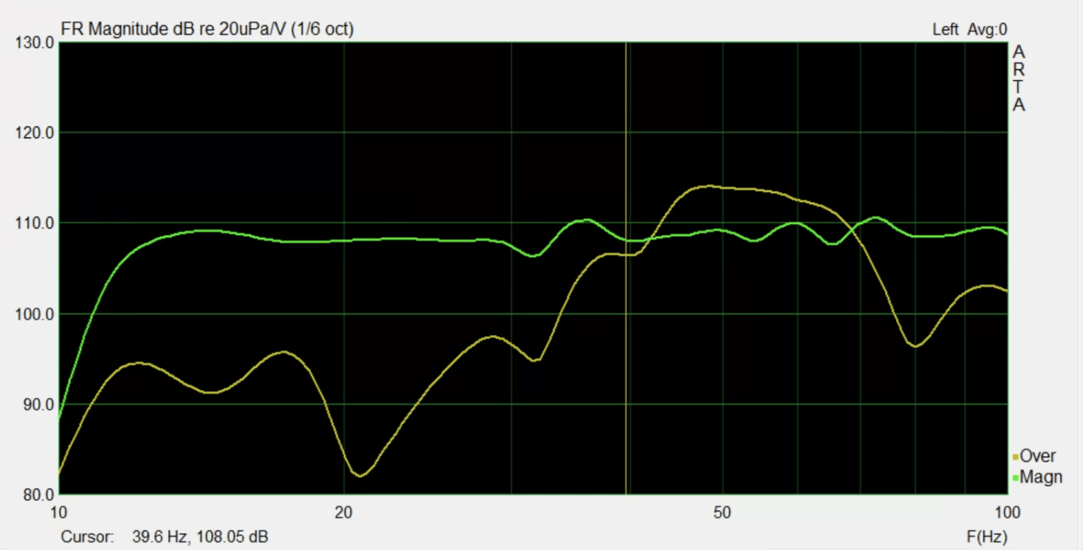

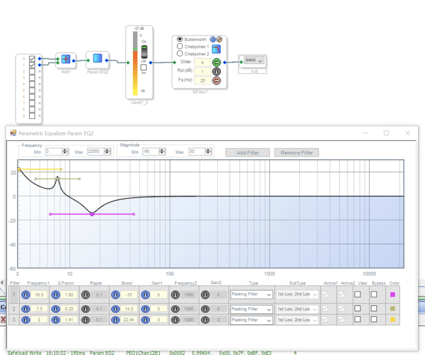

I don't know how loud it can go, but it seems that ADAU1701 equalization can iron the response down to 10Hz:
I was using single precision ParamEQ block which apparently was producing some noise at low end so I had to go for double precision PEQ, which in turn seems to be limited to three peaking filters (in ADAU1701). Happy with result so far, I wonder if lower Fs driver would bring any benefits here.
A lower Fs driver may require less voltage to reach full excursion in the small box, which could reduce power compression on extended high power low frequency events.Happy with result so far, I wonder if lower Fs driver would bring any benefits here.
If you are happy with the output level as is, there is little to be gained swapping drivers.

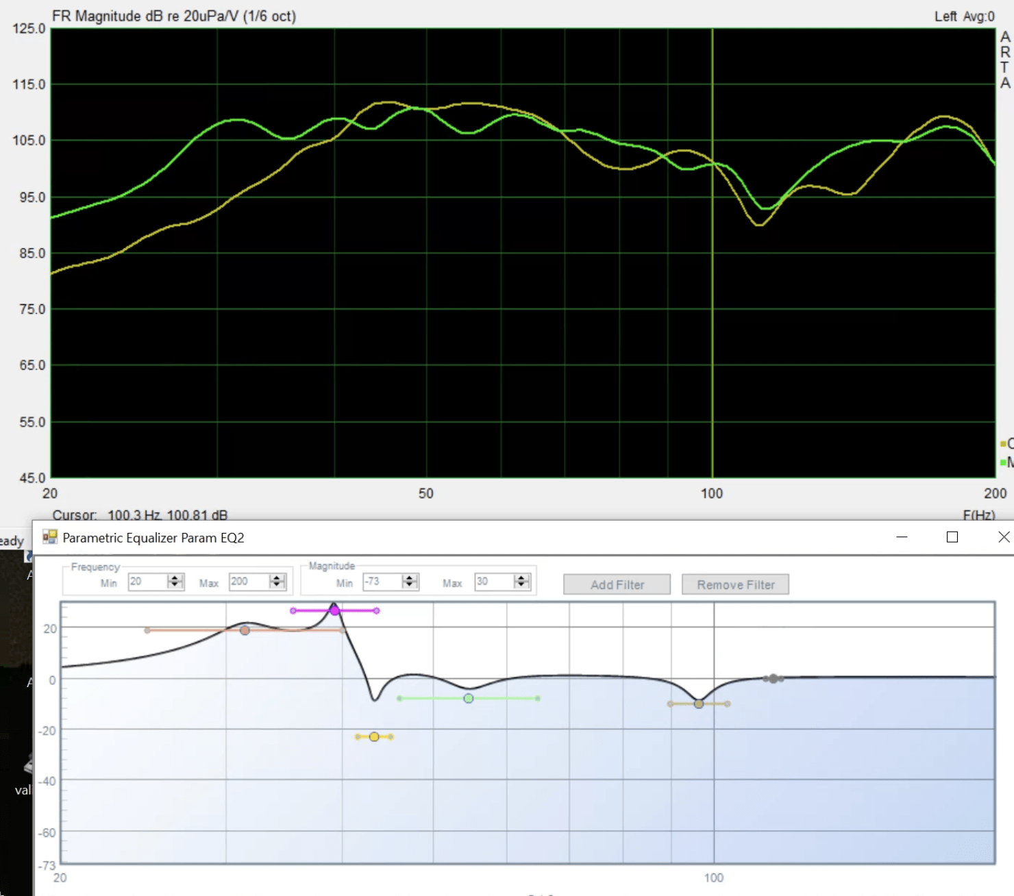

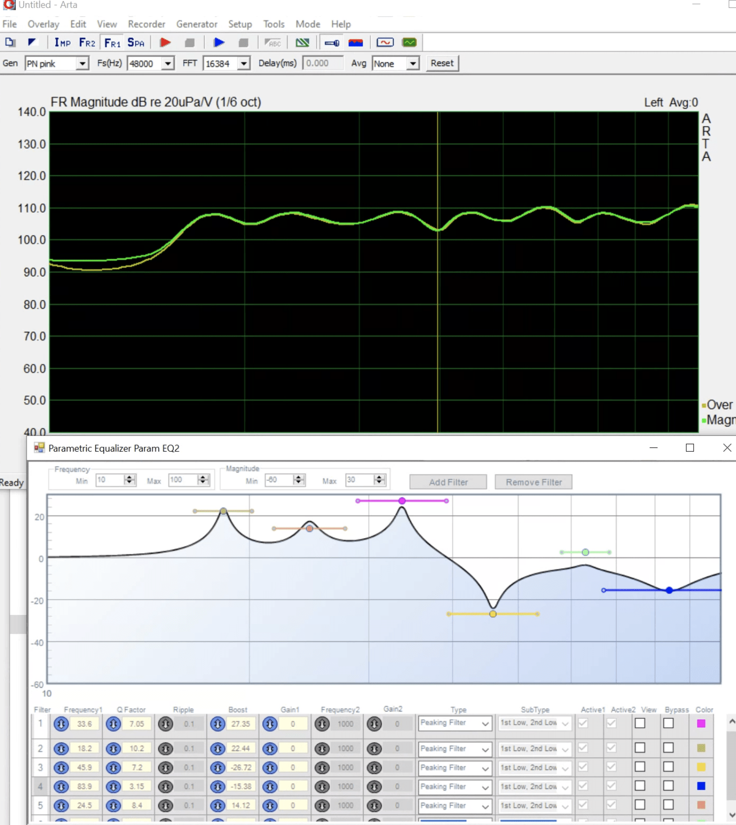

Anyway, I will try another driver when they get them back on stock. In the meantime, did some more optimization in the DSP:

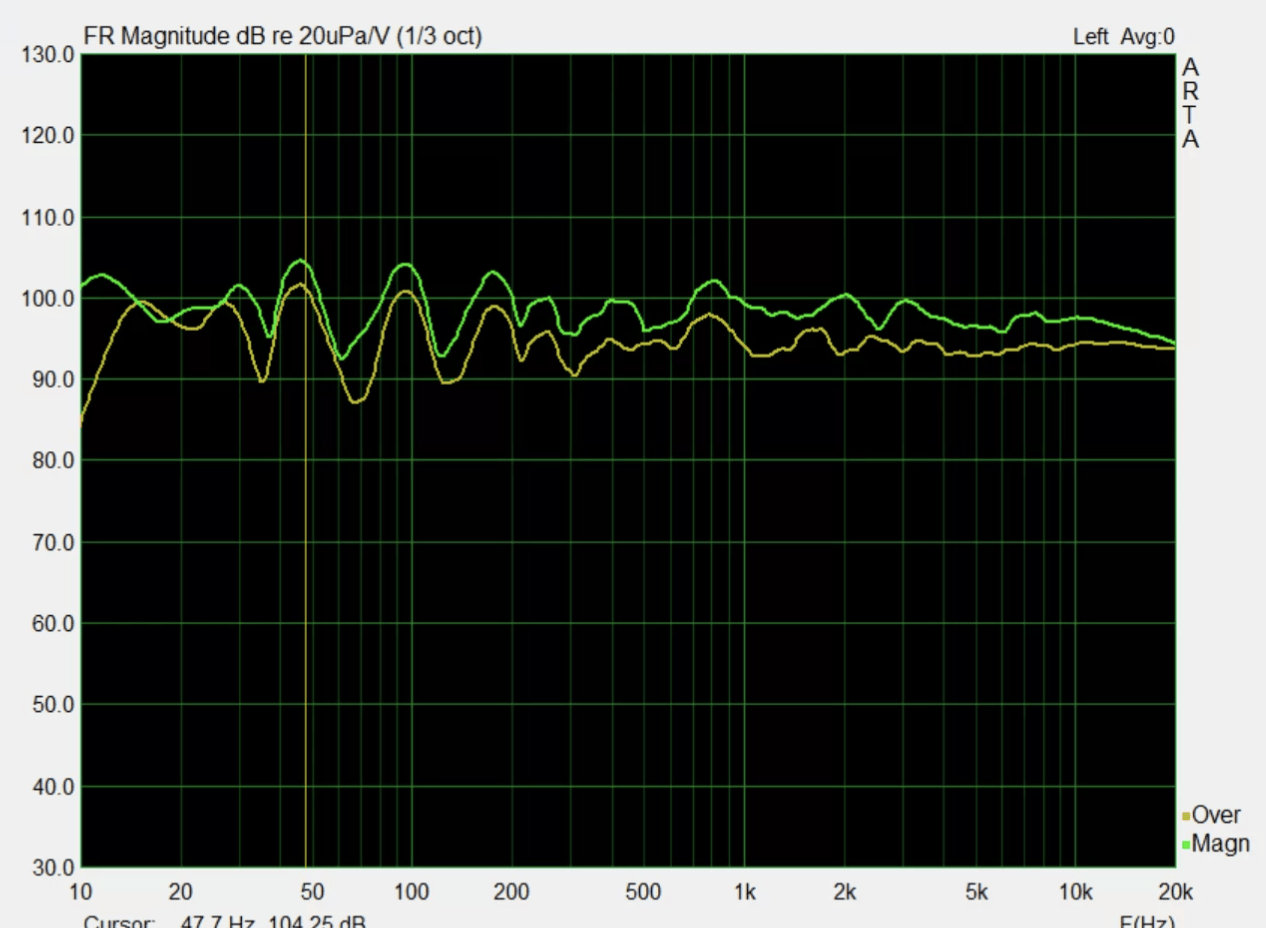

I am a having another weird issue. If I maintain mostly flat FR in the region 20-100Hz, lows around 100Hz sound noticeably worse than on KEF Reference - very unpleasant resonance like experience. If I imitate KEF's response in this region, lows sound much better overall. KEF is yellow, my sub is green. Not sure is this is my room's response or something else.
I am puzzled now: if I can hear this peak resonance around 100Hz, why is this not reflected in the measurement? To eliminate this audible peak, I need to leave this "valley" untreated by peaking filter, pretty much the same as KEF does...
If that response graph was taken with the mic close to the sub, .but on your listening position you get the peak ...is a room mode. You need to change your sub position.
But ideally you need to put the mic at the listening position exactly. That way you will see what your ears ..hear
And you can eq better that way, but the best thing you can do is to treat your room with bass traps.
An acoustically treated room is much much easier to eq or almost no eq at all.
