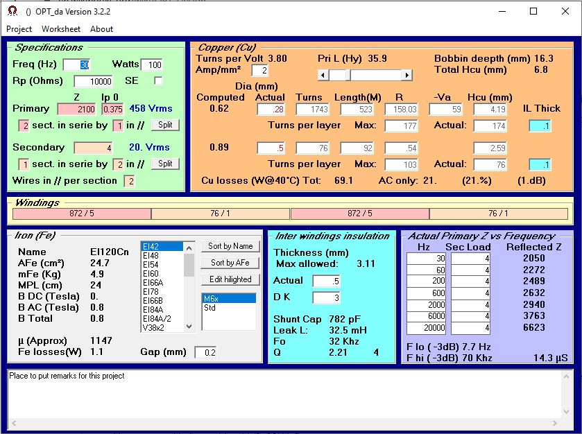

I tried a preliminary calculation using OPT_DA OPT Calculator
Hi again, I have tried to do a calculation, screenshot attached, any feedback would be greatly appreciated.
I googled the plate resistance of 4 6L6 tubes in 100W Push-Pull and got 10K Ohm, can someone please confirm? Then, I used the primary impedance as 2K1 Ohm and the secondary impedance as 4 Ohm (as per the Classic Tone 40-18013 specs). The plate current, I used as 0.375A (googled, but not quite sure about this). Furthermore, I used 30 Hz as the lowest frequency and 0.2mm gap (also not sure about these)
The "[] sect. in serie by [] in // [split/equal]" & "Wires in // per section []" sections in the top left green box, I have no idea about.
The program said: 1743 turns on the primary (0.28mm diameter wire) & 76 turns on the secondary (0.5mm diameter wire). I checked and these results do get the impedance ratio right. How does this sound, right or wrong?

Looks good but are you sure you can source M6 transformer core? here in México is unobtanium, and is very difficult to import from USA, also if you want a more symetric winding you should divide the primary in 4 parts the inner in series with the outer to have similar DCR , between primary halfs (inner winding will have the lower dcr, the outer one will have the greater) this will reduce the stray field and archieve better coupling between primary and secondary also the DCR will be better balanced between primary halfs that will traduce in lower cooper loss.
You should not spect to use a core gap because its a pushpull transformer by design its supposed that the same or almost the same plate current flowing trough primary halfs, which in the end cancel most of the DC saturation in the core, leaving only AC saturation, if you are planning to have dissimilar DC current or a certain of current imbalance you can put a small gap, but sacrifacing a lot of the primary inductance and low end response.
In reality you should spect something in between 200mA and 250mA biasing for that power if so to speak, that primary gauge seems good, but you can lower it a bit, also make sure your transformer spool have the dimentions the program spects if dont it will very difficult to make fit those windings, and certainly it wont have the same response the program shows.
No.
Four 6L6 @100W is "100 Watt Fender". Standard impedance is 2Kct.
2K is OPT's impedance, not the plate resistance.
Still the plate resistance is not 10K - rather around 40-50K at low levels and heaven knows what at max power.

I have a PPP 6L6 and the OT is a the effective primary plate-to-plate
impedance of the four windings (when normalized to a conventional dual primary
winding transformer) is 2582Ω.
Thanks Brice, I changed Rp from 10000 Ohm to 2582 Ohm in the program and the number of turns stays the same. In fact pretty much nothing changes, which I find weird, so I guess that doesn't matter much?

Nope you are still confusing terms one is tube plate impedance and the other is the transformer impedance, the tube has this internal impedance that is in function of the type of tube, interelectrode distances and emission, the other is for the transformer that is in function of the frequency, inductance, stray capacitances DCR of the wire etc.
A tetrode/pentode like the one you use, commonly have like 10-50 Kohms of internal impedance when operating, but those are elements are not very linear, like any active device, its internal impedance will go up and down in function with the power frequency and current trough the element, the transformer will do also but these are passive components so they will be more linear in that regard, and when properly designed, the plate impedance (a normalized one) of the tube is used by the program to estimate the whole at some frequencies of interest (tubes coupled to the transformer) obviusly to a degree because it can vary a lot, since there are a lot of topologies and it isnt consideraring any type of feedback.
This frequencies can be used to see by the user if the transformer will have problems within the audio band, and also if it will need to adjust the whole, more turns, less turns, wire loses, distances within windings (isolation thickness) how it influences the stray capacitances, magnetic coupling ,etc
Thanks again maton00 and Brice, I think I understand a little better now. My calculations and the calculations from OPT_da seem correct to me at this point. This then only leaves winding and testing/experimenting. I had a look at Sowter Transformers and their prices are about the same as/a bit higher than Classic Tone's with shipping.
