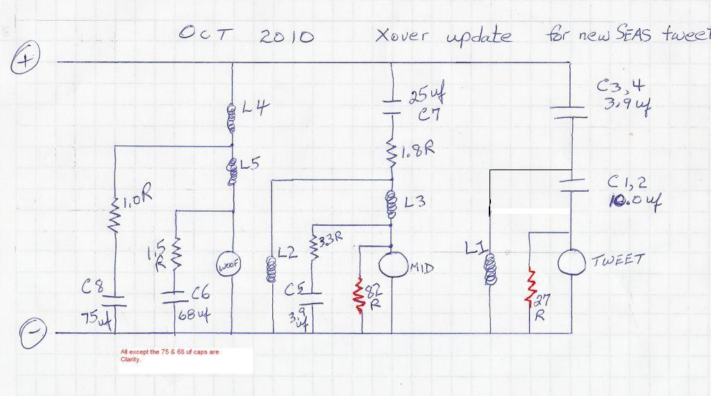

Thanks for the reply. I'm attempting to make a Frankenstein crossover from the original and an updated crossover for the 66 with a Seas tweeter. I have a very limited knowledge of electronics so I could use a little help! From what I read the 44 and 66 are supposed to be very similar in the mid/high, but as far as I can tell they're totally different. Am I right in thinking I can just replace the originals like-for-like in everything but the tweeter path, or does this new design change the crossover point, therefore requiring changes to the mid? I've attached the version I'm looking at, as well as the original. Thanks!

There are a couple of threads on here that dealt extensively with the 44 crossover with the addition of the Seas tweeter, so check those for info.

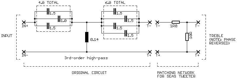

These are two files I saved from previous discussions here regarding the 44. They should clarify what to do with the xover, and how to connect.
Fantastic, this was exactly what I needed! I've been trawling through 50+ page arguments on which capacitor brands sound better looking for this exact information. So by the looks of it, it's exactly the same but with a couple of resistors to adjust for the different impedance?

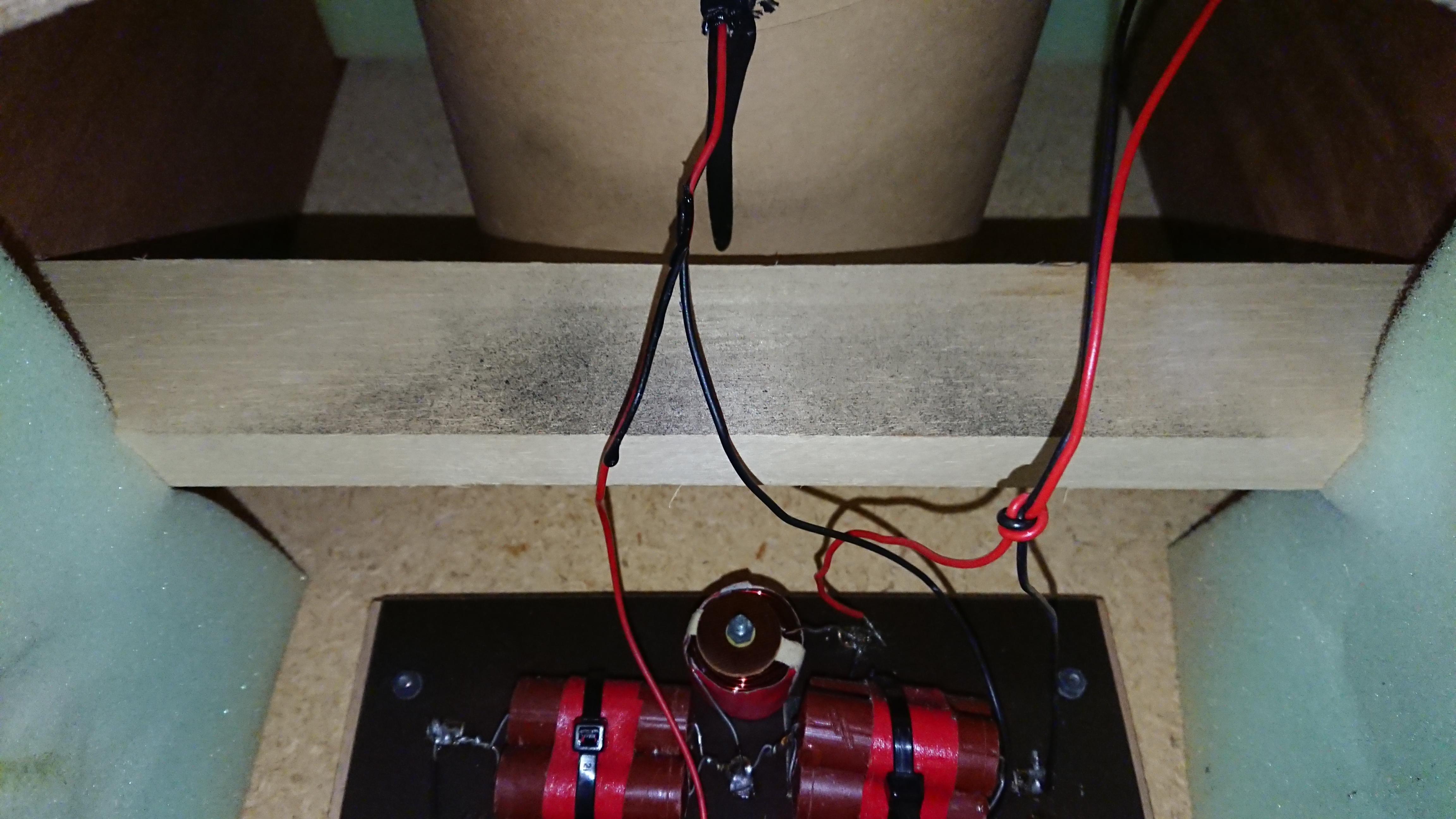

A couple of photos just for fun. For the record, the tweeter wires were swapped at the crossover end so red-positive was correct.
I've always considered "burn-in" a psychoacoustic phenomenon, but after leaving these running for about half an hour they're sounding noticeably more balanced and the low end has definitely loosened up. I'm guessing they've been sat unused for a long time so they just needed to blast out some dust! I'm wondering if the bass drivers would benefit from being rotated, I do that every couple of years with my Leak 3090s to avoid them sagging.
The bracing doesn't look as terrible as I thought, there's a bit of wood bracing the sides, and the front-back is effectively being braced by the mid-range enclosure. I wouldn't describe them as particularly "fast", especially for a sealed box but I don't hate that. My daily listening speakers are PMC TB2s which are extremely quick, the Dittons are now my reggae/blues speakers :-D

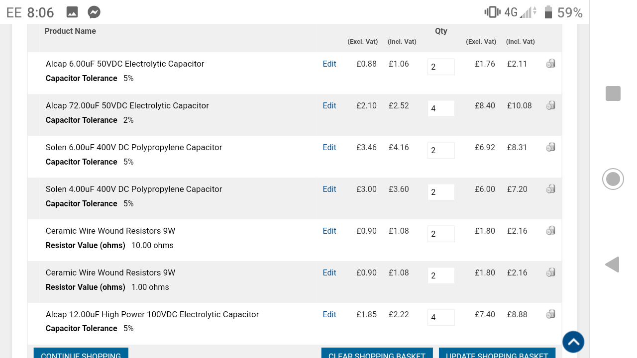

How does this look? I don't want to go crazy with it, just want to replace them with reasonable quality caps. I couldn't find any 24uf so I'm going for two 100v 12uf. I'm guessing I want to avoid the low-loss caps because of the lower ESR?
Use whatever you're comfortable with. I tend to use Solens because I'm not willing to pay crazy prices for 'elite' caps, and being in Canada Solen is easy to order from.

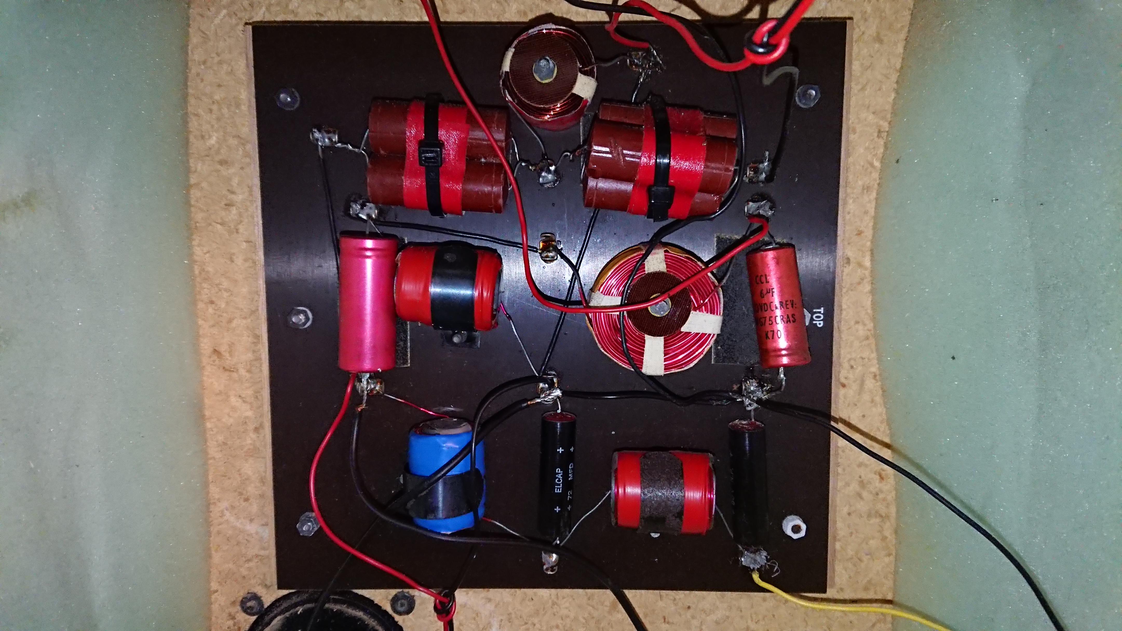

Just a quick update on these. Did a recap and replaced the useless terminals. Someone had really done a number on the soldering in there - none of the components had been replaced, but there was definitely evidence of some repair to wiring. I checked the midrange enclosures and they were well sealed - haven't looked at bracing yet.
They're sounding much more balanced. The tweeters are at the perfect level and left and right are matching much better now, I think maybe the crossover points had drifted somewhere along the way. The imaging still isn't great if I'm honest, there's a real lack of centre image. It could just be a positioning thing, or maybe I'm expecting too much from a 50 year old speaker?
Huge thanks to prairieboy, your schematics and advice were invaluable!
