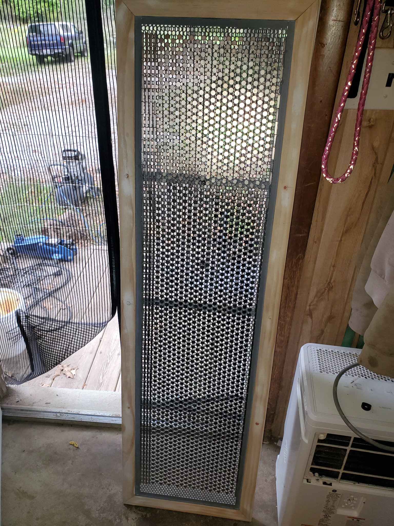

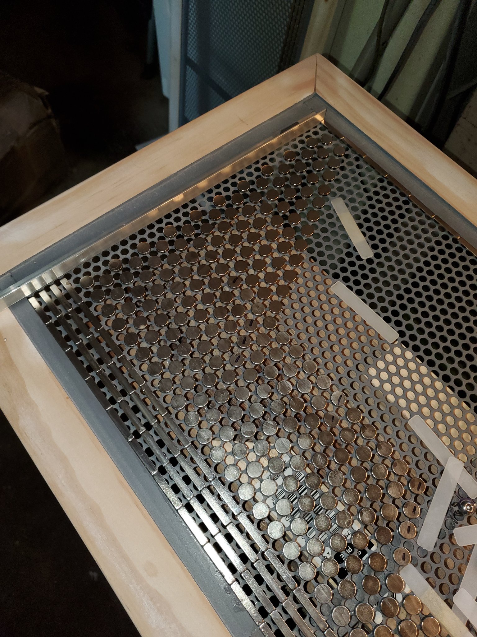

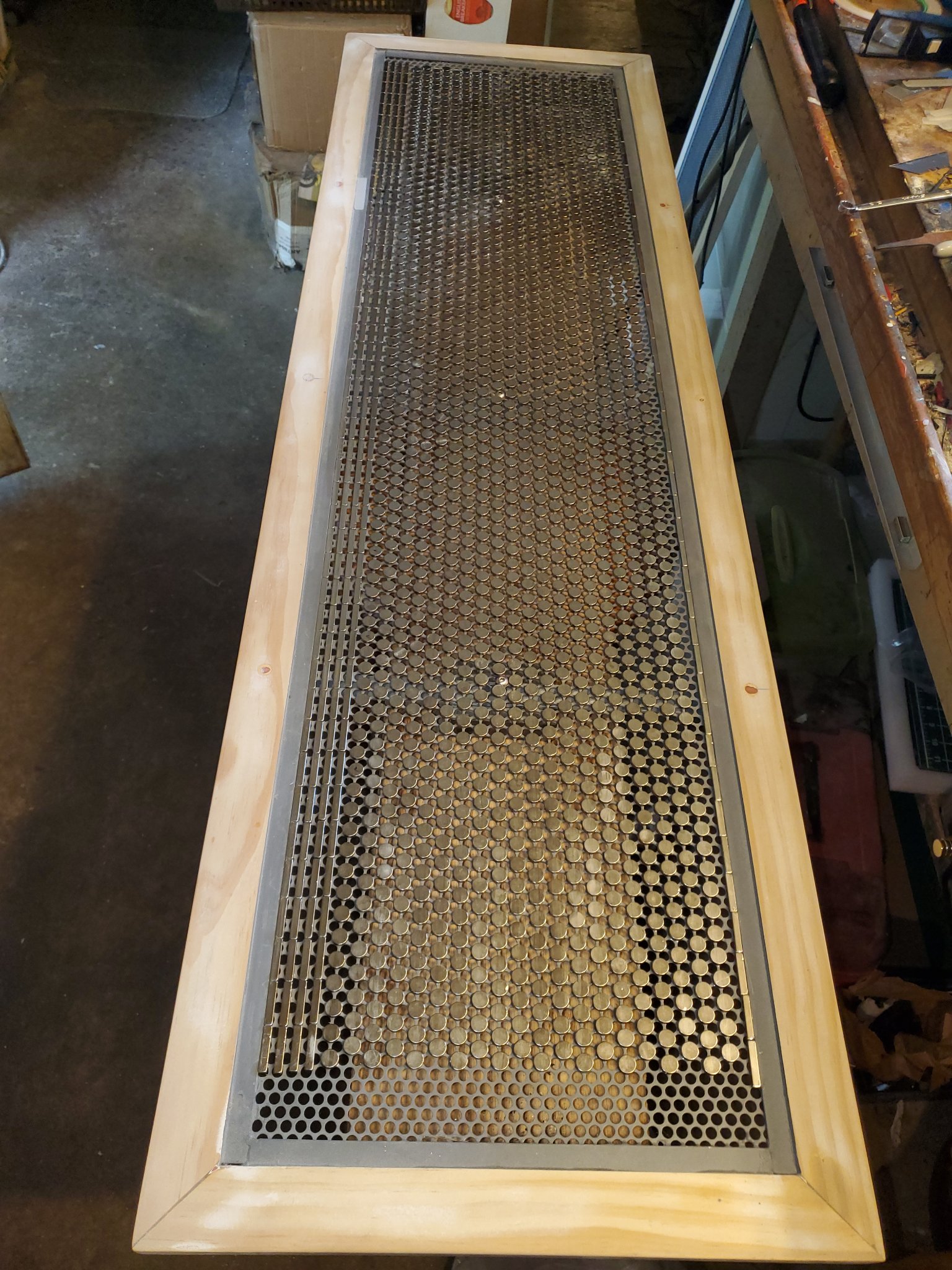

Maybe this was asked already, what type of magnet structure are you running? I have built a set of 12" X 48" panels with full neodymium magnets. And 3mm xmax. I have to roll off my lows, 50hrz. And down. My panels want to make bass.
Jasonkilo
Im using same basic magnet layout as you have to the left side of your panel
could you explain why you are using round magnets for the rest of the panel. I assume that will be the woofer section?
also curious what adhesive you are using to fix the magnets
Sure, cost, and air flow . The small 10mmx3mm disks are much cheaper than the bars, and cover less area. I calculated my panels have 51% open air to the rear. Unfortunately there is also 1000+ per panel. And first I placed each magnet. The a drop of super thin super glue, or CA glue. After that a heavy coat of paint, then wiped the top of the magnets off. Time consuming for sure.
The disks also cause the magnetic feild to zig zag at a 45 degree angle. Which I feel helps with output. Always pulls foil across a hole in the steel backer.
Mind if I ask, how are you stretching your mylar? I'm currently using the pull, and pray, method. Need to come with a system to measure how much stretch is being applied.
thanks
yea the thin glue "wicks" right under the magnets nicely. These types of adhesives are a bit brittle and fragile to bending stress. Ther are so called "toughened" versions but I have not experimented with them and not sure if they come in the thin viscosity
The small planer Im working now isnt too critical of exact tension because its used well out of the main resonance AND its a prototype test bed so to speak so for now the tensioning is done by hand. The panel is curved so its just massage the diaphragm into place with double side sticky tape at edges. Its designed to remove and replace often for test purposes as I alter the panels curve radius
In the past however I have built larger units as woofers similar to what ya have there and the main tune is critical. In that case I use a hand held weigh scale to apply tension to many tapes around diaphragm edges as diaphragm is layed down on flat surface. I just go around entire perimeter of diaphragm tensioning each tape individually. Depending on size of diaphragm and mass of foil , the exact main resonance ya want you have figure out by trial and error. I think I had about 30 tapes round a 12 inch by 30 inch panel each one tensioned to around 5 lbs of pull. Thats a guess, its been years and not certain. This gave around 45 Hz main tune on 1/2 mill film and 1 mill foil
BTW as for the "air movement" through the magnets/ steel screen. On planer woofers you will have a very high resonant rise at main tune and the way to control that is the open area of the magnet/screen structure. Yours will likely be a bit too "open" and the bass rise may be excessive. I usually tune bass diaphragms by actually closing off the openings a bit by gluing felt or thin cloth to back side of magnet / screen structure. Often that rise in bass response will be about 15-20 db at resonance BUT you can damp it down to where ya want ( usually only need about a 10db rise or less ) by closing the open area off a bit. This will tighten up the bass and give considerable control to excessive diaphragm movements as well as tame some of the standing wave activity in the 200 hz region that often is a trouble area for planers
I believe most commercial planer woofers have only about 10-12% open area. If I was to guess yours looks much higher than that. maybe as much as 30%
I'll have to give that a try. I figured I could restrict air movement, but kind of hard to add it. I have tried blocking off sections of the back with tape. But always messed with the frequency response in a way I didn't like. Maybe a thin felt or cloth, to just slow it would be better
