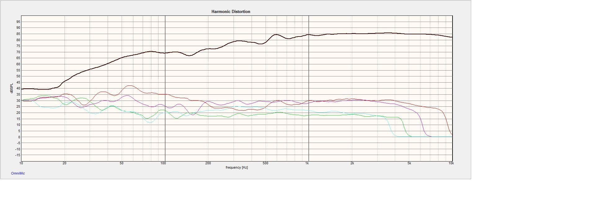

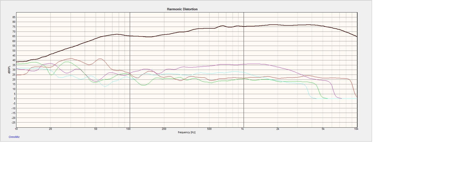

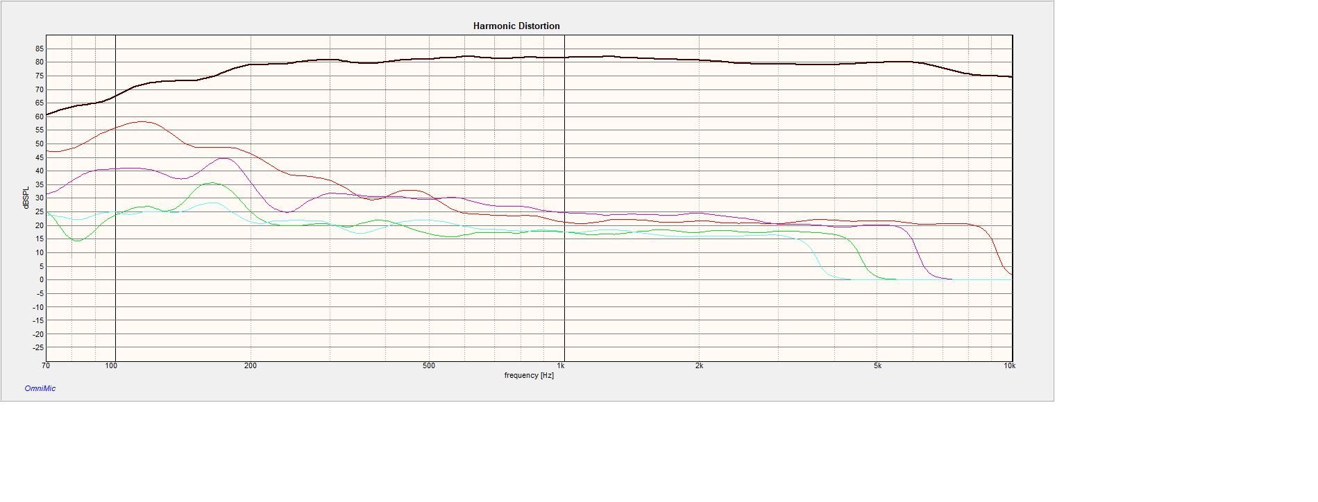

Built some single ended planers recently and noticed in distortion measurements the 3rd harmonic was higher than the 2nd harmonic. Is this typical for single ended magnet planers?? None of the free swinging ribbons I've made do this. Has anyone done a compare of distortion measurements between single sided magnet and push pull arraignments? Note the purple line above all the rest in the attached pic
update...

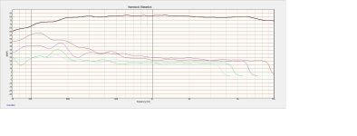

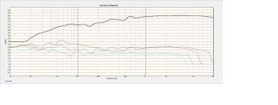

It turned out to be an amplifier issue. At low volumes the 3rd harmonic is elevated but at listening volumes and higher it comes down. See first attached

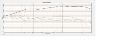

It's also worth noting that what you were trying to measure is nearly impossible in most homes. Once the background noise exceeds the level of distortion you are trying to measure, the data is unreliable.
If you want to measure down to 0.1% distortion, you need to be able to discern something that's 60 dB below the fundamental. You're basically trying to measure 25 dB of noise if your signal is at 85 dB (assuming your system is calibrated and the levels in your graphs are correct). In the original one, you'd need to measure 15 dB. A typical quiet house has about 35 dB of background noise.
The normal fix for this is to set the SPL at 1 meter, then move the microphone closer to the speaker to measure distortion. If you get the level at the microphone at something like 115 dB, you have a better chance of getting useful data (assuming your microphone is still linear there).

usually I do set at around 100db at 1 meter then move the mic close. we actually have a much quieter place here than most
I have no delusions that my cheap setup is to be taken as lab grade. However it has proven quite useful even at lower volume measurements to see gross issues and that's all I was really after.
Ive never measured at quite this low a volume before and looks like what your saying has shown itself true. I thought it may have been an amp issue.
A while back I had a similar distortion reading with highish 3rd harmonic and it was actually a bad connection to the foil on a ribbon. Strange to me. Not sure how to understand that one?

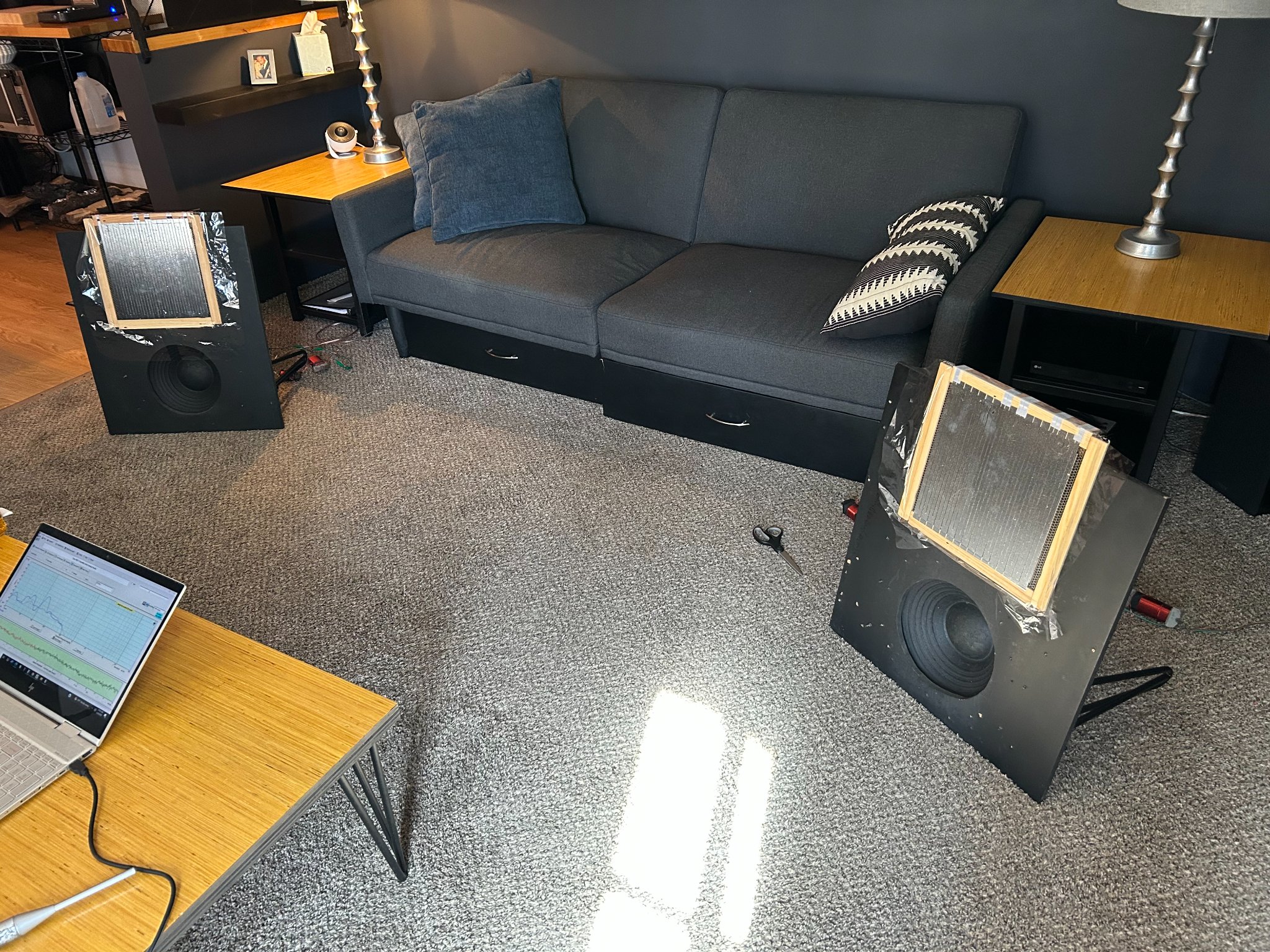

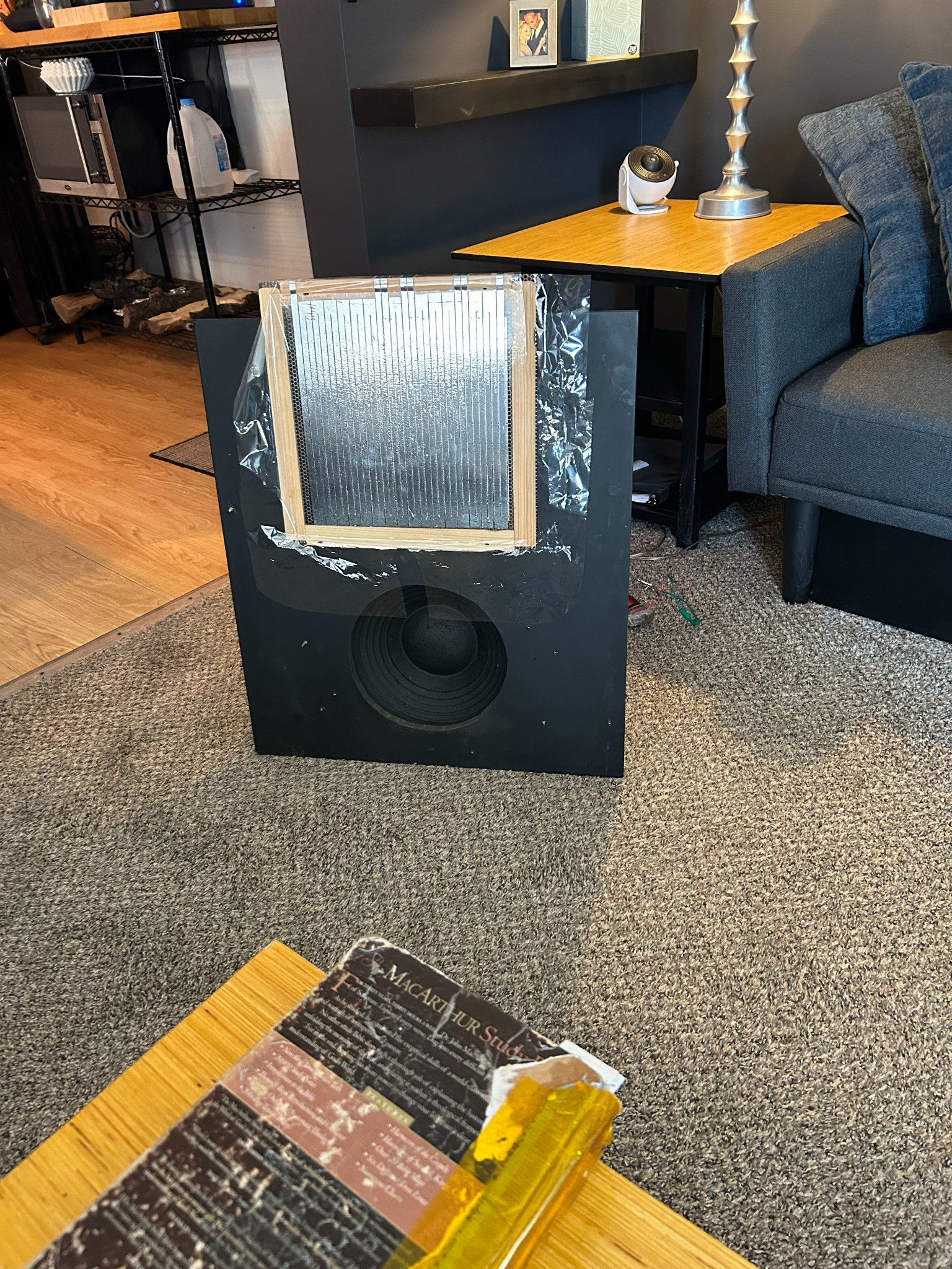

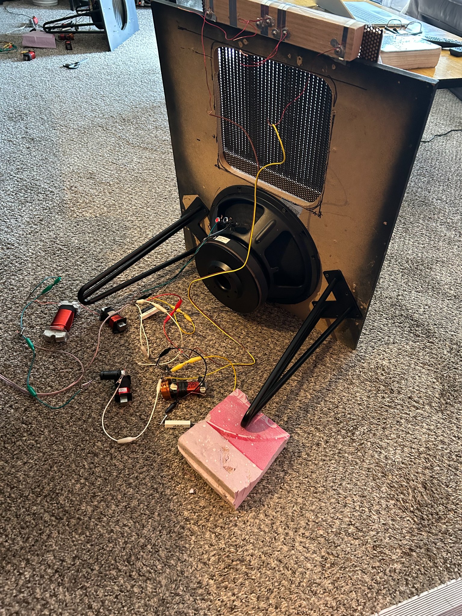

some pics of the protos in all their ugly glory. Big planer is a small listening window BUT the imaging is rock solid with the limited dispersion, the cross to the woofer at 300 hz is a solid improvement over the typical 500 hz crossover (woofer cleaner down there). Woofer is a pro type 96db PE woofer. Quite good below about 350 hz.
Narrow dispersion was intentional in most of Roger Sanders' electrostatics. For some, the head-in-a-vise sweet spot is a reasonable trade for holographic imaging.
yea I really dont like the narrow sweet spot BUT as you say its tempting for its image for sure. The planer traces are tapped so can configure as concentric mid/tweet eventually.
BTW I was surprised this setup likes 6db crossover. With 12db/oct the image collapses into speaker once in a while and low volume listening sounds a bit veiled. At 6 db both issue are gone and overall sound is just better. Never had a speaker where 6db worked well before

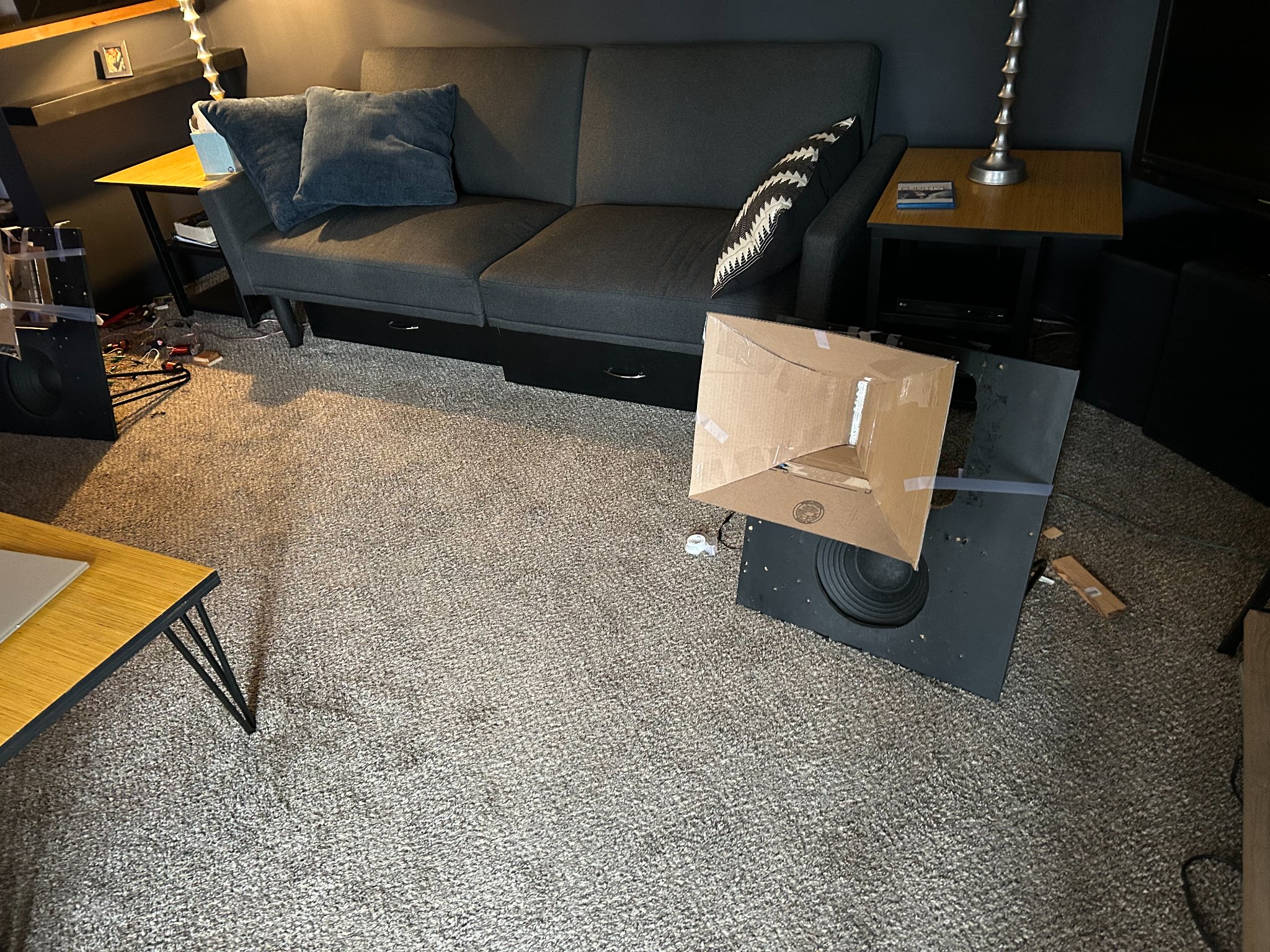

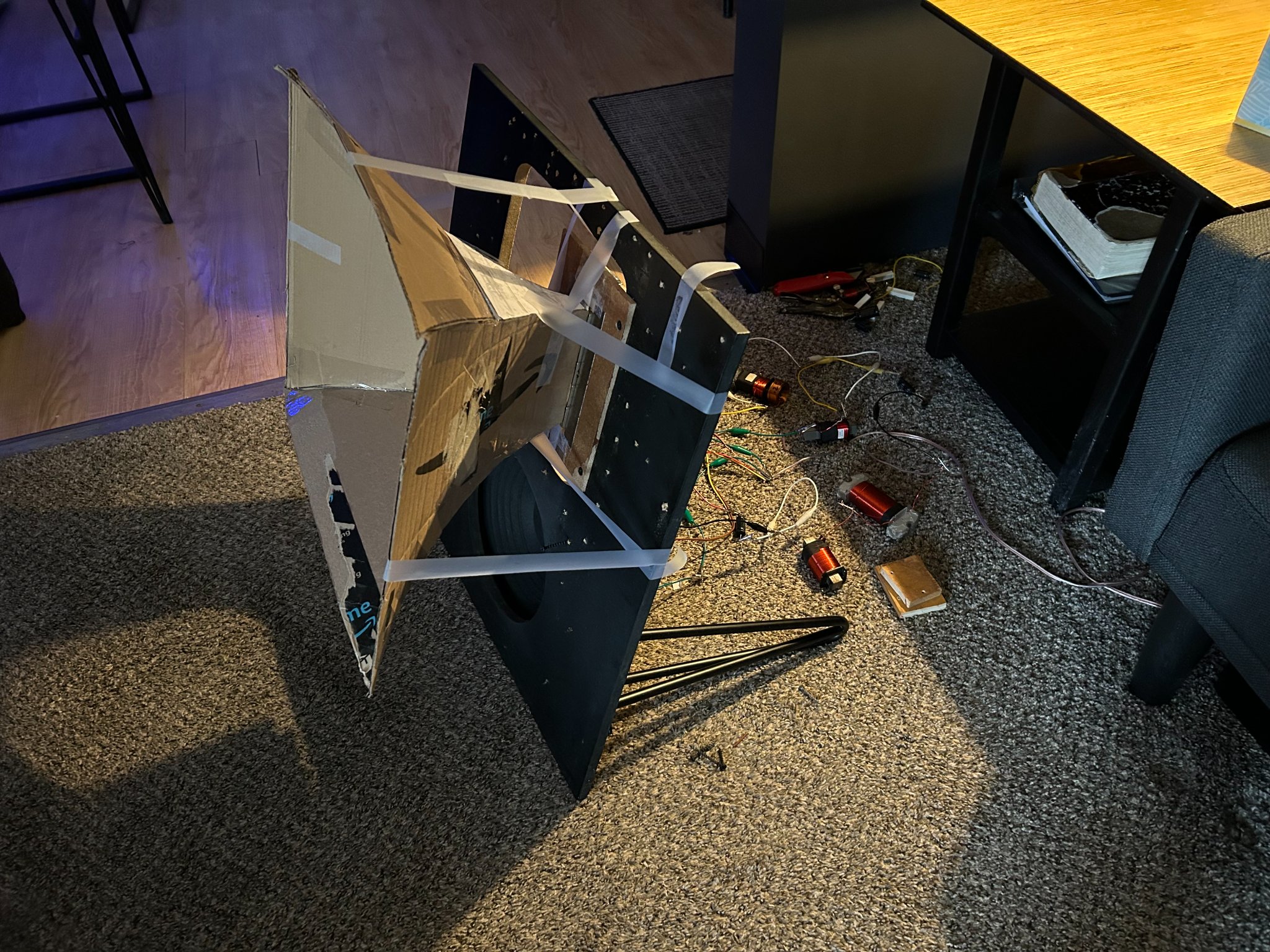

heres a laugh for yall
a 6 inch by 15mm free swing ribbon in a hacked together cardboard horn. good to about 650 hz. 105 db peaks from that little ribbon and keeps up with the 96db pro woofer. Solid as a rock imaging without head in a vise
BUT still the big flat beamy planer beats it for emotional impact

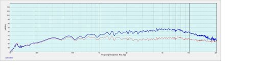

ive noticed quite surprising differences in realism between larger woofers crossed at 350hz vs 500hz. Seems to me that even very linear and expensive pulp or mix woofers, although smooth and flat through to 2 khz, are simply not up to the panels sonics. They measure quite low in distortion plots BUT sure dont sound undistorted to me!
Every one of these types show some deviation in off axis response starting at about 450 hz. So I suspect that where the cone starts to get wonky in flex we are hearing the material properties??
From here it seems to me any well damped materials signature sound is coming into the mix and damped materials have there own color that does not match well with planers stats and ribbons?
Most larger cones, even the cheap ones, seem acceptable below about 300-350. Sooo I went on a tirade to test this by making a planer that could get to 300 with some authority and then do a compare between two scenarios
