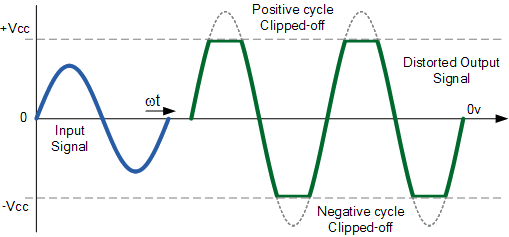

As JS wrote the clipping of an amplifier is the "result" of a too low voltage of the power supply. the power chip in your amp is responsible for the max Voltage and current what it can deliver. so going up with the voltage is just limited in the datasheet .written in the datasheet for different impedance of speakers/load. e.g. +/-25V with 8 ohm load but +/-22V with 4 ohm load /speakers. because of the chips max heat dissipation and current protection.
the gain of an amplifier is the difference between input signal/voltage to output signal/voltage. so if your output voltage hits the maximum voltage of your power supply voltage you amp starts to clipping - soft clipping/distortion. if the output is much higher the sine wave is cutted hard -hard clipping ...huge distortion...please look at the pic i attached.
with a scope you can see the output signal is clean or starts to be distorted.
