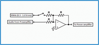

Is this the test you propose? (see attachment)
1) With switch open, adjust the output of the preamplifier to a low level that produces audible distortion in the ESL.
2) Close switch to add/mix in a high amplitude ultrasonic signal with the audio going to the power amp.
3) As the amplitude of the ultrasonic signal is increased, the amount of core distortion should decrease resulting in less audio distortion heard in the ESL.

Conceptually, that's it. There are a number of ways of practically implementing it.

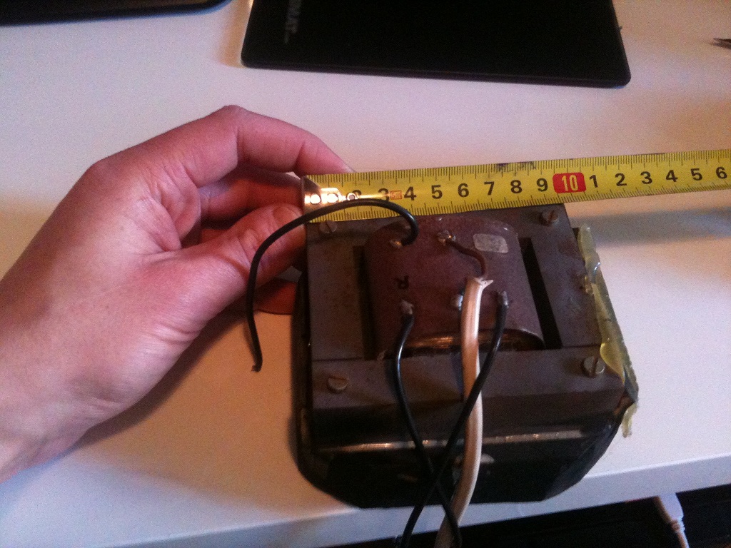

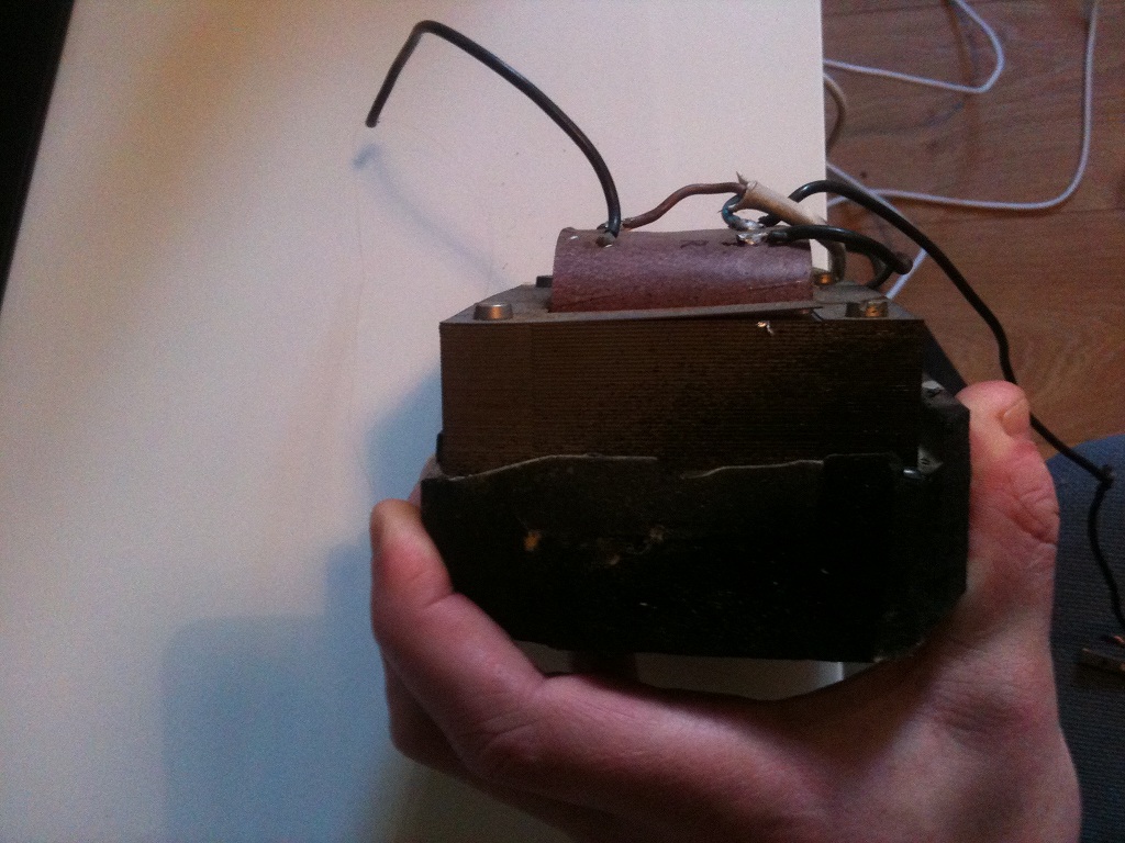

ok so here are 2 pictures of the tranformers. as requested..
the core measures 9.5 cm x 8 and is aprox 2.5 cm thick laminated from 0.5 mm laminates.
they look a bit weird because there cast in some sort of resin wich i cant remove. the baffle of the type of speakers there from was made of this resin so they just did the tranformer in when casting whas not dry yet or even while casting.

That's obviously cheap, power transformer grade metal, no surprise it causes distortion. It can create illusion when driven from a low impedance source, but when the value of the magnetizing inductance influences the output voltage, it shows its true colorsok so here are 2 pictures of the tranformers. as requested..

Looks to by E96 size laminations which is the same size used by Audiostatic in their ES-100.
As far as the quality of the iron used, that is hard to say from a picture but it does not look at all like the light grey I am used to seeing on quality audio transformer cores. Also, it looks like there is no insulating wax or varnish between the lamination layers. Is that correct? That would certainly result in increased core losses.
What do you mean?
2 cm thick, i mean stacked.. what should one laminate look like ? for an audio tranformer
The stack height of laminations(2cm) determines the core area, which in part defines how much voltage you can apply at a given frequency before saturating the magnetic material the core is made from. However, the material that the core is made from will define how linear the magnetization curve is, independent of the stack height.
I believe what Elvee was saying was that lamination of 0.5mm thickness are usually only found in power transformers which would mean lower quality, less linear magnetic properties. Laminations made for audio use tend to be thinner than that. The thickest "audio grade" laminations I have seen were about 0.3mm.
