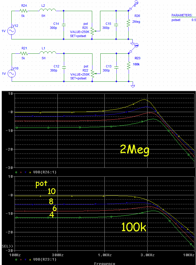

So, I connected the guitar to a preamplifier which has a huge input impedance ( TL072, JFET inputs connected as a buffer ). I wanted to compare whether there is any audible difference between the guitar directly to the distortion and then to the amplifier and the buffered guitar by the preamplifier and then to the distortion and then to the amplifier.
I am unable to make the difference out because the preamplifier can only go to a gain of 2 and not 1. So, I have to compare whether something, amplified by 2 is the same as another thing, not multiplied by 2. As you can realise, this is difficult.

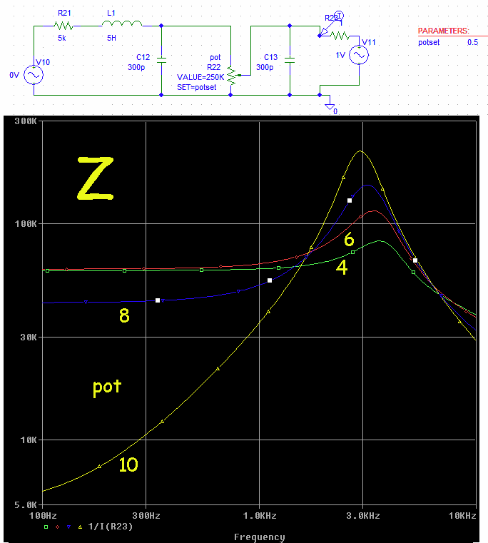

The idea of this experiment is to find the signal loss caused by the high output impedance of the guitar and low ( ~ 100K ) input impedance of the distortion. I would be able to do so somewhat more easily provided I had a preamplifier with a gain of 1 to be used as a buffer.
I have also played the guitar connected to the preamplifier adjusted to have a gain of 3 ( would hopefully not go to saturation at this low gain ) and the preamplifier connected to the distortion and the distortion connected to the amplifier. The sound is marvelous and, the noise level is lower because of the low output impedance of the preamplifier. I can still hear the power supply noise which I hope I can decrease by a power supply which I am in a process of physically making.
