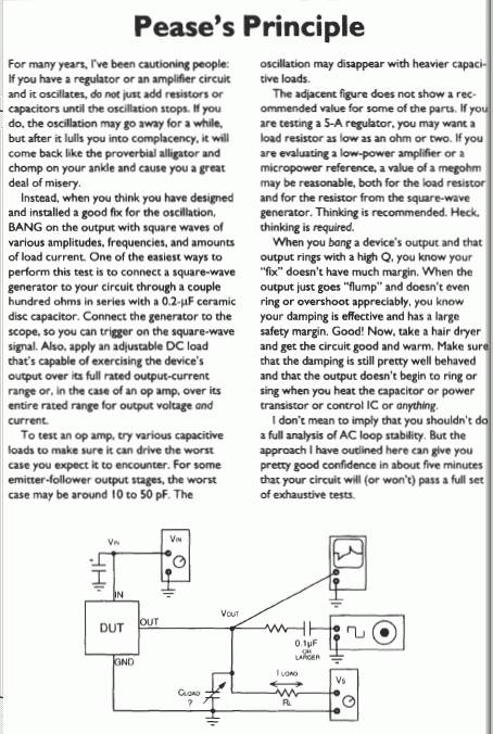

Yes, Mr. Pass, I know only few people mentioned this technique. First is yourself, and the second is Bob Pease from National.You may recall your feedback experiment as one of my "chip amp"
techniques in which the input networks are used so as to throw
away some open loop gain.
In his book (Troubleshooting Analog Circuit), and paper LB-42 http://www.national.com/ms/LB/LB-42.pdf he mention this technique.

Mr. Pass, do you mean the change in sound is not due to ammount of feedback applied, but because of the amp itself near oscillating in follower mode?
This is difficult for us DIYer's. Every opamp I tried is stated as "Unity Gain Stable". I remember you have experience with OPA604 in unity gain too.
