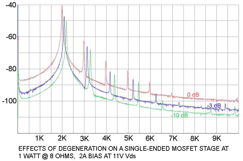

Nelson Pass said:Flattery will get you anywhere. Sorry we didn't find the time
to yak at BAF, twice now.
Likewise (once for me), may be next year. I can't read this now but I'll look at it tonight. Have you ever seen Jerry Sussman and Jim Boyk's paper on distortion? It was only published on line I think. They cover this stuff from a heavily analytical angle.
scott wurcer said:Likewise (once for me), may be next year. I can't read this now but I'll look at it tonight. Have you ever seen Jerry Sussman and Jim Boyk's paper on distortion? It was only published on line I think. They cover this stuff from a heavily analytical angle.
I have, but I only recall the parts which covered some of the same ground
as Baxandall, Cheever, et al. Yes, it's all academic.
Me, I read the National Enquirer and I watch Chelsea Lately on E!.
And that's how I write.
janneman said:
Thanks Jan. I was remembering the wrong paper.
I do have an issue with their conclusions about degeneration in Fets, as my
own measurements with both Jfets and Mosfets do not show this behavior
with degeneration. I did not see enough information on the simulation they
did to decide if there is some other factor. I do think it's important to separate
out the effects due to Vgs/Ids versus Vds/Ids.
