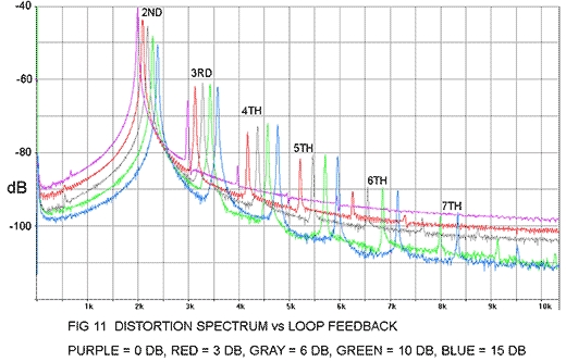

Simulations I
To verify this theory, Mr. Pass designed a Single Ended, MosFet amplifier,
connected to an 8 ohm load, biased at 2Adc, with an 11 Vdc across the gain device.
Mr Pass also used variable "degenerative" feedback - most probably a resistor inserted in the
Source circuit of the gain device.
Roughly, the ratio of this resistor to the output impedance defines the feedback loop gain of the gain block.
The measurement results are presented in fig 11 graph from the Pass Labs paper.
Alexiss said:
Feedback, when localized, and specially in such simple and linear circuits used, should not give rise
to higher order harmonics components in an FFT graph, regardless of the amount applied.
I am unclear whether this is your statement or his. I am unclear whether you agree with it or state it in order to dispute it. However, it is false. Feedback applied in whatever way to any nonlinear circuit will give rise to some re-entrant higher order distortion. This distortion, like almost all distortion, will then be reduced by the feedback and in most cases will be too small to be of any significance especially when compared with higher order distortion already produced by the active devices.
Simulations I - continues
As clearly visible in fig 11 of Pass Labs document, the 15 dB feedback applied to the gain block, increases the amplitude of
ALL harmonics components above the 2nd.
Pass Labs claims "negative feedback can reduce the total quantity of distortion, but it adds new components on its own".
This simply appears not to be the case.

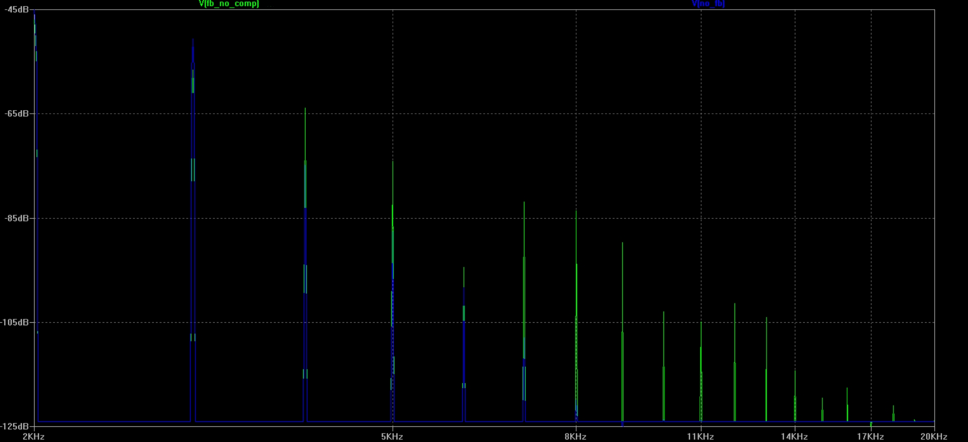

In order to find out more, a series of very simple simulations were performed.
A single ended, MosFet amplifier using IRFP240 transistor model, with a load of 8 ohms, biased at 2 Adc and Vds = 11 Vdc was used.
Running 1W into an 8 ohms load, two simulations were performed:
1- BLUE trace: no feedback applied
2- GREEN trace: 15 dB of negative, degenerative feedback applied.
Simulations I - results
As clearly depicted in the picture above, the application of 15 dB negative, degenerative
feedback, results in higher amplitude on virtually all harmonics components except for the 2nd.
This seems to agree with the proposition in the Pass Labs paper - that application of feedback
adds new components on its own.

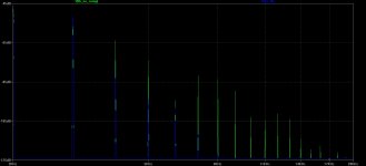

This is well known and was described and reasoned in many papers, starting with Baxandall. The problem is too low feedback you use (15dB). Feedback makes sense and improvements when used in much higher amounts, like 60 - 100dB for the lower frequencies and at least 40dB at 20kHz (proper frequency compensation to be used). Please try to repeat your calculations with much higher feedback factor and you will see that the newly created frequency components will have negligible amplitude well below threshold of hearing. It is an utter nonsense to use only 15dB feedback.
Yes. As I think I said earlier in this thread: for feedback use none, or enough. A little feedback may be enough to create re-entrant distortion but not enough to suppress it. Small amounts of feedback should only be used in situations where distortion is already low so feedback is being used for some other purpose such as setting output impedance or widening bandwidth. Everywhere else, use none or lots.
