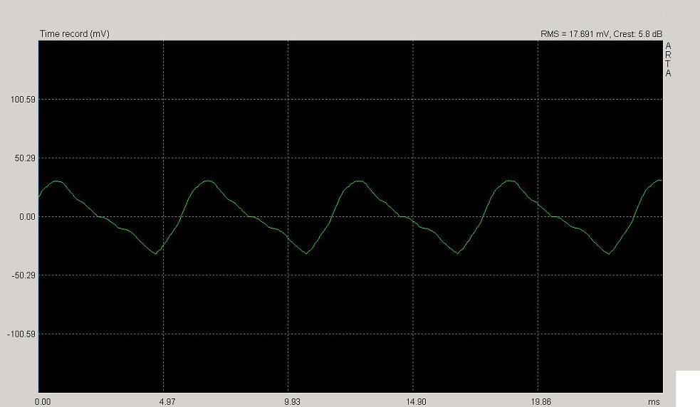

Here is a clip of me singing a note at about 160Hz (that would be E3).

I have my weak moments when I loose self control and all of a sudden sounds comes out of my mouth. Normally though I restrict myself to instruments and let one of my friends who are a trained singer do the vocal job!! 🙂
I DO care about the people around me. *lol*
