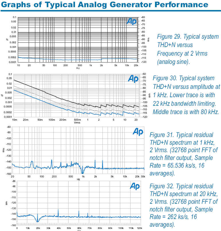

i just opened on another section of this forum a similar post...and then.... i found this thread 🙂
Anyways, i downloaded the brochure of the analyzer mentiond on the post above.
http://www.rohde-schwarz.com/www/DownCent.nsf/file/UPV_bro_en.pdf/$file/UPV_bro_en.pdf
it looks very interesting....is it the same of what you are talking about on your post?
If so, how much it costs? do you have an evaluate version dr you bought the complete interface?
