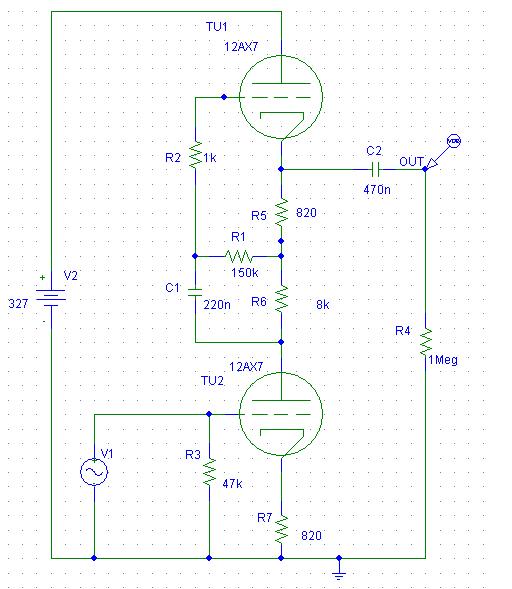

I would like to open the discussion about a surprising subject I discovered during some distortion analysis with PSpice.
The initial intention was to investigate the behaviour of the intermediate resistor during distortion analysis. At first, we have a mu follower circuit with 12ax7 and a coupling capacitor at the lower stage. (see attached file).

There is nothing surprising with the distortion of the u-Follower into different loads. John Broskie has described it on his page
www.tubecad.com. Look at the SRPP articles.

Although that circuit is technically a mu-follower, there's hardly any resistance for the upper valve to bootstrap, so the lower valve will see a load of only a couple of hundred k. To gain the advantage of mu-follower action that 2k resistor really ought to be more like 22k or 47k so that the lower valve sees a load resistance much larger than its anode resistance.

Docali, you really should try substantially increasing R5 (and the HT voltage to suit). As a rule of thumb, R5 should drop about 100V.

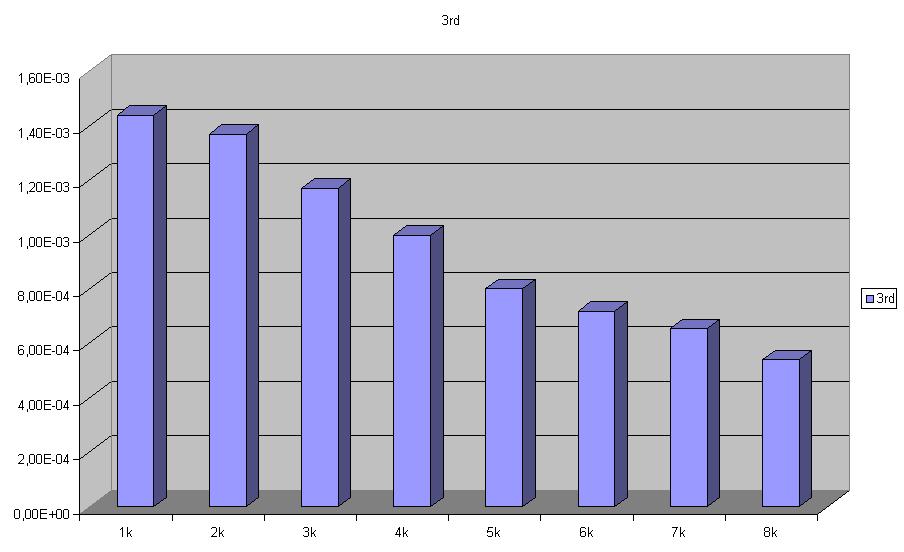

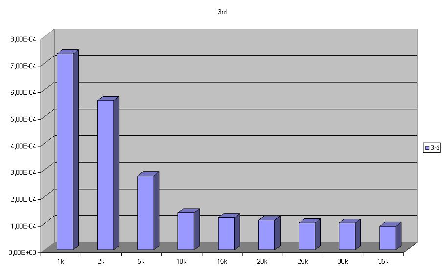

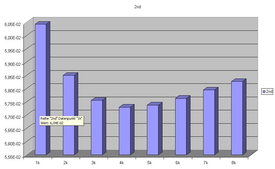

Ok, some variations for the mu follower without coupling capacitor:
First, I lowered the load resistor R4 to 100k as proposed and I tried larger intermediate resistor R6. It should be mentioned that for every load resistor the voltage was atjusted to give nearly the same current and the only difference is the voltage to be dropped across the intermediate resistor. This procedure was also used for all previous investigations.
But the result is the same. The second order distortion undergoes a minimum.
What could we learn from this? The mu follower with coupling capacitor with respect to distortion should have an intermediate resistor as large as possible but if we remove the coupling capacitor of the lower stage things change and we have an optimal area of intermediate resistors with respect to second order distortion.
