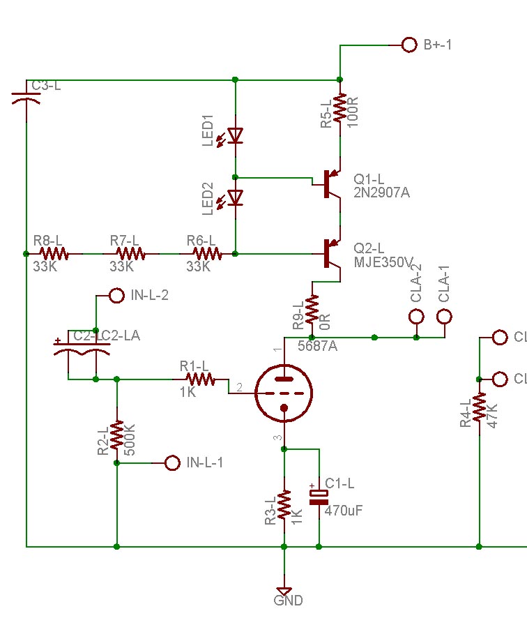

I am working on a 5687 based gain stage for a dac. The dac is based on the tda1541a, uses a 33r resistor for the I/V, and is working fine. The tube circuit, however, is distorting quite a bit and gets worse with bass or loud notes.
Schematic is attached -- there is a 4.7uF output cap attached between CLA1 and the output. The plate load CCS is at 10mA, cathode is biased up about 10V, B+ measures about 230V.
Does anyone have suggestions on where to look for what the problem might be?

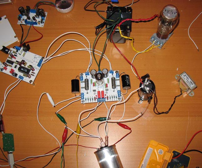

A little more information. It seems that there is only a tiny bit of distortion when the amp first is turned on, but the longer it is on, the more distortion there is. The CCS transistors don't seem to be very hot and nothing appears odd -- i.e., there is no smoke.
I measured the current draw and it is pretty stable at 12mA -- slightly higher than I had intenbded, but not too bad either. The voltage is also stable, and otherwise things seem pretty quiet.

What is the plate voltage?
Looking at the Tung-Sol 5687 datasheet characteristic curves, Vp=240V for Ip=12mA and Vgk=-12V. The active load may not have enough voltage across it, 10 to 20V drop should be OK. Perhaps a greater B+ or reducing the value of R3 would help.

I think you are looking for a cathode resistor in the range of 301 - 560 ohms. I run 5687 with these resistor values on 100V - 200V supplies.
I think if you look at the curves for the 5687 you are probably operating on the verge of cutoff for the plate voltage chosen. Bias like 3V or so would seem closer to the mark.
It's also possible that you don't have enough voltage across the CCS, but the CCS will fix the operating current, varying the cathode resistor will move you further up or down the curve for that plate current level. reduce your cathode resistance and the plate voltage will drop and therefore the voltage across the CCS will increase. This IMHO is why I don't like the CCS implementation, the operating point is now a complex interplay of tube and ccs behavior, linearity notwithstanding.

B+ is high -- like 230V -- so I am actually dropping qiute a lot. Well, I think I am dropping quite a lot. Judging from the temperature of the transistors, I must not be dropping much at all. Maybe I;ll reduce one of the PS resistors to raise the voltage a few voltas and see what happens.
I initially intended to use a 560R resistor, but accidentally ordered the wrong one and it does not fit the board. I'll see if I can't fix that somehow.
Thanks for the suggestions.

Well, I looked over the datasheet again, and I really just botched the math. It seems to have been a combination of the two problems. So, I used a 430R resistor for the cathode (the only reasonable thing I had around) and lowered B+ to about 200V and it seems to work quite well now. In fact, it sounds really spectacular -- I couldn't be more pleased.
