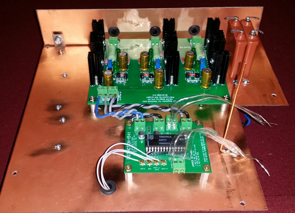

Another Distinction springs to life

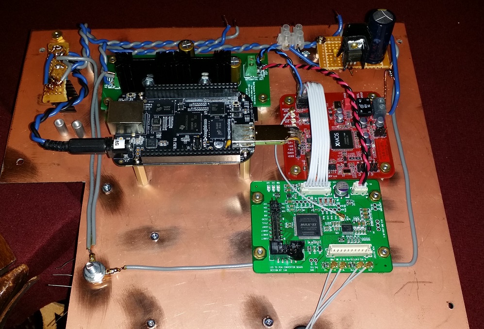

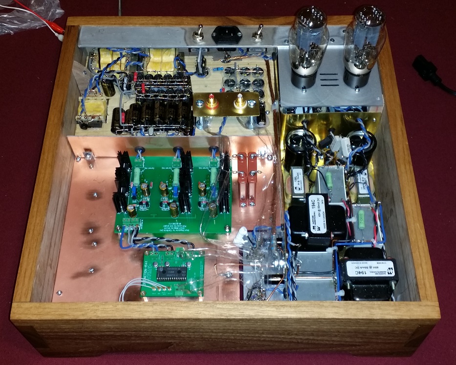

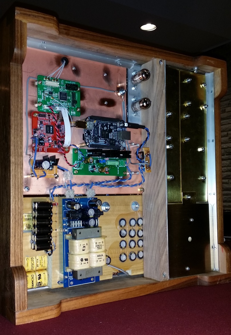

Big milestone today. I fired up the new music server for the first time. All is working great.
BBB -> WaveIO (isolated I2S) -> Ian I2S 2 PCM (simultaneous mode) -> Distinction
It is in my basement listening room burning in. I will post my impressions of sound after a week of running in. Initial impression hints at greatness. With tons of new caps, (including Blackgates) it has that usual tightly wired sound with very little base or air. I know at 10 hrs that will all start to wash away and at 100 it will be time to comment. Clearly it has a lot more micro detail than the WaveIO to 1541A DAC it replaces.

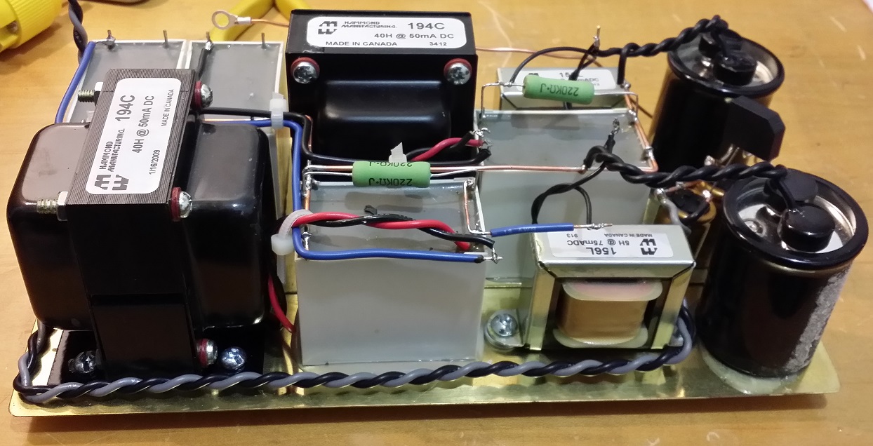

Also very happy with the tube output stage. The old one had a lot of hum and noise. This one is dead quiet. My amps will now be able to show what they are really capable of with a lower sound floor.
Stay tuned for first impressions. A couple of pics with the finished version from the top side and the lower side. I kept the digital on the bottom and the power supplies are all isolated with their own copper or brass sections.

All I can say is that the combination of new items are trending to great. Positive changes likely from:So the Ian's I2StoPCM is a huge improvement.
-First and foremost the Distinction board and its choices. It uses film decoupling caps vs my former polymer, free running DEM with 6k8 resistors vs Grundig, much better lay out, ground plane etc
-Ian's I2S with simultaneous mode
-The S2 double crown likely puts a little icing on the cake
-much better tube section with all film caps, dual mono, tube rectifiers etc
-separate power supplies with tons of filtering, salas shunts and lots of filtering (although the prototype was not a slouch in this area)
-I think the physical layout is important. I believe in both electrical and mechanical isolation, and vibration dampening. This is attached via AVC to 110W OTL monoblocks. On one channel with ear to tweeter, I cannot tell the system is powered up. On the other a small hiss and minute hum only audible at 2". I'll see if I can track that down over time.
I am using current RuneAudio B2. (look forward to B4). It is MPD based. I expect at some point to go direct BBB to Ian once I have a reclocker/isolator. I have ordered Acko S03 board, and watching TP. Mean time I will use WaveIO happily as it is very good, especially when SPIDF is removedTell me more please about your BBB :

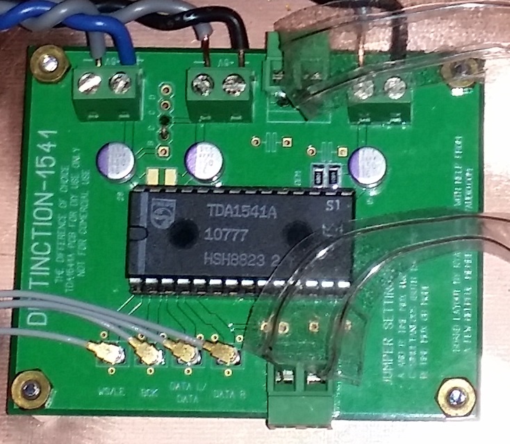

hand holding please
I started to populate the boards and need some help.
1) Can someone post a picture of the completed board ?
2 ) Help me understand the parts to populate in the areas high lighted in red in the picture attached ?
3) Any simple op amp based IV for me to test the board after populating ?

kp93300,
See pic of how I did mine. The jumpers in the area you highlight are basically there to allow you to pick in the future if you want the 1541a wired to run from an I2S signal, or from PCM. I use IAN's I2S to PCM card therefore if you look at the 1541a data sheet, (refer to Table 1) I need -5v to pin 27, so you tie pin 26 to 27 giving the -5v selection. When I ran direct from a WaveIO board, I would have wired it for +5v so tie pin 27 to pin 28.
In most cases 27 will need to be +5v. Most designers just short 27 and 28. the Distinction board is really elegant here. Ideally you should put a row of pins in your area highlighted in red so you can put a jumper making it flexible to start with a USB to I2S converter such as WaveIO and later add in Ian's I2S to PCM board and compare the effect for yourself.
I hope this helps.
I hope this helps.
